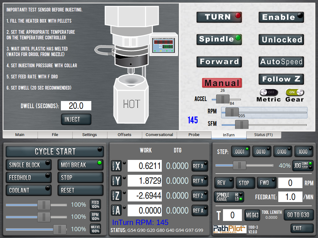

Hello Group!
I am starting to port my 4th axis motor controller to PP 2.x and as soon as I 'opened the hood' it became obvious that it is very different from 1.9.13
Right off the bat I cannot get Modbus to work. As normal, mb2hal does not seem to be included with PP 2.x and the LinuxCNC version that works fine with PP 1.9.13 throws a code sharing error on PP2.x
I can be more specific but first I thought I would see if anyone has already done this. Most of 'operator_login' has been replaced by a python program. Not sure if that is good of bad, but it made me wonder about the feasibility of using pymodbus or something similar instead of the LinuxCNC mb2hal utility.

- Simpson36
- Posts: 59
10 Sep 2018 11:41 #117298
by Simpson36
Replied by Simpson36 on topic Modbus for Path Pilot 2.x
Yes, what I did was compile LinuxCNC using the OS that is included with the Path Pilot 2.0.0 distribution.
Then just copy the Modbus stuff over to PP.
The rest of the port was happily just cut-and-paste. Tormach made the standard slider bigger (screen shot attached). Release notes say this is targeted at touch screens, which makes sense. The larger size makes them a bit crowded where used in my application, but I will likely leave them as-is for now.
The old unsupported OS used on pre-2.x was a major roadblock to doing interesting stuff with PP.
