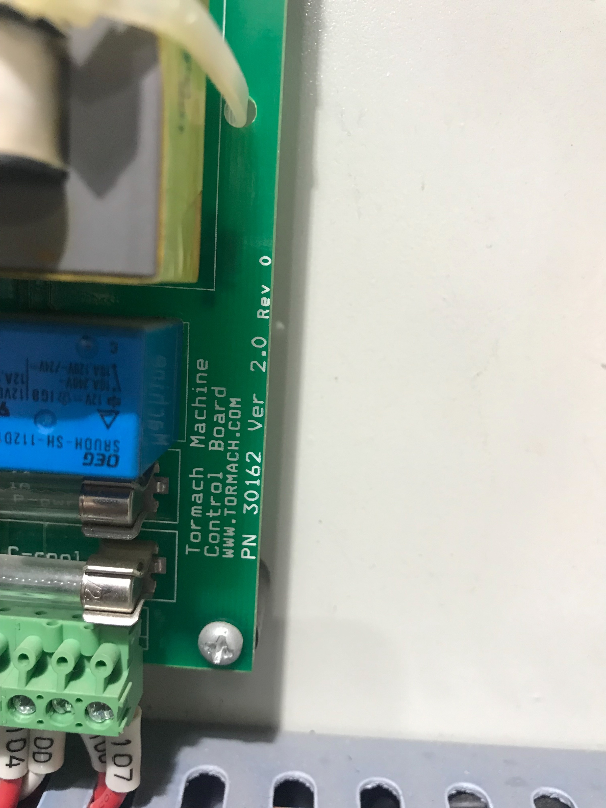

18 Sep 2019 18:18 #145534
by belli
Replied by belli on topic Upgrade to PP 2.xx on Tormach 1100 series 1 from Mach 3
I don't think PP was ever designed for parallel port. It started with the 5i25/6i25, hardware step generation is always better...
To set up PP for parallel port is a lot of work and for the cost of a 5i25/6i25/7i92 I just don't think it is worth it. The BOB hasn't really changed in all this time, I have checked the circuit diagrams and the changes are fairly small. The earliest I have is 30162 Rev5 which was basically their first BOB but I don't have the circuit diags for it. Before my time...

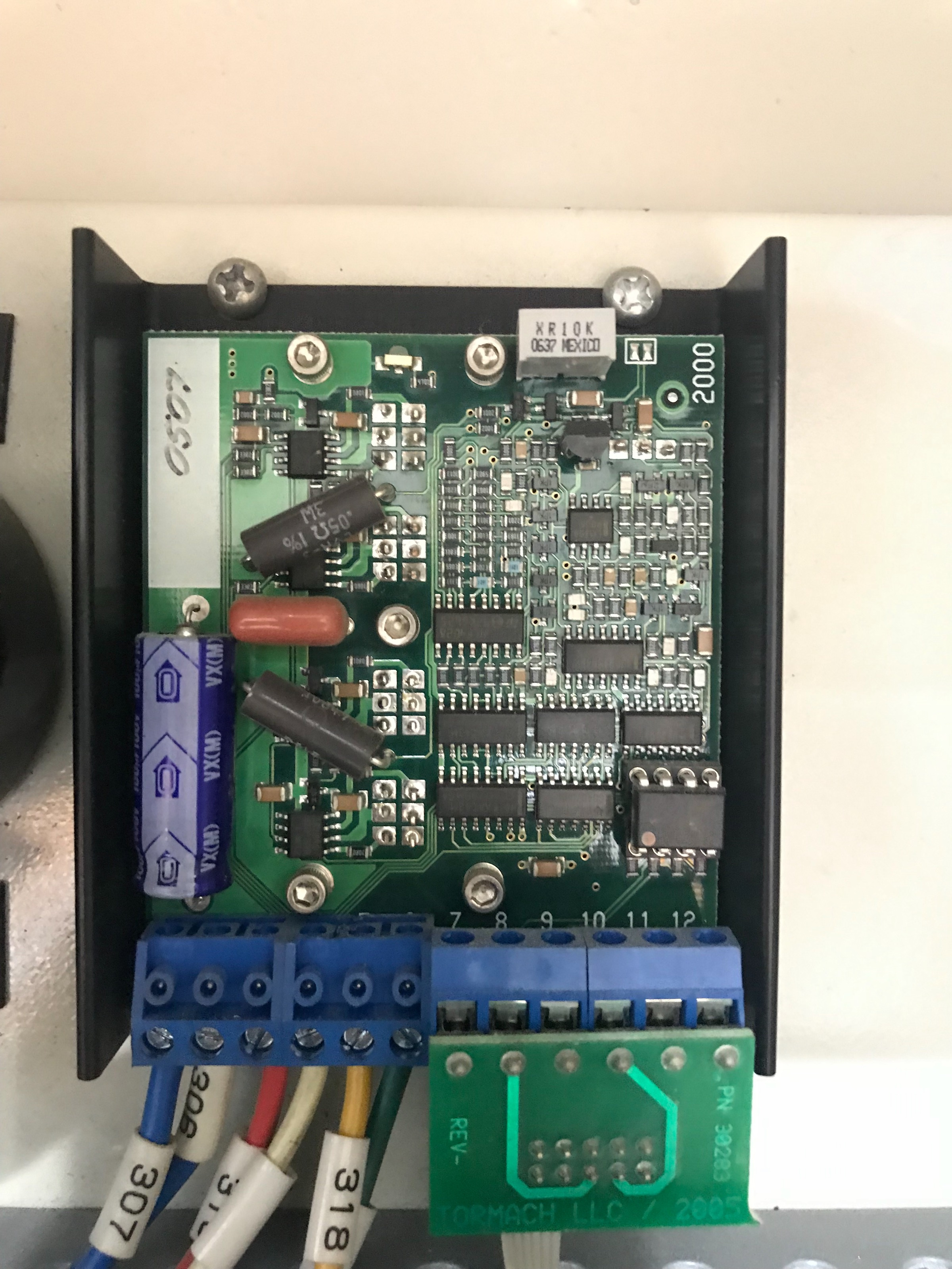

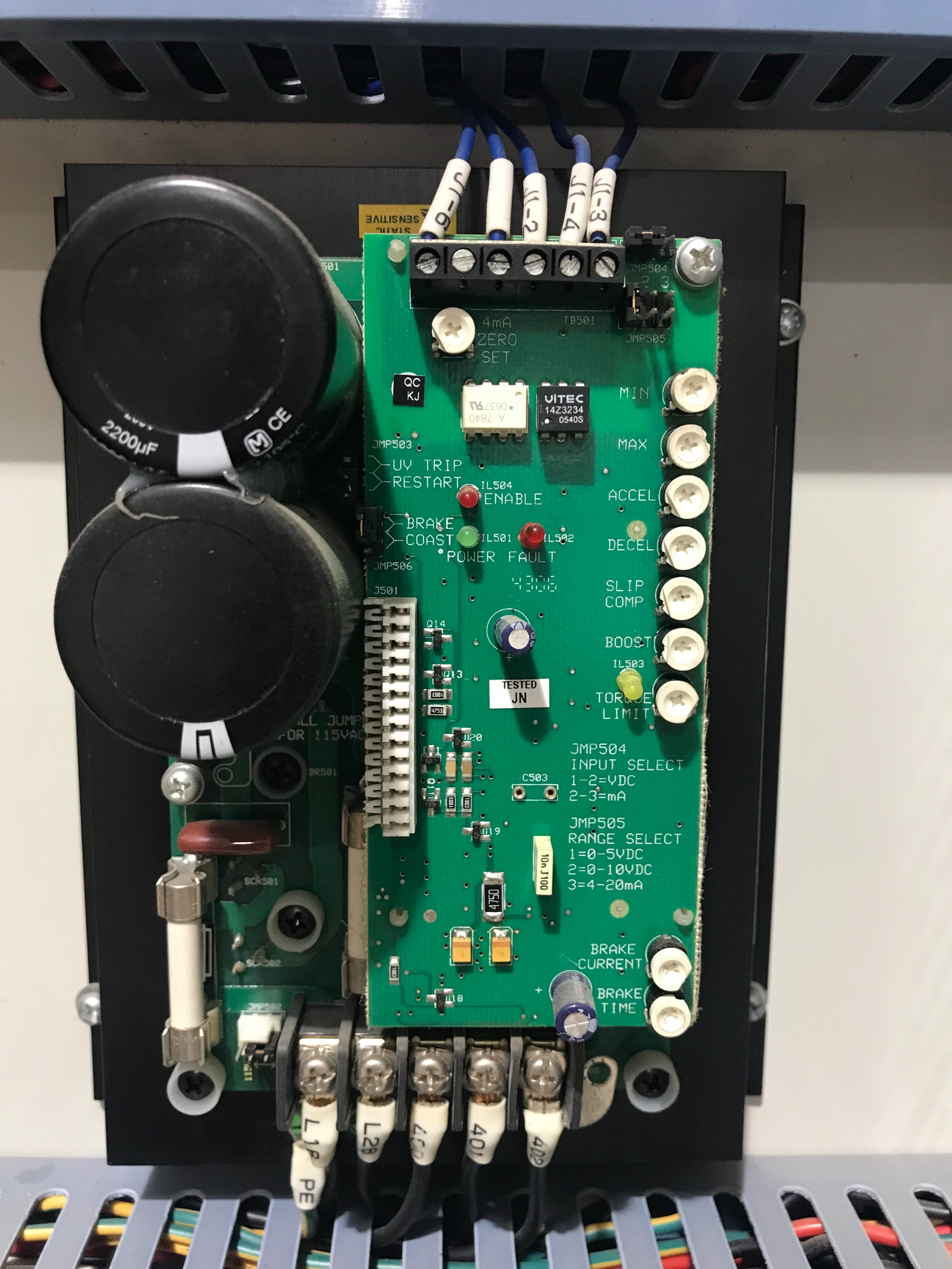

18 Sep 2019 18:51 #145536
by belli
I've had a look at the 'drive with pots on it', there is a single part number: 223-0462 Rev0.
I don't know who made it or what kind of drive it is but has 220/115V 1ph input and a 3ph output(U,V,W). The output stage is GB15B60KD IGBT's arraged in three half bridges. There is no micro that I can see but a 22V10 programmable logic chip.
It has an input for ENable, Direction and a Speed command (0-5V).
Perhaps someone here can shed some light on it.

- Ilikeapples
- Posts: 11
19 Sep 2019 19:00 #145613
by Ilikeapples
I just checked the bob, it is a 30162 ver 2.0 rev 0
Replied by Ilikeapples on topic Upgrade to PP 2.xx on Tormach 1100 series 1 from Mach 3
