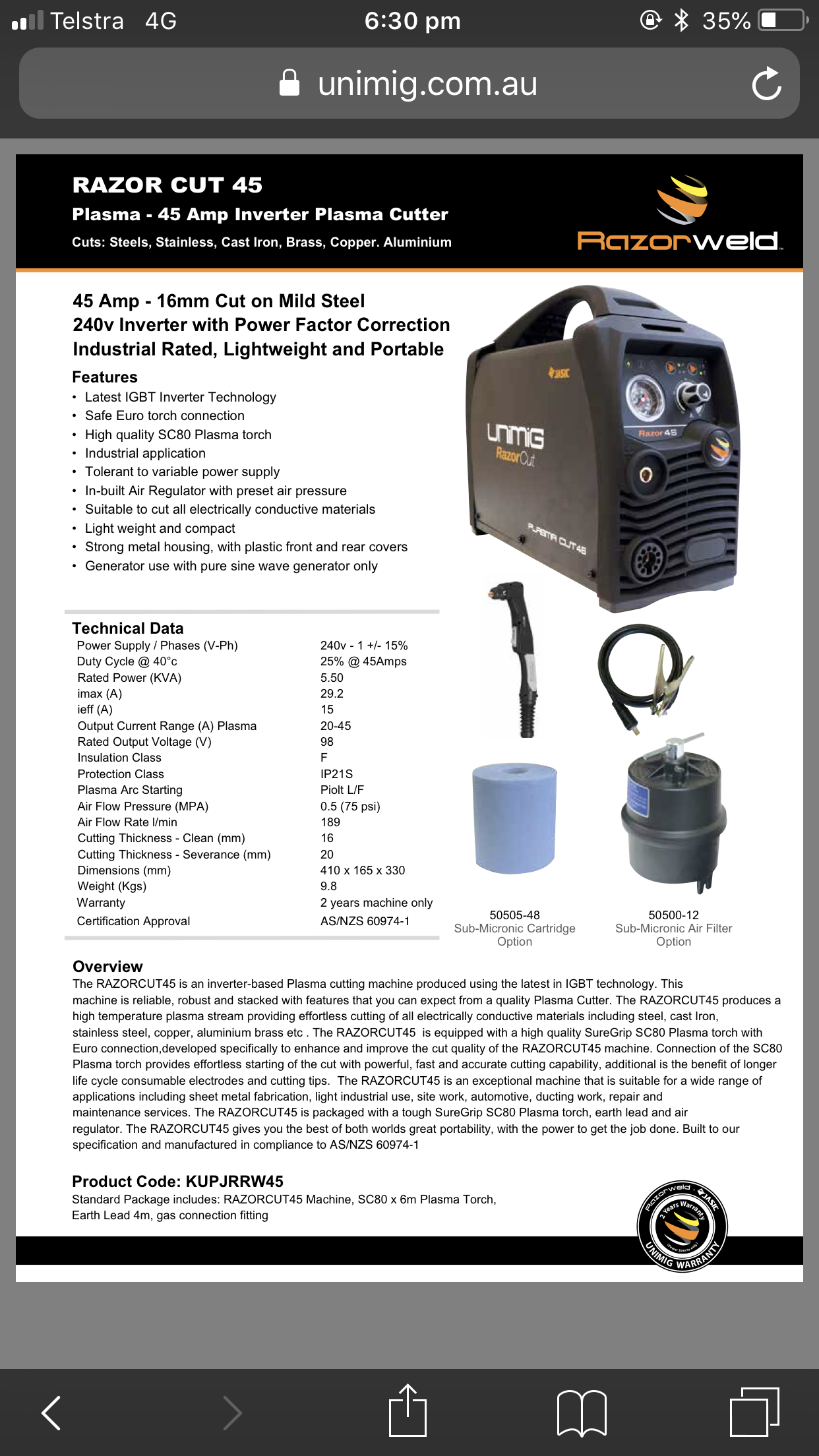

Hi everyone,
Will a L/F pilot starting plasma cutter work with a CNC machine? (Is it like a blowback start?)
Background info:
I am looking at making a CNC plasma cutter and know that a HF cutter won’t work but people use blowback style plasma cutters.
However in Australia the only plasma cutter I can find that isn’t HF start is a UNIMIG razorcut 45 which uses a “Pilot L/F” as a means of plasma arc starting.
My question is if this is like the blowback method used widely in CNC plasma cutters? The razorcut 80 uses the same staring method and has CNC connectivity which to me seems like it should work?
I will attach a PDF of machine.
Regards,
Little_sparky

That is simply not true, i have set up several HV/HF start plasma cutters in use every day. They do work perfectly, granted good grounding and shielding is implemented.
I have yet to test if the THCAD from mesa can work with them.
It all narrows down to where you connect the THC voltage on the plasma cutter, they all have a smallish filter board with some resistors and capacitors, and that is where the control voltage should be wired, not at the terminals that go to the torch.
Replied by tommylight on topic Plasma Pilot Arc Starting

From the Mesa THCAD manual
So for a HF start device, use the THCAD10 board. Its actually a very well designed purpose built interface board designed for plasma applications.
The THCAD is available in two voltage ranges, 0-10V and 0-300V. When used for plasma voltage monitoring, the
10V version requires an external high voltage resistor. The advantage of the 10V THCAD and external resistor is that the resistor can be selected to work with high-frequency start torches. The 300V version of the THCAD has all input divider resistor on board and can connect directly to the plasma voltage of touch start type torches only.So for a HF start device, use the THCAD10 board. Its actually a very well designed purpose built interface board designed for plasma applications.
