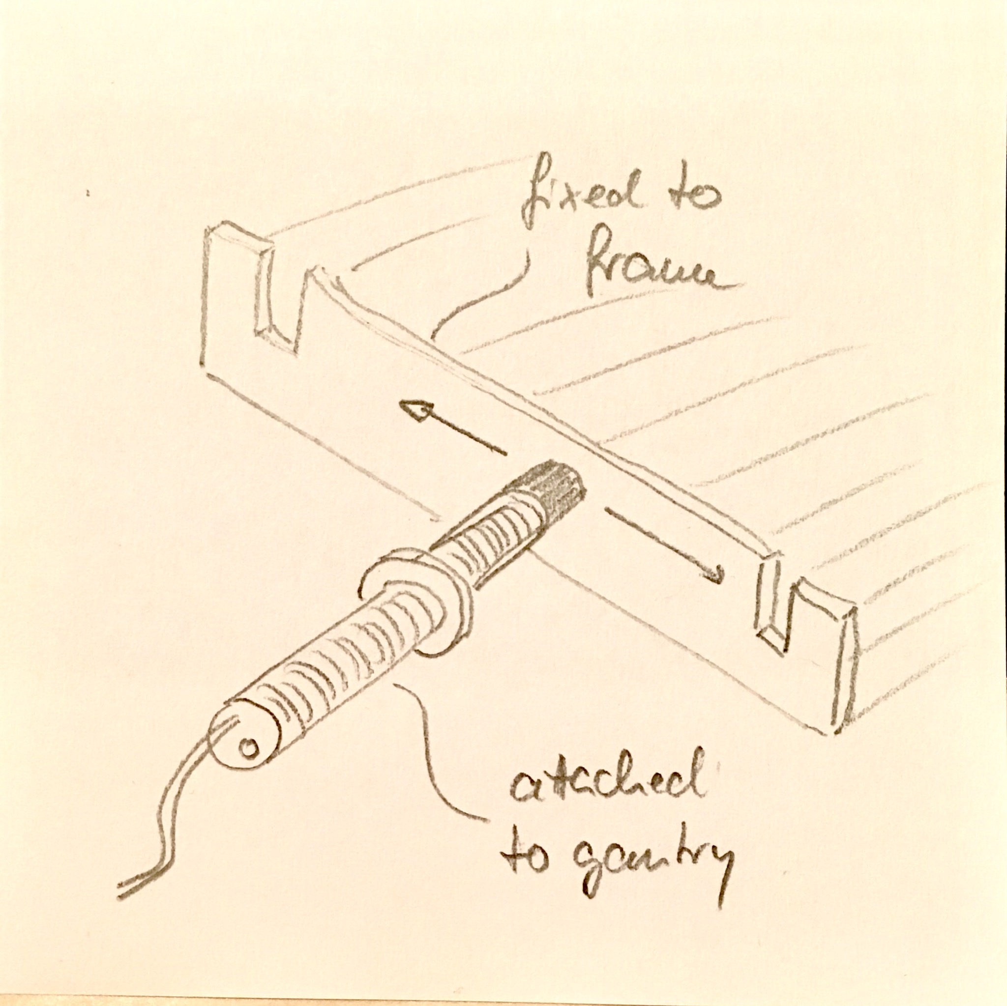

I am considering to use a proximity sensor on an axis as min and max and home switch, if that is possible.
My thought is, that the switch is kept closed while it is between the two notches of the aluminium plate and that hitting on of the notches would act as limit.
The machine would during homing back off the notches towards the middle.
I would use a pin from my 7i76e to create a "combined-y-limit" signal from this input and then feed this signal to the three pins of the axis.
Is there a drawback to this approach (apart from losing a little bit of travel, because the gantry has to move back to the solid middle part after homing)?

A target wth a slot can't work as the system has no way to know which way to move to find the slot.
A target that covers half the axis can be used as a centre-positioned home sensor.
Home and both limits can be 1, 2 or 3 sensors, and LinuxCNC can be configured to move one way if the home sensor is not tripped and the other way if it is. And then there is the option of using HAL logic to combine them. So I think that a pair of sensors close together and a long target with a gap at one end and a narrow pip at the other end could work. (NOT A + B = min limit, A + NOT B = max limit, use A alone as a home sensor. )

You have plenty of inputs on your 7i76e so why don't you do it properly?
I have two prox sensors on the moving part of the gantry. One for home and another for limit. The home sensor is mounted lower than the limit sensor so it sees the flat mounting plate. The limit sensor sees the raised section. The flat section is to allow the axis to coast to a stop during homing without triggering a limit or crashing.
I just move a home offset to finish homing 1mm from the limits. The sensor on the right is for the opposite limit.
