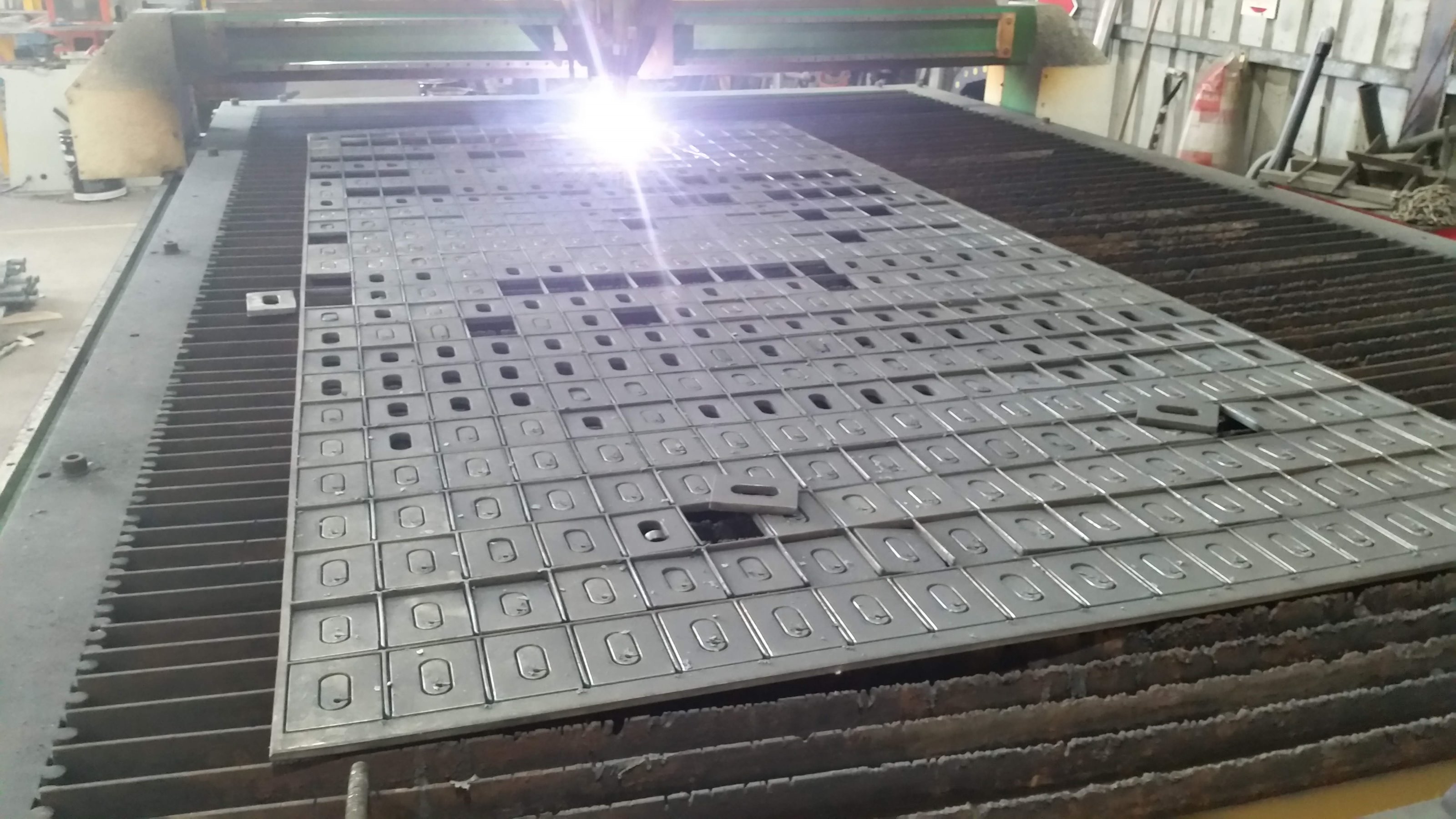

Hi Guys,
I have been watching on with great interest with the development of the PLASMAC branch,
I am getting ready to test it out on my industrial machine,
One question, I am currently using CommandCNC from CandCNC and the feature we use the most is run from line,
We cut large sheets (3000x1500) full of small parts, and as such we need to replace consumables halfway into the sheet.
We currently can select a line running into a cut and resume cutting from that position anywhere on the sheet,
Can PLASMAC do the same thing?

CommandCNC has an improved version of the open source editor used to display the Gcode which allows line selection in both directions. I tried to talk any of the coders here into splicing it into Gmoccapy with no success. CommandCNC still has the usual LinuxCNC short coming of not tracking the modal state of the machine when jumping to a new code block.
The Plasmac branch will allow you to stop cutting and replace consumables. Typically you will do this between cuts so you are ready to go when finished. You can use the reverse run (adaptive feed) feature to back up to the last start point if I remember correctly as well.
How well all of this works in the real world is highly dependent on how your Gcode file was generated and where any required preambles are in the code. If your PP inserts a full preamble at every new part and tool change then you can do a standard run from line and everything should be fine.
The good news here is that CommandCNC is a fully installed version of LinuxCNC. This means that you can clone the Plasmac branch and do a RIP build and have it as a stand alone install that will work without interfering with CommandCNC. The big problem will be you will be on your own to work out the proprietary interface to CandCNC's proprietary THC. It can be done, you have all the information and files required on your present install but you will have to do it yourself. The big drawback with doing this is you loose the Plasmac branch's integrated THC using Mesa or other hardware. The other ways is to port Command CNC over to a 2.8.~ pre install. Command CNC is just a Gscreen skin that comes with a fancy proprietary installer and support for the proprietary hardware. I have ported CommandCNC to run using general purpose Mesa hardware under 2.8~pre. I got as far as moving the machine and controlling the plasma with THC, never any production cutting.
Needless to say if you try any of this CandCNC will not support your install anymore and likely will void your warranty and ban you from their forum.

You can shure run from every line you want
and you can have a button to preload the torch bevor pressing RUN from here
so it is at the max end to be used a 2Mouse klick as run from line

John,
Have you used the PLAMAC branch for production work? What do you do if your half way through a sheet and the machine stops for some reason- consumables - probing error- etc,
I produce sheets like this every day and I need a reliable way to recover from a error,

Yes, as long as you make sure that your machine is in the correct modal state you are fine to go.
The biggest problem you will have is that the Plasmac branch will not support your CandCNC hardware without significant changes. The Plasmac branch is really a way to use the plasmac hal component for doing all your torch control, probing and THC. I does not rely on Gcode subroutines for probing and Z height synchronization at the end of a cut. It also handles all of the piercing. All you need for a cut is a M3 to start and a M5 to end. The problem is the present component doesn't support the use of CandCNC hardware. It could but it would require the developer to have access to the hardware and the proprietary drivers.
I have done very little production work so far with the plasmac branch but it is very promising. My work is a corner case doing artwork mostly cutting 14GA HR and 14 & 11GA SSTL. I only cut full sheets at a time. The THC is the best I have ever used hands down, not bad for a $69 THCad card. It has been a real change for me because previously my SC PP was even more complex than the CandCNC one with lots of conditional code to decide whether to use cutting parameters from the Gcode file or the GUI (a check box on my custom Gmoccapy GUI selected what you want to use). Most of my parts use 2 to 8 different tools, combinations of cut parameters to get the effect I want, this part is still a WIP in the plasmac branch. Your parts look very easy to cut and you are using thick enough material you don't need to fuss with ohmic probing. I typically get 2K to 3K pierces out of a set of HT consumables using the copper plus electrodes, 3 nozzles per copper plus electrode with Finecuts, less with standard Duramax nozzles and shields.
Sorry I know this is clear as mud but you asked about a really big development project.
