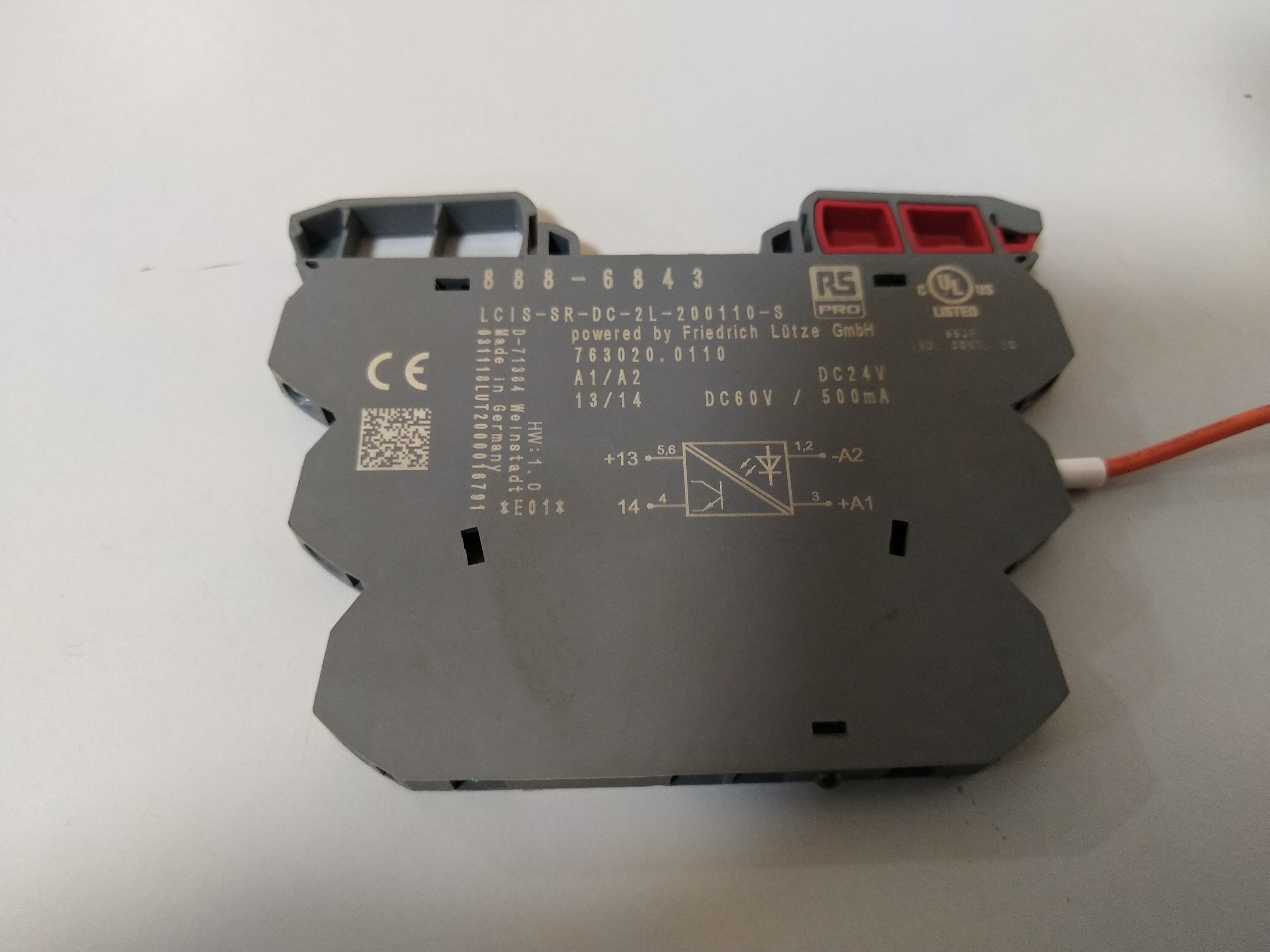

Hi, currently I am using the Solid State Relay (RS Components Part # 888-6843) to wire the 7i76e board and Hypertherm 45. The A2 is connected to pin 3 on the Hypertherm 45 cpc, A1 is connected to pin 4 on the cpc(torch on connection) and 14 on the relay is connected to output on 7i76e, 13 on the relay to 0v. But when I turned on the power on the Hypertherm 45, the temperature led and fault led on the Hypertherm 45 came up. From what I know, it's "stuck start" issue because there is power on pin 3 so Hypertherm 45 won't start properly. Is the issue caused because I use the RS 888-6843 solid state relay? Is there any way to solve the problem? Should I switch from the RS 888-6843 solid state relay to the dry contact relay? Thanks.

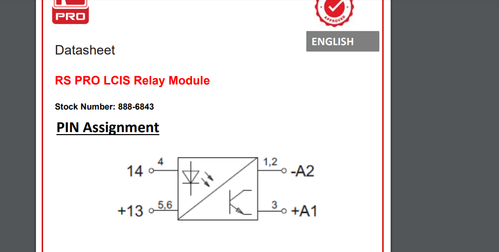

There is bit of a disconnect here. Looking at the RS Components listing page, The circuit diagram on the part is different to the one in the data sheet. (pinouts reversed) I'd have to check how I've wired this in on my table but I'd start by experimenting by powering up the trigger side and ensure the led light comes on before connecting it to the plasma cutter.

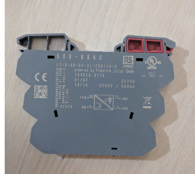

The relay I have here is different to the one in the Data Sheet (as seen in the attached picture). Should I swap the A1, A2 connection to 7i76e and 13, 14 to the Hypertherm?

I just bench tested one of my spare relays, A1 should the the + voltage from the 7i76e and A2 should be 0v. Then 14 and 13 should go to the Hypertherm CPC port.
I dont know what is going on at RS components but the diagram on the actual relay it self is different to the diagram they provide on their web site.
