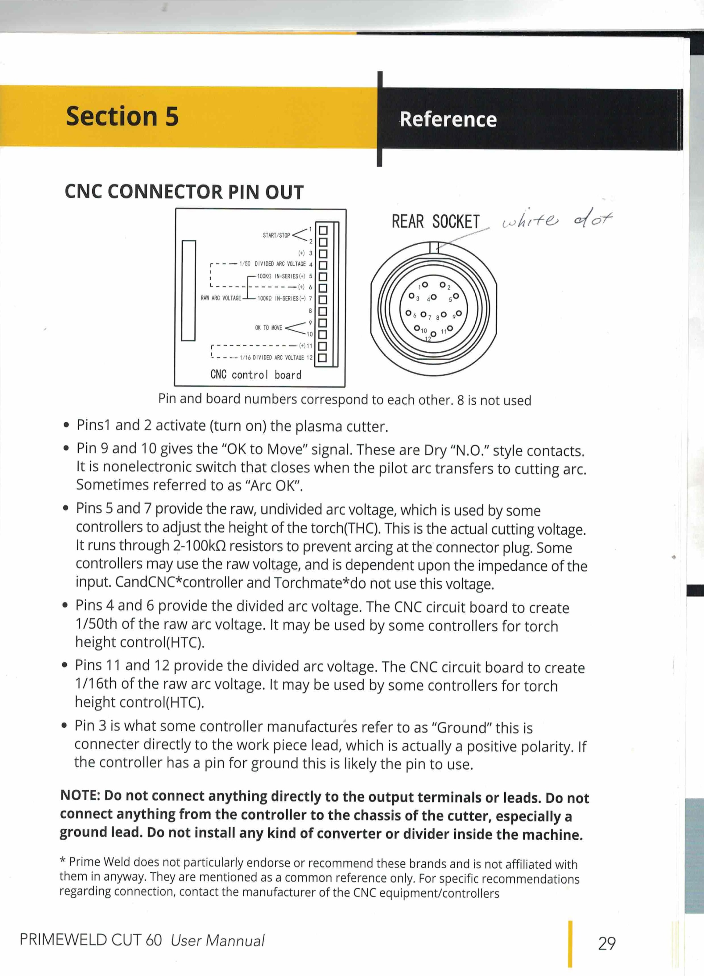

Anyone interface Mesa boards to Prime Weld Cut 60 - it has a mulipin round connector with I think Arc On and maybe Arc OK. And I'm not sure what if any the torch internal divider is?

PDF, connector pinouts ?

Heres a copy I found in the manual for the cnc connector in assignments
Mostly clear except for the polarity and grounding issues ???
Hope the .jpg is readable.

Moving on, more info
what mesa board?
what THC ?
Should have provided all the info on the original post
what mesa board?
what THC ?
