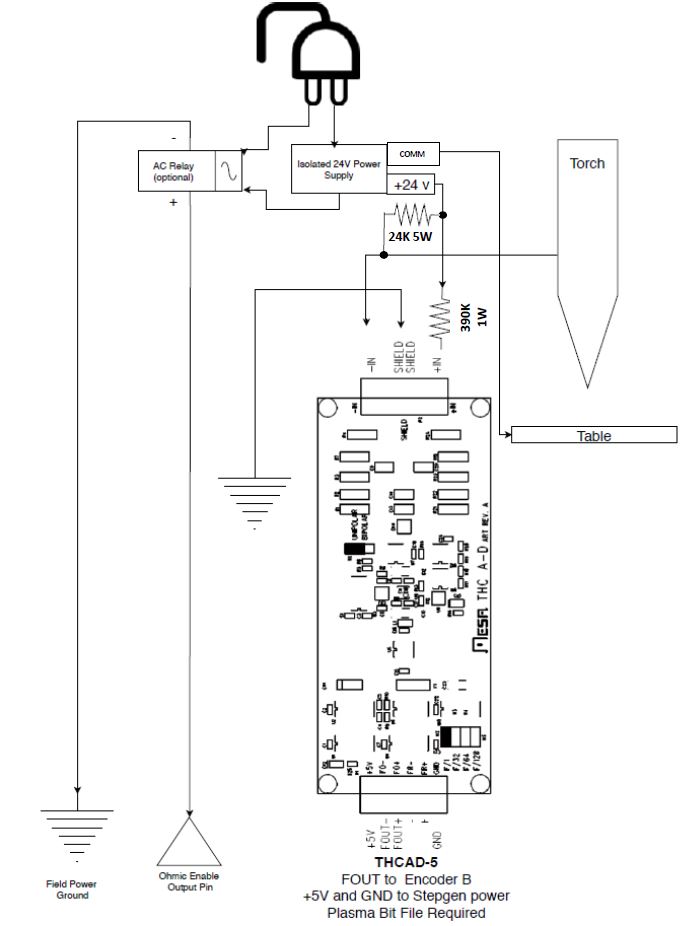

so,I was following thefabricator03 Example wiring diagram Post No:#148670 I colored some lines (red and green ) to make it clear and just want to make sure if everything is right.
I'd appreciate any feedback guys

Looks good, except for TB1 pin 5, should be wired to pin 1.
It will work as is, but not preferred since the VIN and VFIELD can be separated by a jumper so moving that jumper might cause issues.

My question is do I need to set jumpers W10, W11 and W13 to single or differential mode, I just copied and followed WIRINGDIAGRAM as is
The only thing I changed I use 48vdc switching power supply to Power stepper driver instead of toroidal transformer because I couldn't get one, if this is Will change or affect in any way on WIRING DIAGRAM Please inform me

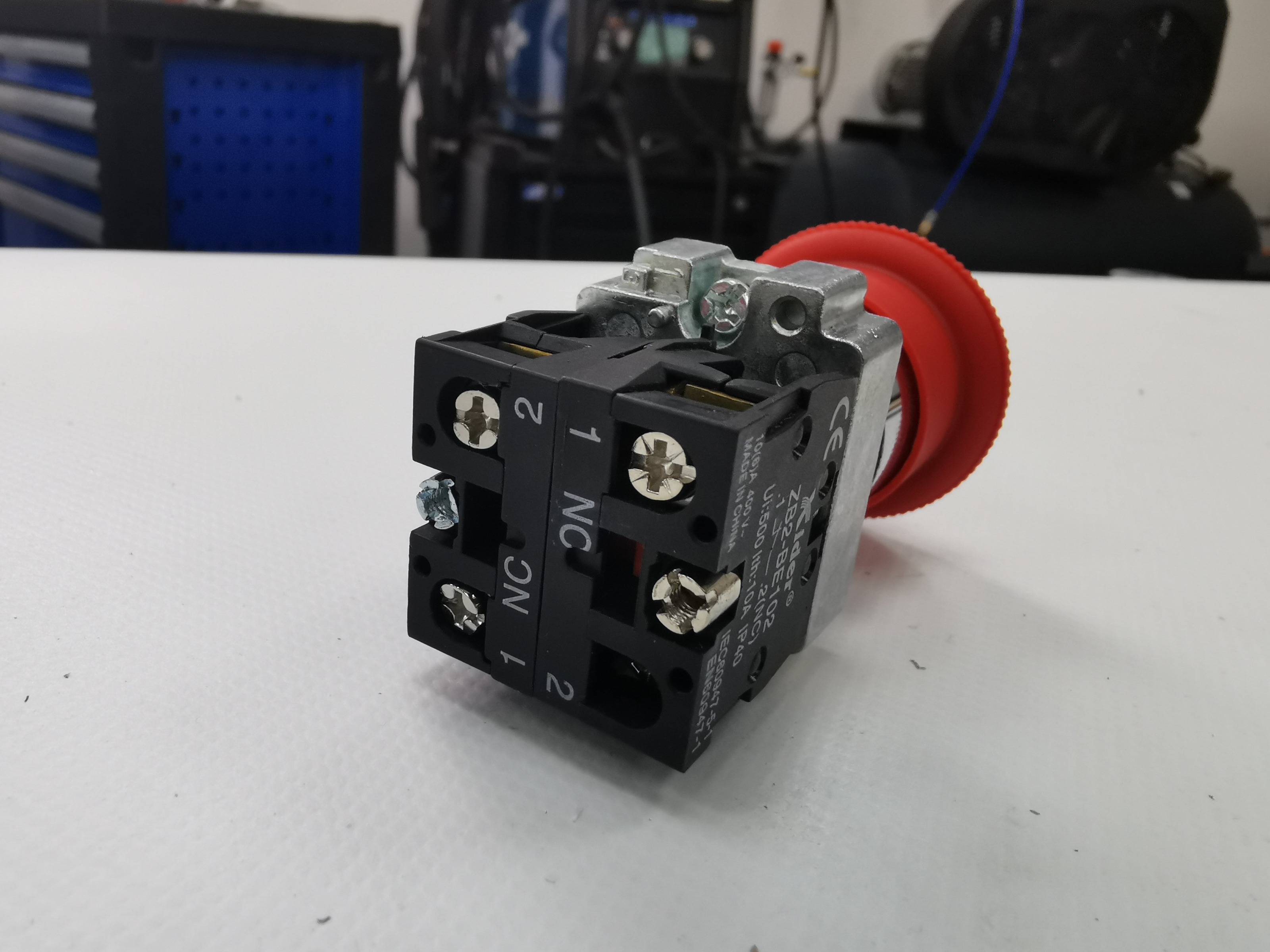

I really confused about E-stop It is 2 NC. I attached a picture of what I have and want to make sure if this is the right one

estop is correct. they are "normally" NC {normally closed} contacts for 2x reasons....
1) you can daisy chain a number of them together so if you hit / trigger one, the whole signal is lost and everything stops
2) more importantly.... if the signal was NO, how would you know that something had failed if the cable had been cut / power lost to the estop circuit.... having it NC means you have a positive confirmation that the circuit is intact / operating and when the signal (voltage) is lost for whatever reason everything is stopped.

encoder input = differential mode as it offers better noise / signal immunity
I have not been successful with switched mode power supplies powering stepper motors (but I know 100's if not 1000's of people use them).... but my stepper motor drivers use to sing and squawk under acceleration and breaking (mainly breaking with back EMF generation). I now only use toroidal transformers and the drivers and stepper motors are silent and move fast enough for my needs. YMMV, give it a shot.
