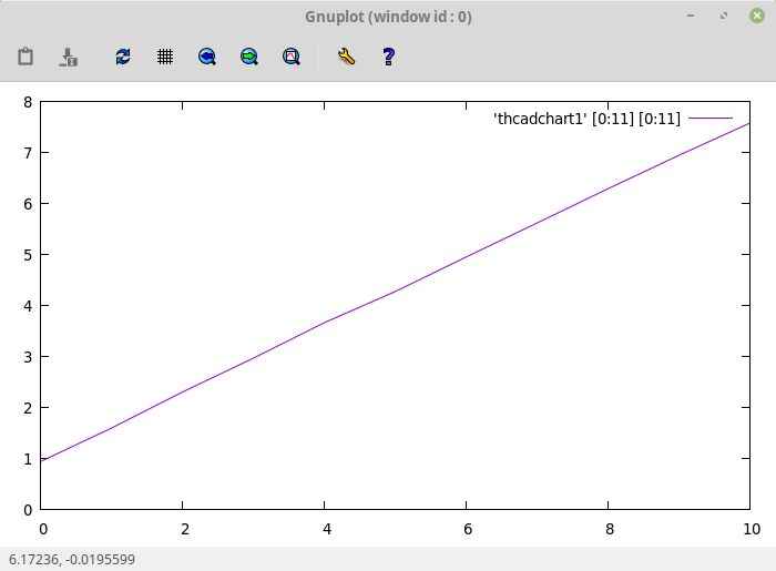

Long time ago I bought THCAD-10 card, but before card was arrived the my project was abandoned.
But now I have other project and I want to use that card lying in original package all that years and found that output is strange. As from datashet seems that it should be linear Voltage to frequency but as I supplyed voltage from power supply with 1V step and measuring results with oscilloscope I found that output seems more logharitmic than linear. Is That normal???
The jumpers was in Unipolar and F/128.
Attached is pdf with measurements. The 0V and 10V calibration from THCAD sticker seems to be valid. But linearity not.

Why didn't you measure frequency in Hz?
Every other example where I have seen people do similar measurements, the device was linear.

It has same result. 1/f=time and vice versa. So linearity should be same in both directions.

Here's the (scaled in Khz) inverse of your data:

The frequency with respect to input voltage is linear, the period is not. The V-F linearity is typically better than .02%

Hmm indeed with frequency is linear...
