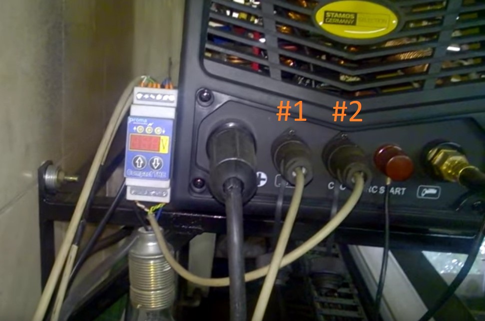

I found a video on youtube where the Stamos is connected to a CNC.
I also have attached a screenshot of it.

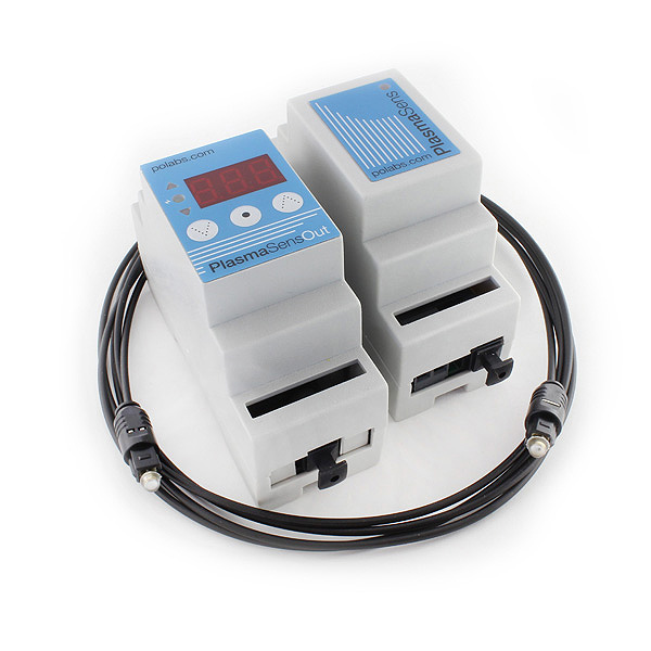

I think the Stamos has no voltage divider and is directly connected to the output from the cutting voltage. The easiest way is to connect the stamos to the plasmasensout (#2). In addition to the outputs for the height control, this also has an output for ArcOK.
For the start command, I assume that the contact of the second connection must be closed (#1). You can do this with a relay.

I've measured the CNC port on the machine (marked as #2 in hermann1976's picture), the bottom pin (pin 4 on the plug) is connected directly to positive/the workpiece lead. The pin on the top (pin 2 on the plug) is connected directly to negative/the electrode.
Measuring between the pins with the COM lead on the multimeter going to positive on the plasma cutter, I got something between 210 - 290 kΩ while the cutter was on and 17 - 19 MΩ while it was off. The values were bouncing quite a bit and not stable at all, I hope that won't be a problem?
Since neither of the two THCAD suppliers (EUSurplus and Welectron) have the THCAD-300, I think I'll buy a THCAD-10 and replace the resistors according to this post by PCW .
