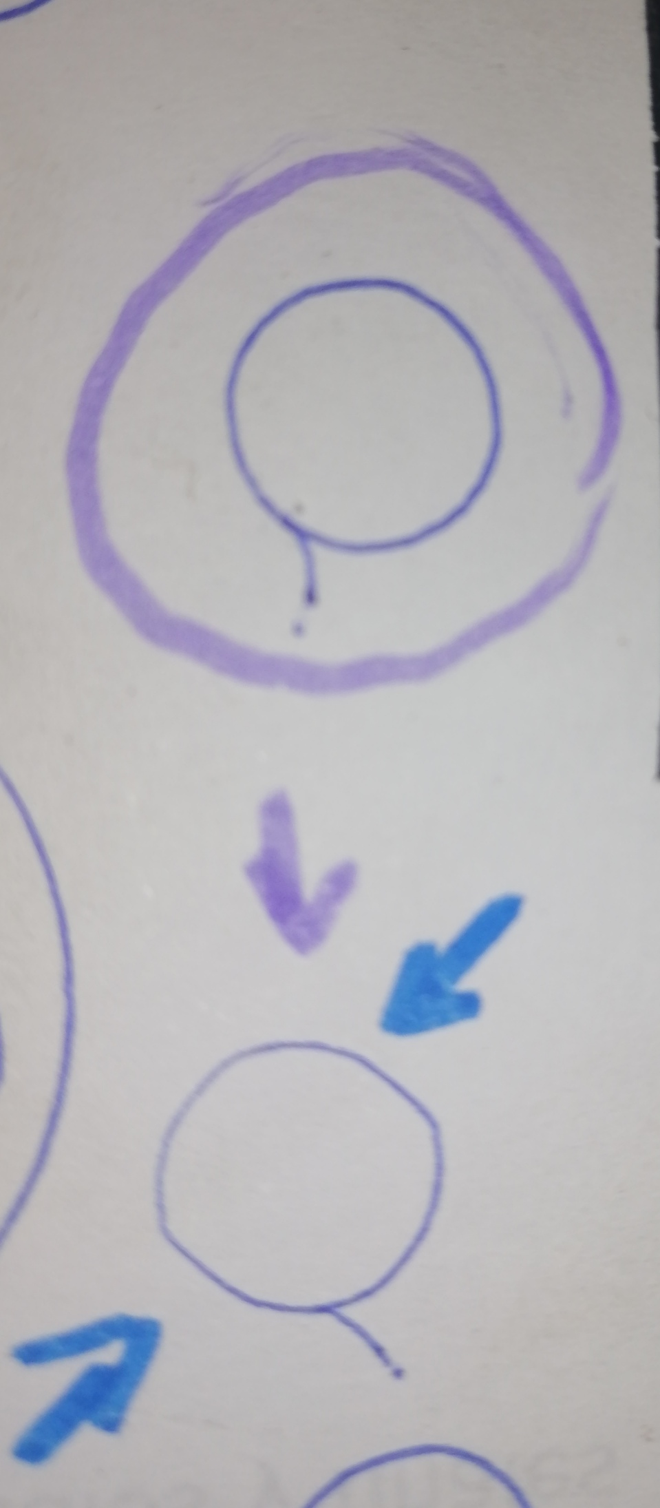

Bad circles plasma
- paulsao
- Posts: 233
- Thank you received: 22
25 Sep 2021 17:34 - 25 Sep 2021 17:38 #221564
by paulsao
Bad circles plasma was created by paulsao
Last edit: 25 Sep 2021 17:38 by paulsao.

25 Sep 2021 18:19 #221568
Replied by tommylight on topic Bad circles plasma
Mechanical backlash from the looks of it.
Check for something loose, pulleys, gears, pinion to rack, belts...

25 Sep 2021 21:47 #221579
by chris@cnc
Replied by chris@cnc on topic Bad circles plasma
I think yes. It looks like one axis accelerates faster than the other. Compare the parameters. It is good if all have same stepscale, acceleration and velocity. Mark the transition.

- Posts: 18103
- Thank you received: 5326
26 Sep 2021 03:09 #221597
Replied by PCW on topic Bad circles plasma
It really looks like mechanical backlash or a
combination of spring and stiction to me.
I would try jogging back and forth in the axis with
the worst error and checking for lost motion with
a indicator
Its mainly along the axis which is a line between
the two arrows of the plot.

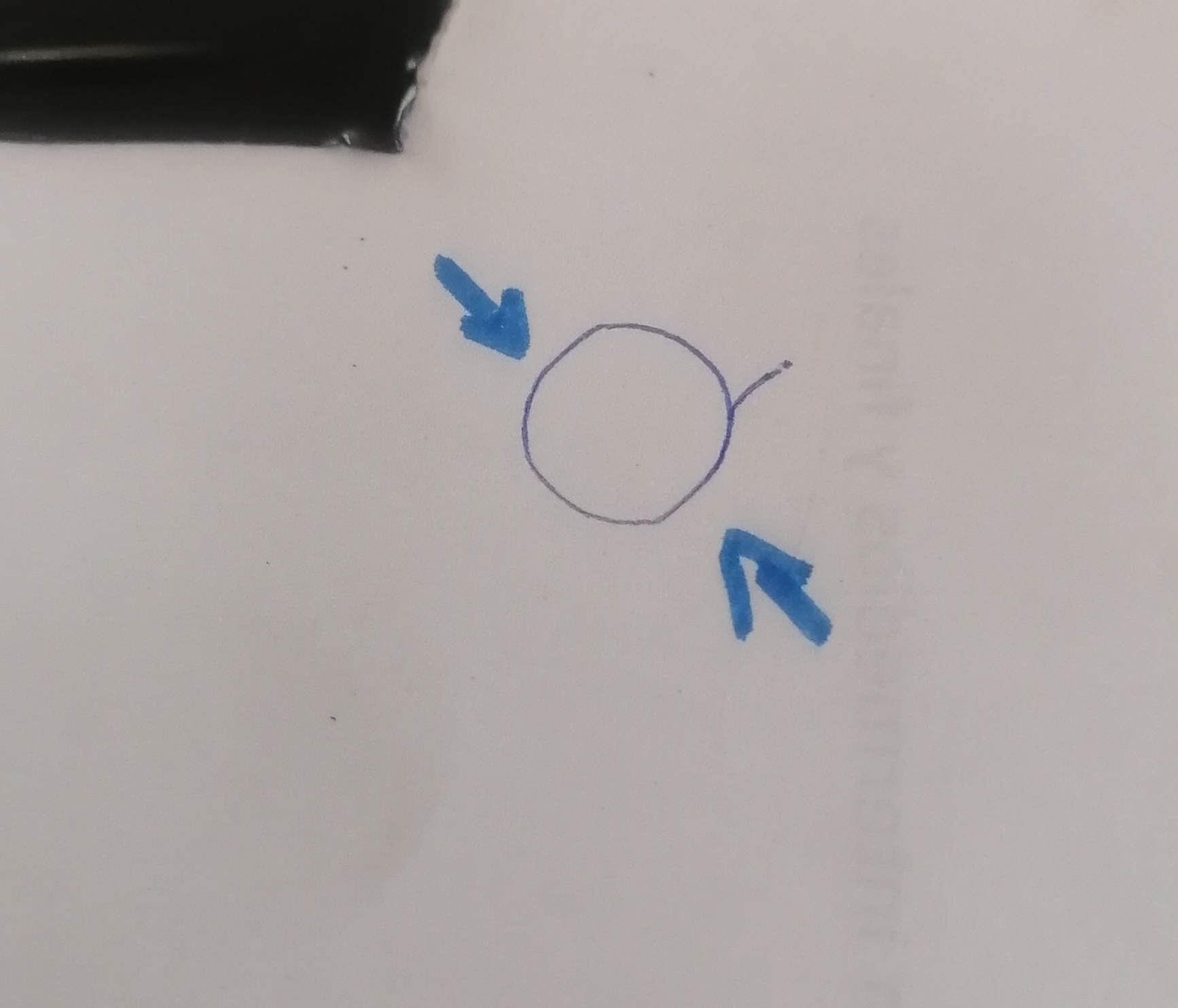

- paulsao
- Posts: 233
26 Sep 2021 14:18 #221632
by paulsao
Replied by paulsao on topic Bad circles plasma
- chris@cnc

26 Sep 2021 15:00 #221640
by chris@cnc
Looks better. But circle is not quite round yet. The xy axis is not square. You can adjust y gantry little. Attach a pencil and draw a square on paper. Turn it same place around and draw again. Now you see error and adjust the half in homing offset.
- Posts: 21980
- Thank you received: 7481
26 Sep 2021 16:26 #221643
Can you set microstepping to 1/4 or 1/8 and scale accordingly and test again?
Direct drive with big pulley = no good.
Now that might be due to microstepping and the inability of motors to keep position when at any other angle than 1.8 degree due to forces/momentum/inertia/etc.
