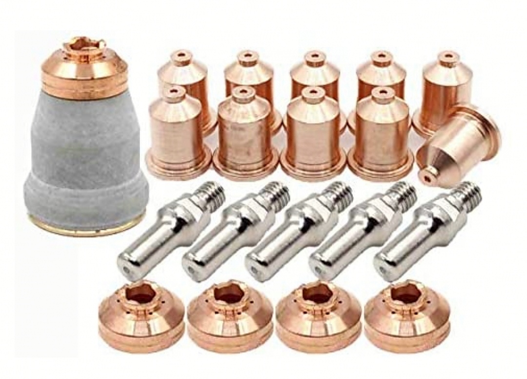

Anyone have some electrical circuit somehow to make an ohmic sensor for an ipt60 torch that is common and has no insulation, thanks for your help.

If the torch has no shield, ohmic is not usable with it, at least not safely.

Tommy I found this shield for ipt60 torch do you think it works? Is there a minimum clearance distance between the nozzle and the contact piece, or am I lost in something? I want to transform an ohmic sensor my floating torch.

If everything fits = it should work, it will need a springy piece of metal touching the shield and wired to the ohmic relay.
