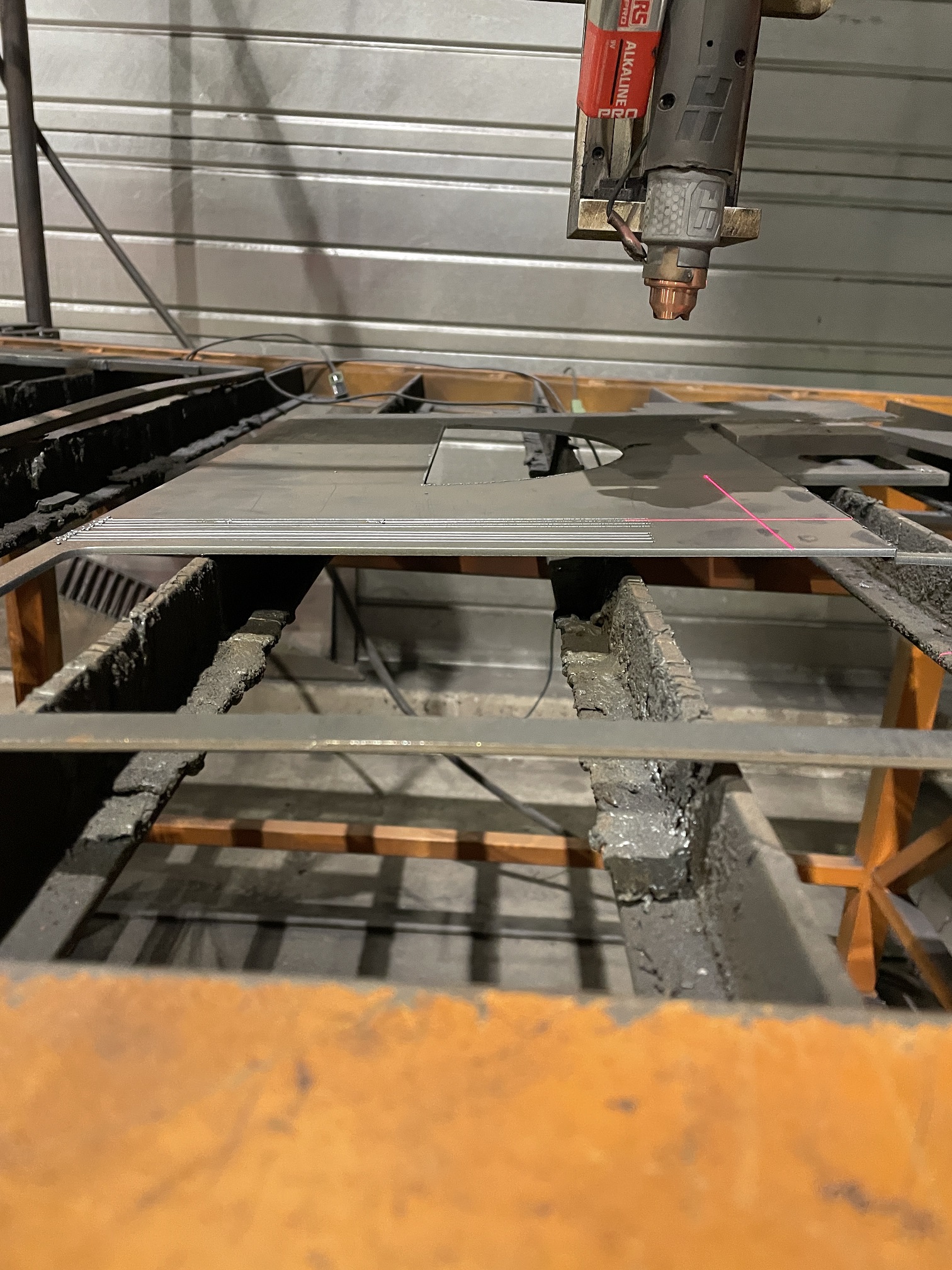

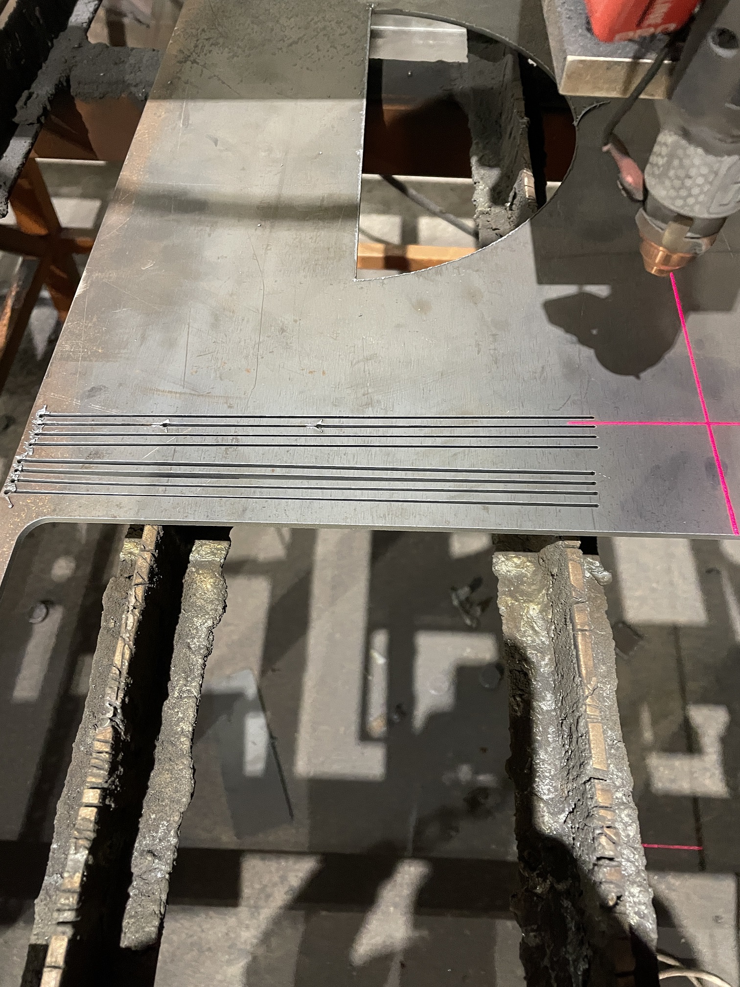

Here are the first tests of the THC, with a sheet placed on spacers:
Position of the sheet during cut:

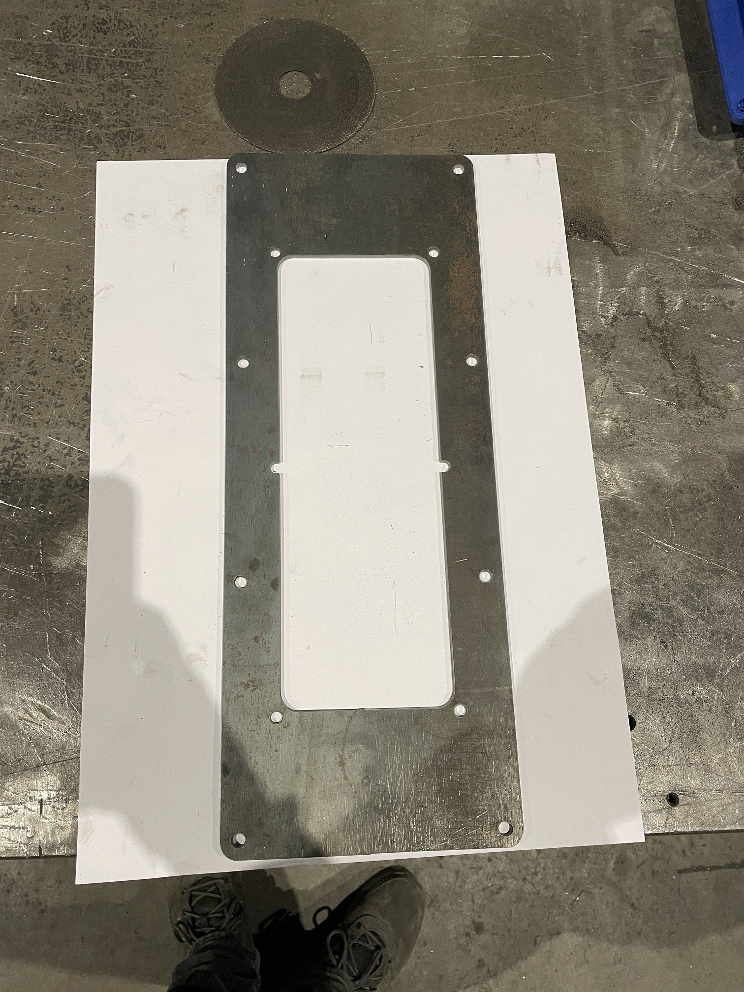

First produced part:

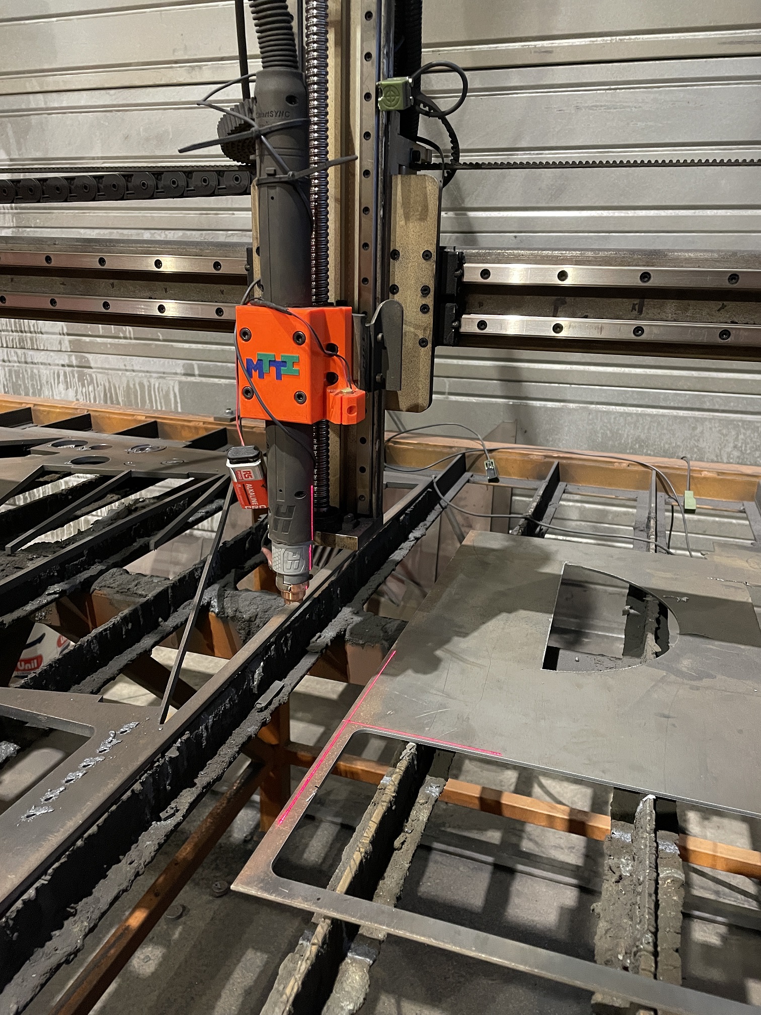

Another improvement I made: a cross-shaped laser pointer:

1. Nice build and nice cuts
2. why is there a hanging 9V battery on the torch?

Hi
The 9V battery is for the laser pointer, while waiting for it to be connected to an output of the USC controller board (the most tedious part is running the cable through the cable track).
