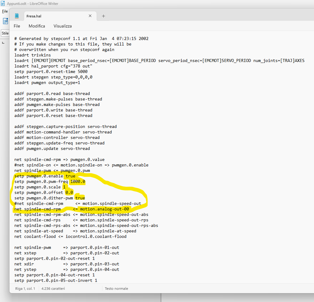

I'm installing a 20w laser on my CNC and I control the power of laser using the spindle pwm. The software LightBurn use M67 to control the laser power. I modify the HAL file to connect analog-out-00 to the spindle PWM and set the scale. The laser is ok and the power change. Can i use the slide of spindle override to increse and reduce the new laser signal ???? I'm not expert to configure linuxcnc.

Did you want the laser PWM controlled by both the feed rate and motion.analog-out-00?
If so you probably want to add a scale component to multiply the analog out setting by the feed rate.

You could use the spindle-override controls indirectly, using a HAL "scale" component to multiply the motion.analog-out.NN pin by halui.spindle.N.override.value
linuxcnc.org/docs/stable/html/man/man9/scale.9.html
linuxcnc.org/docs/stable/html/man/man1/h...l#Spindle%20Override
Replied by andypugh on topic Use override to modify laser power
Which of these do you want to use? They aren't really compatible.I'm installing a 20w laser on my CNC and I control the power of laser using the spindle pwm. The software LightBurn use M67 to control the laser power.

thank you very much. I really wanted to multiply the two signals but I didn't know the commands. now I understand and I will try.

The problem is solved. I add HALUI in my INI file and use a scale function. Now I can modify the laser power using the slide during the work. Thanks.
