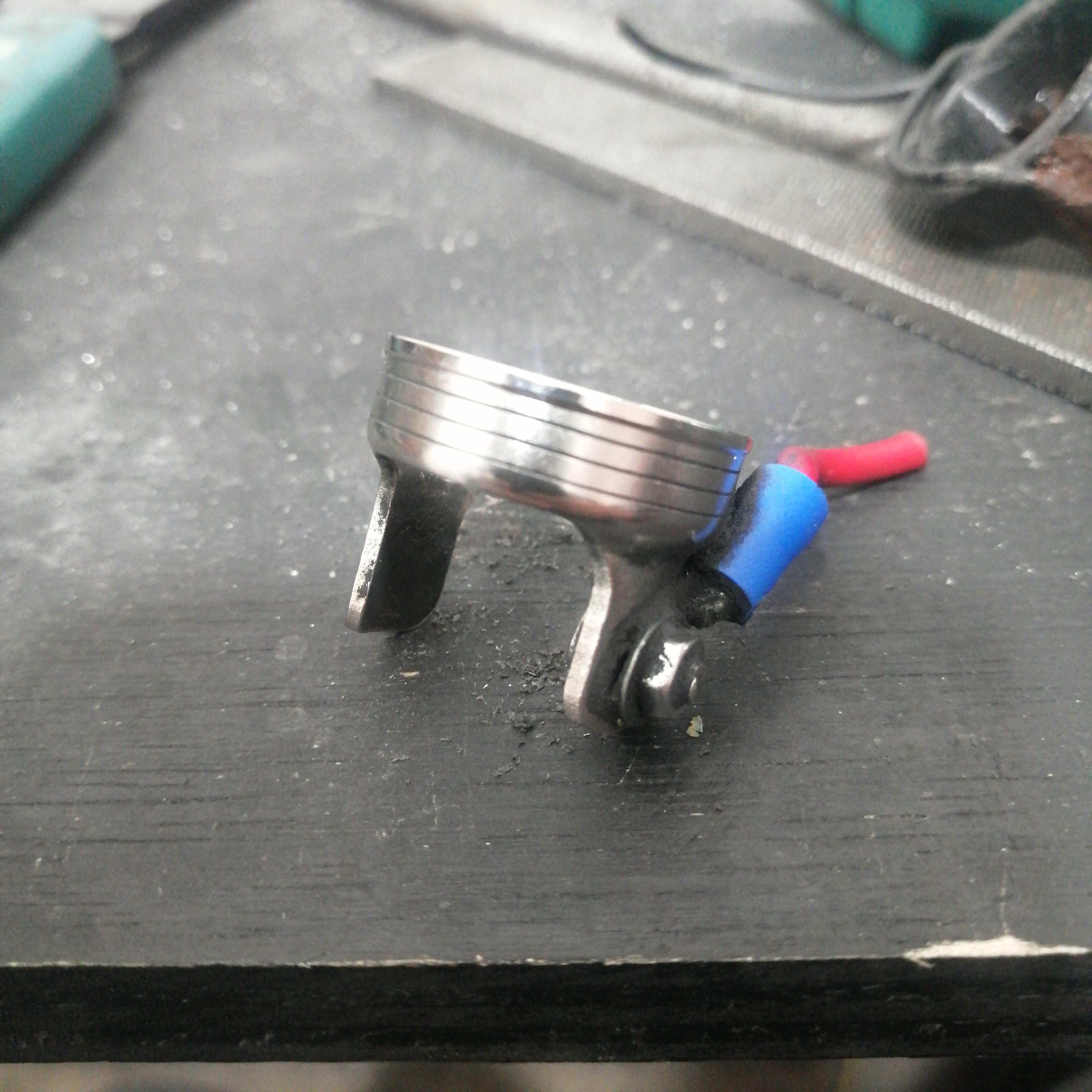

Greetings.I just built a water table for my plasma machine. I use a thcad 10 and ohmic 3 for ohmic detection, but I am having some problems in parts where I have water, the torch takes a longer time to sense and when it goes up it no longer has the cutting distance (1.5mm) but a higher one.Could someone help me thanks.

Water is always a challenge for ohmic sensing.
Assuming you used the circuit from the diagram that is floating around the forum for THCAD ohmic sensing, then replacing the 24K resistor with a lower value will help make it less sensitive to water. I don't run the THCAD ohmic sensing anymore, but I do run a 100 ohm 7W resistor. It definitely helped make it less sensitive to water on the plates. I think Phill runs 3x 100 ohm 10W resistors twisted in parallel to give 33.33 ohm of resistance.
That said, I rarely have a "wet" plate while sensing. I make sure to squeegee off any water before starting my cuts, and the air between cuts keeps the water away from where the next cut will take place. I imagine every plasma cutter has different post-flow air settings, so if the air is off before the next cut, you might try a longer post-flow (if it's adjustable) to help a bit.

I think what I am hearing you say is that water is adhering to the torch by surface tension on the way up. This keeps the sensing circuit closed until the water breaks away causing a false (higher) reading for material height.
Usually, this is only an issue for the first probe after which the air flow keeps the water away from the probe area. Before starting a job, hit the pulse torch button to trigger the post flow of air. This should clear the water before probing starts. That was the original intent of this feature and it was requested by Islander261 who also contributed the alternative relay method for ohmic sensing used by Snowgoer.

Yes Rod, that is the problem, I have an ohmic detection system (attached in the image) it works well the problem is that sometimes the water drops remain on the legs of the piece and give an error, I use that system because my torch is not machined for cnc, now I remember that I am using thcad 10 and an isolated source, could I connect it directly to the torch? I think I wouldn't have a problem.

You can try it. The circuit is impervious to torch voltage so in theory it should work.

It doesn't work hahaha, actually I would be making a short circuit on purpose and the probe would always be activated.
