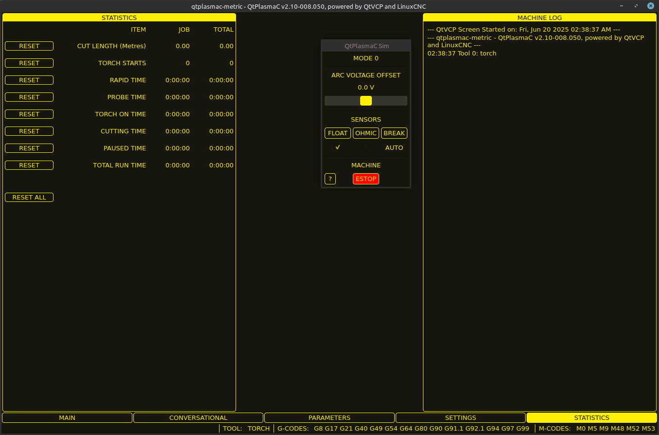

Hi, I work as a CNC Plasma Beam line Operator and any time I change consumables I have to reset the number of hit of the plasma to zero and as is cutting it count the number of hit, and know how long the consumables last and to change them can't we do the same thing to QtPlasmaC.
