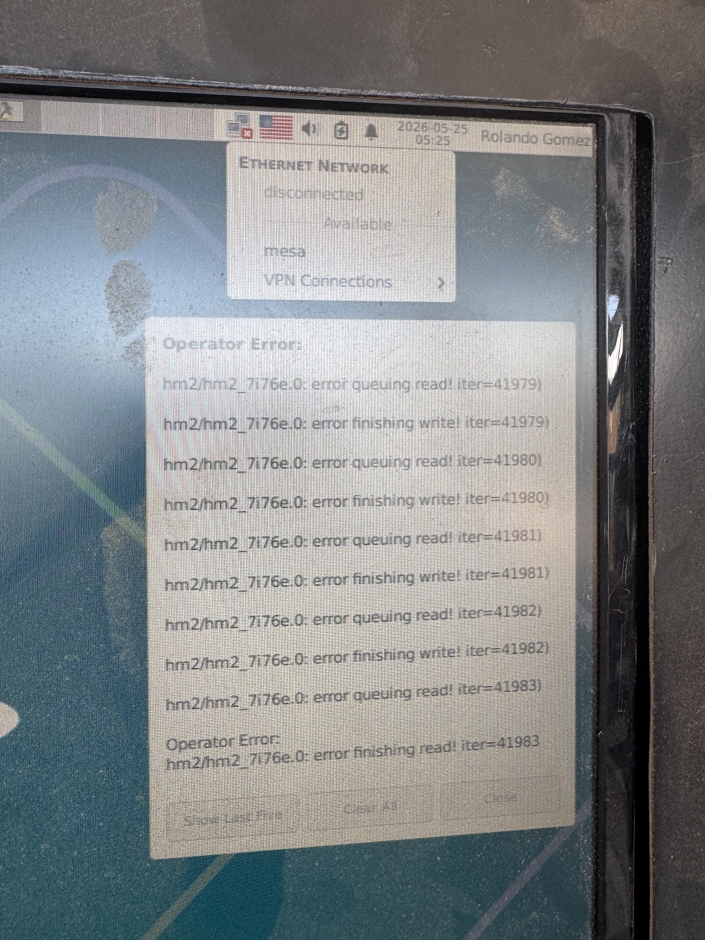

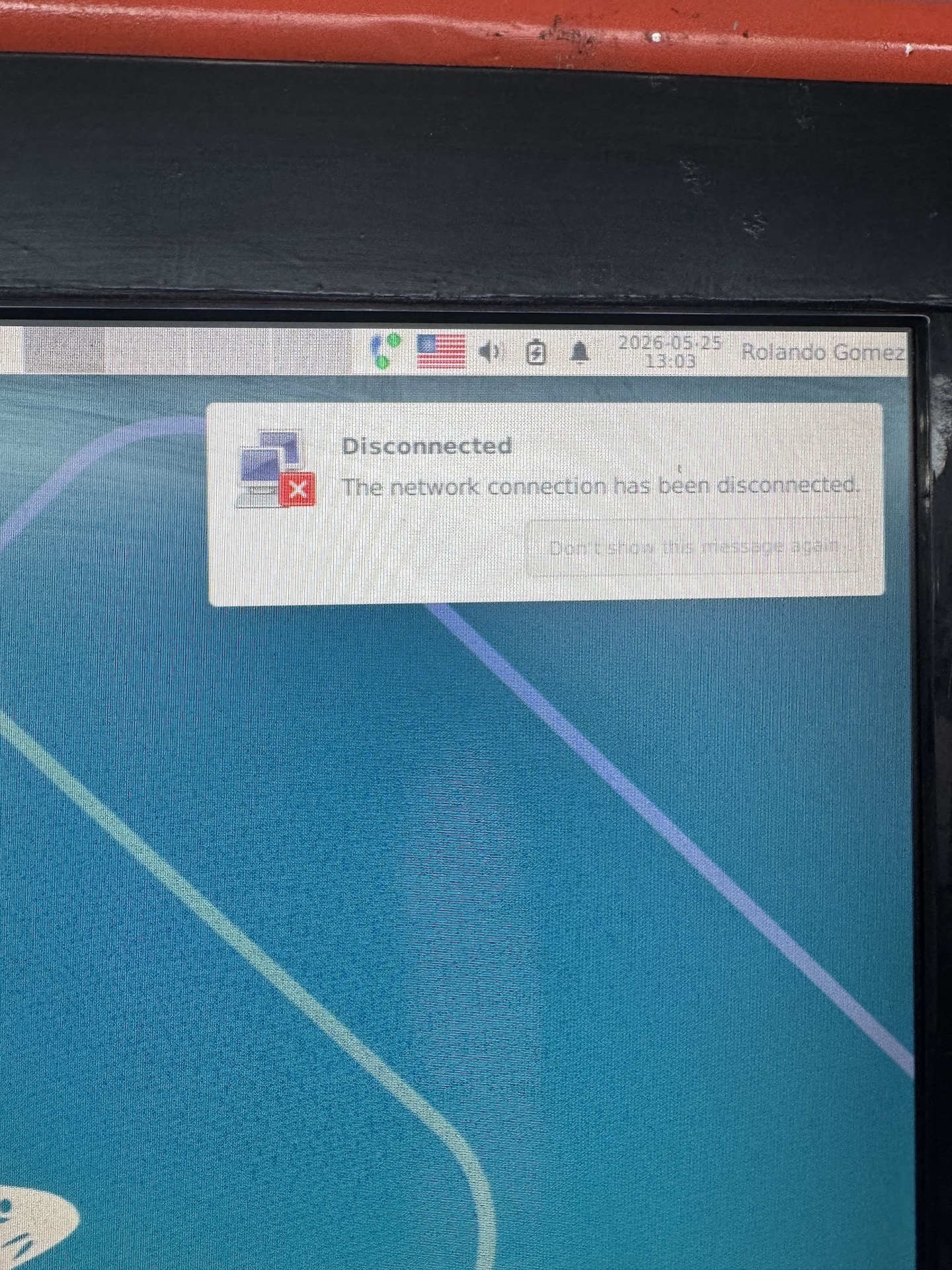

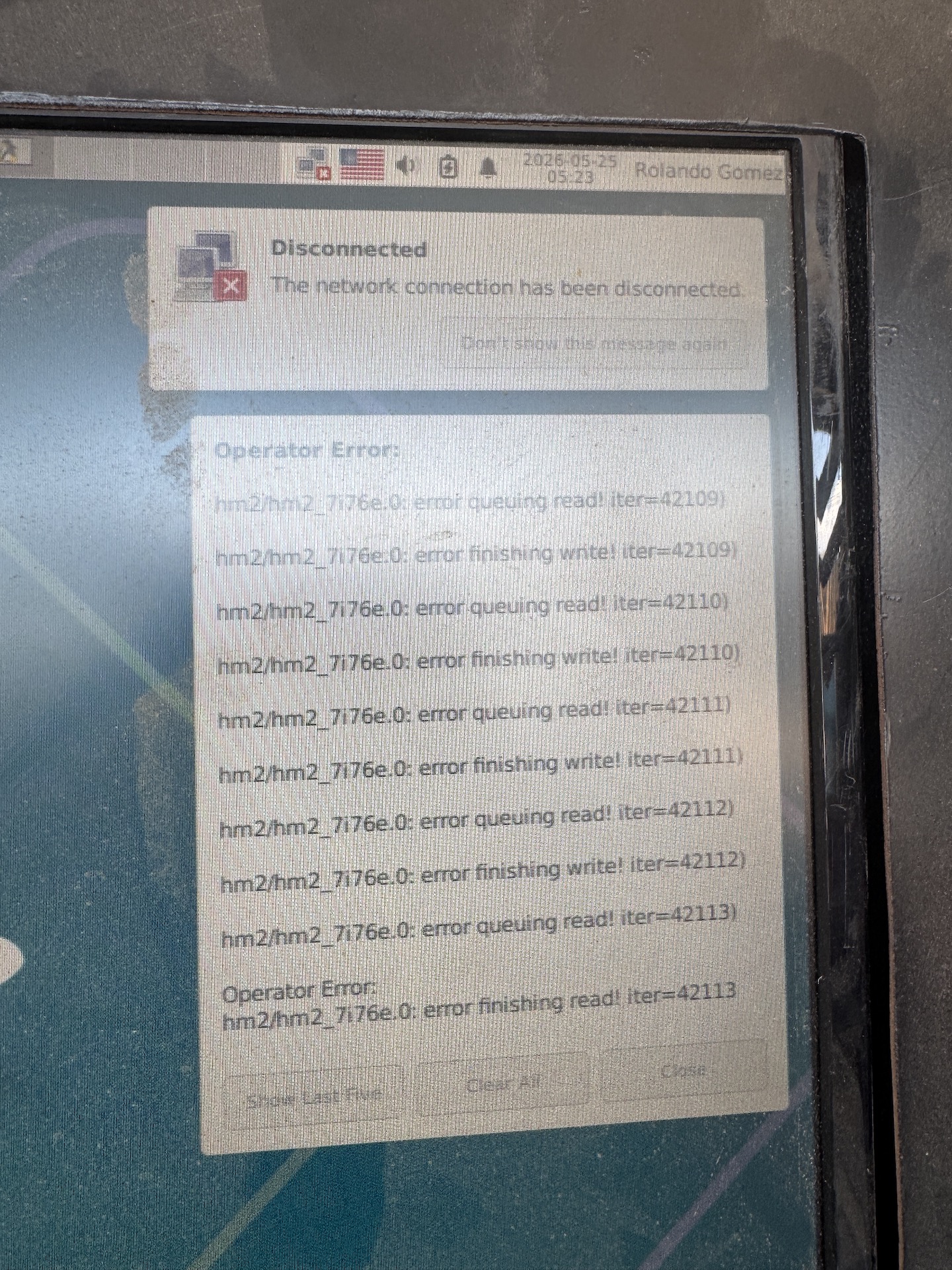

I ran pnconf wizard and made a configuration for my CNC plasma table. I am able to home and jog my machine for about a minute until I get this error.
It seems like the ethernet connection is disconnecting on its own somehow. Any ideas on how I could get the ethernet to stay connected so I can use my machine.

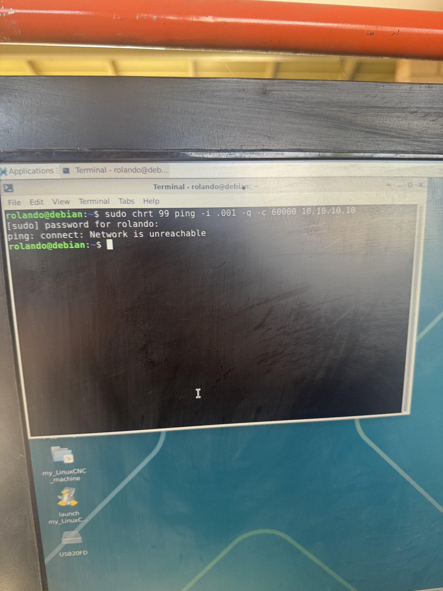

What does:
sudo chrt 99 ping -i .001 -q -c 60000 [card_ip_address]
report? (it will run 1 minute then print statistics)
[card_ip_address] is either 10.10.10.10 or 192.168.1.121 depending on 7I76e jumpering

Sounds like host or 7I76E issues

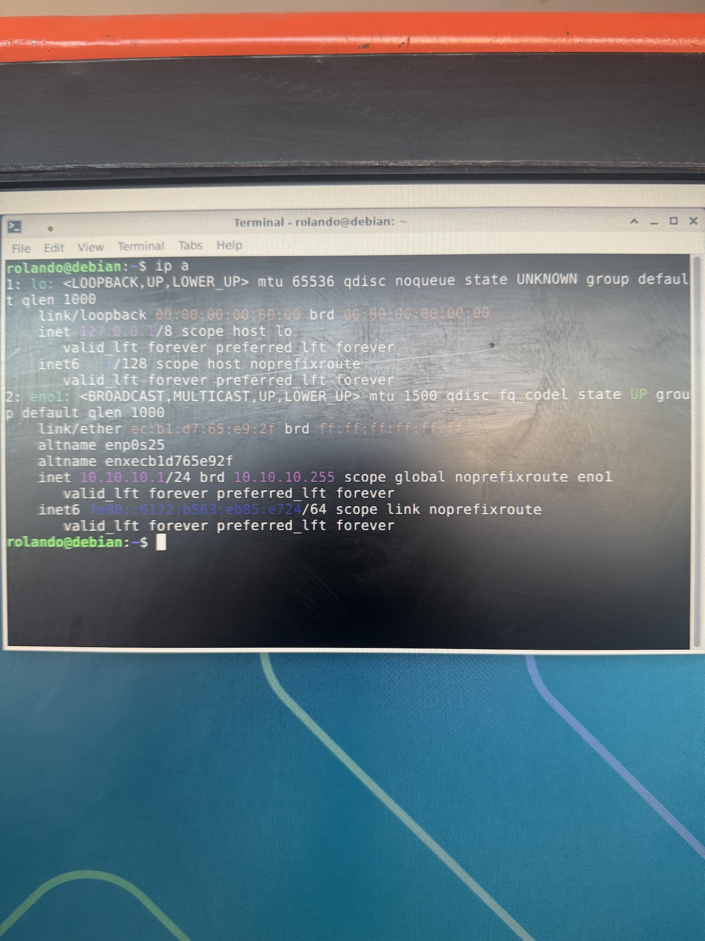

Whats does
ip a
report?
