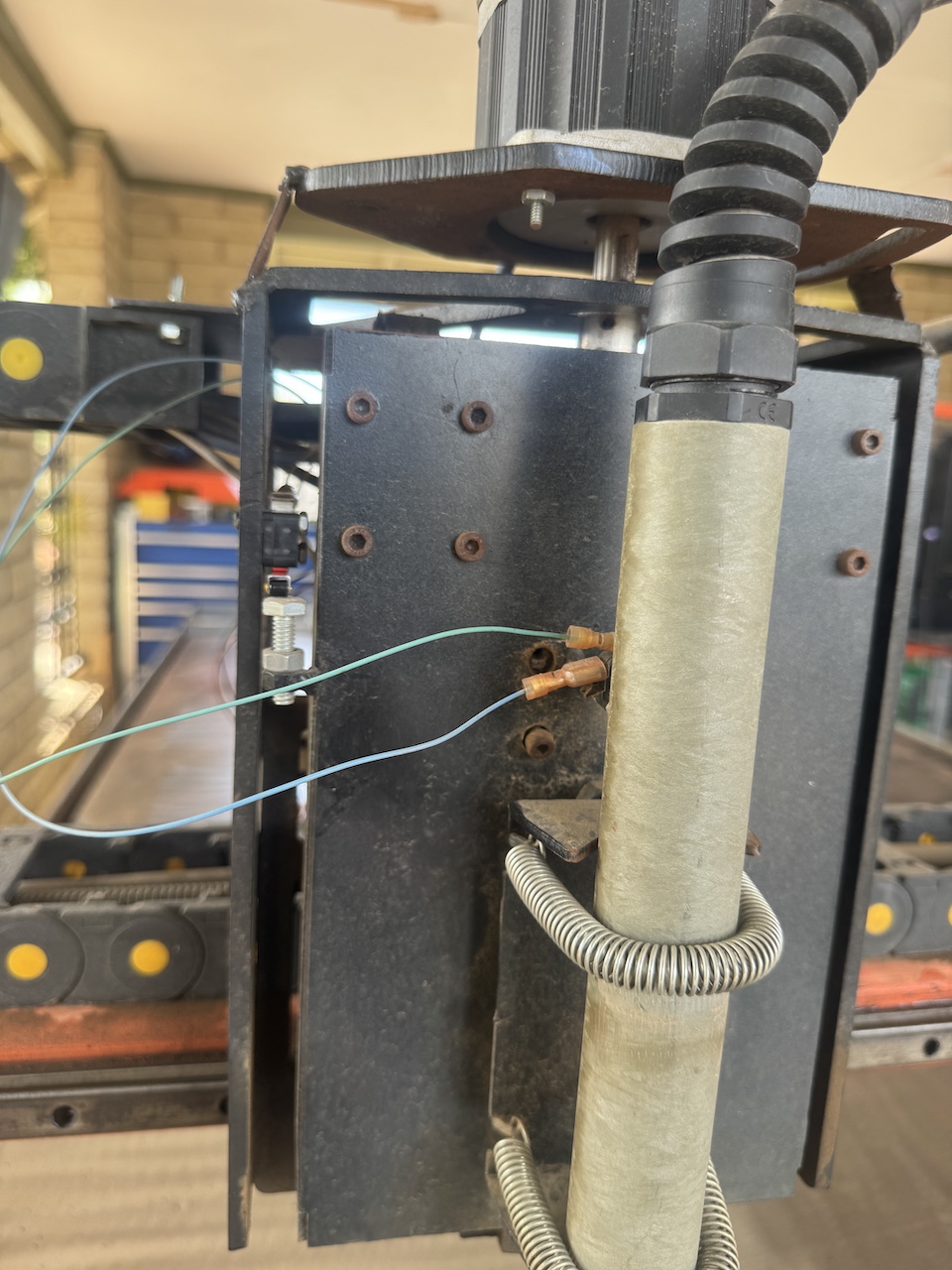

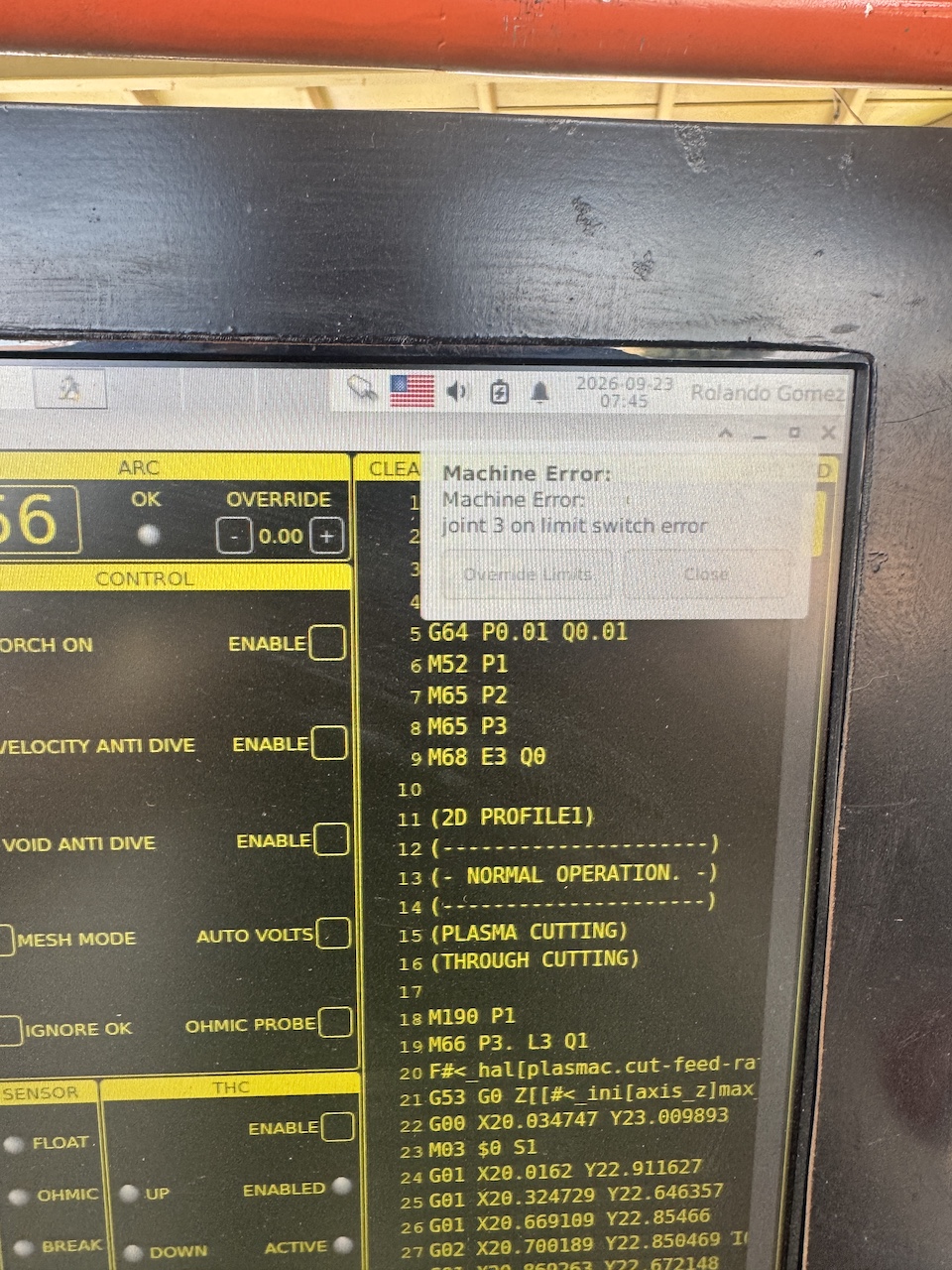

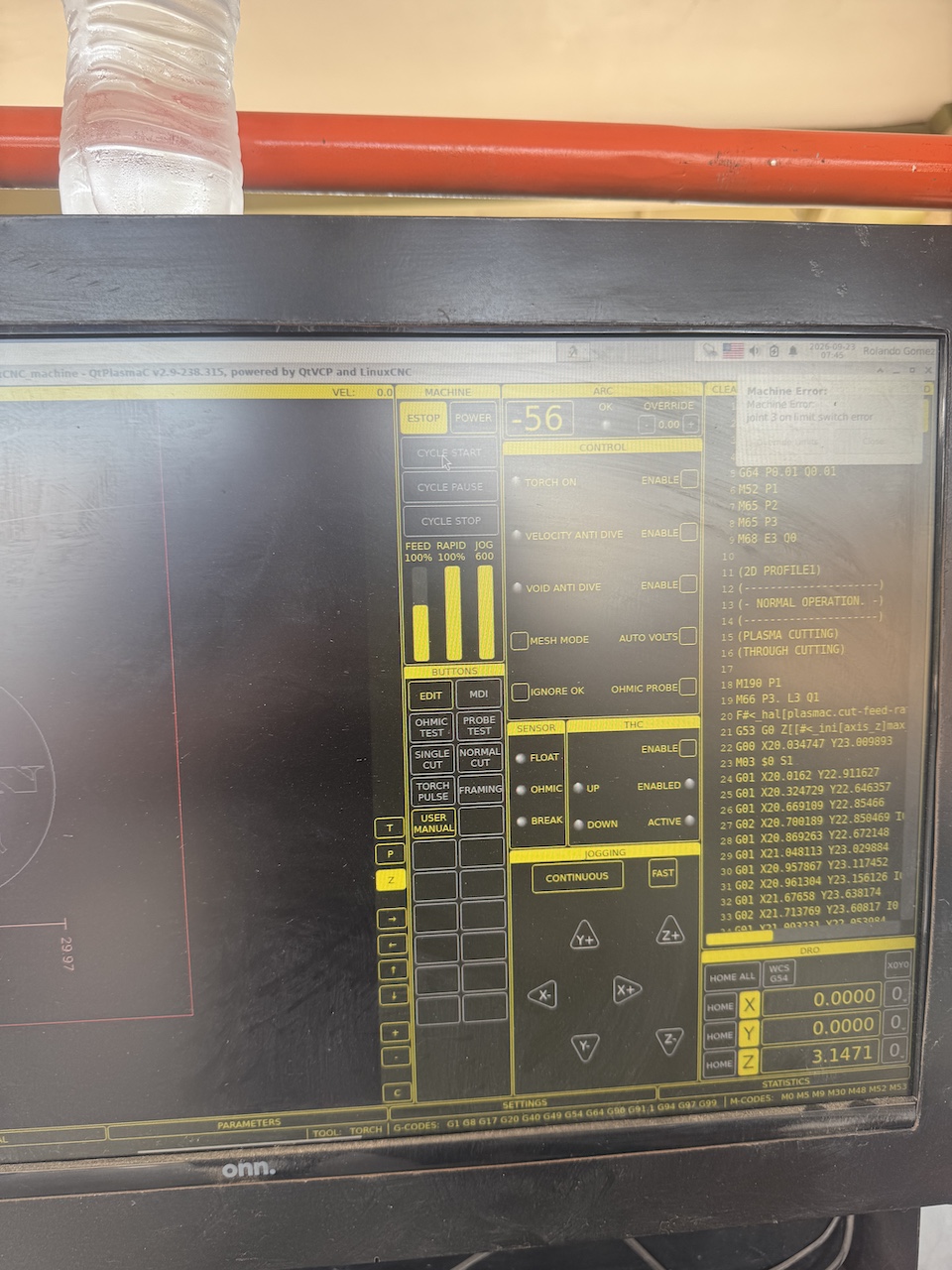

Hello everyone I have a new issue with my plasma table. So after I home my machine, load the file, zero the machine, and click cycle start my z axis torch travels up into the home switch instead of going down and probing the sheet of steel. I ran an mdi comand "g0 z-.5 and when I hit enter the torch moved down -.5 like it should so I dont think anything is reversed. The gcode file I am using worked in the past so im am just at a loss. Is there a certain amount of travel the torch is supposed to go up initially that I could maybe adjust to fix this?

The first move for every cut file is to move the Z axis to 5mm below the top of the Z axis' travel with the following line (for an imperial machine):
linuxcnc.org/docs/stable/html/plasma/qtp...20G%2Dcode%20program .
Also, maybe this diagram helps a bit:
linuxcnc.org/docs/stable/html/plasma/qtp...plasma:initial-setup
I am guessing that either something is up with your mechanicals, or some configuration setting got changed.
Code:
G53 G00 Z[[#<_ini[axis_z]max_limit> - 0.19685] * 1.00000] (Z just below max height)

I dont know much about your setup, but I am guessing that Positive Travel Distance should be 0. It's the distance above the origin that the z axis can travel. So if you homed it in the middle of travel your setup above would allow you to jog 7.5 inches up and 7.5 inches down. I'm guessing your home switch is at the top, and therefore when it finds home it should call that 0 and there is no travel above it. Make sense?
From the docs:
POSITIVE TRAVEL DISTANCE
This is the distance the Axis travels from the Origin to the positive travel distance or the total travel minus the negative travel distance. You would set this to zero if the origin is positioned at the positive limit. The will always be zero or a positive number.
From the docs:

it's not that, zeroing out an axis in G54 offset (the default) wont do anything. the config isn't right. having a positive travel distance tells it there is 7.5 inches above wherever "home" is. the limit switch is at the top of the travel looking at the pictures. The first move is to go up to z max minus 0.196". which instead of being -.196" it's trying to go to 7.304.
This is all in G53 to be clear.
