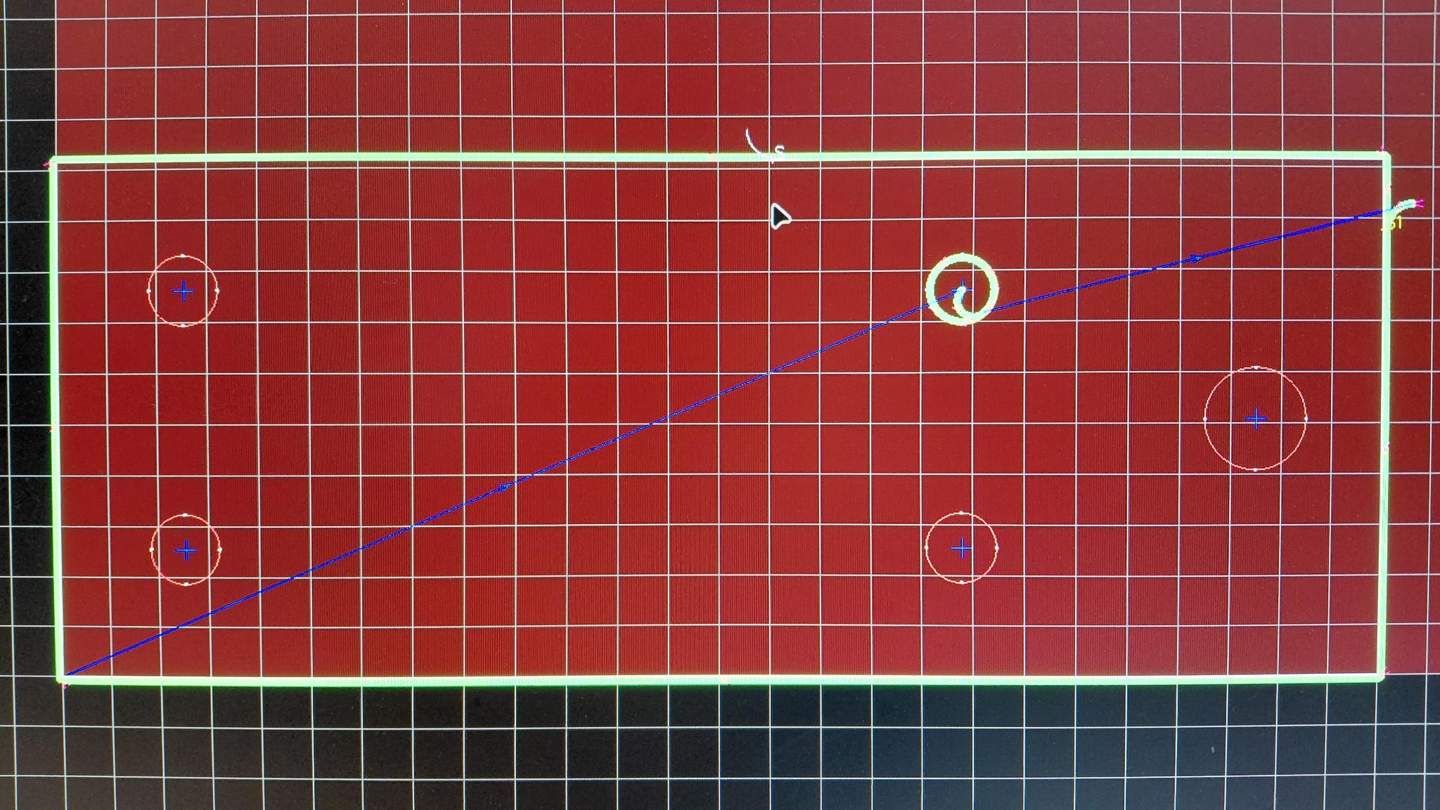

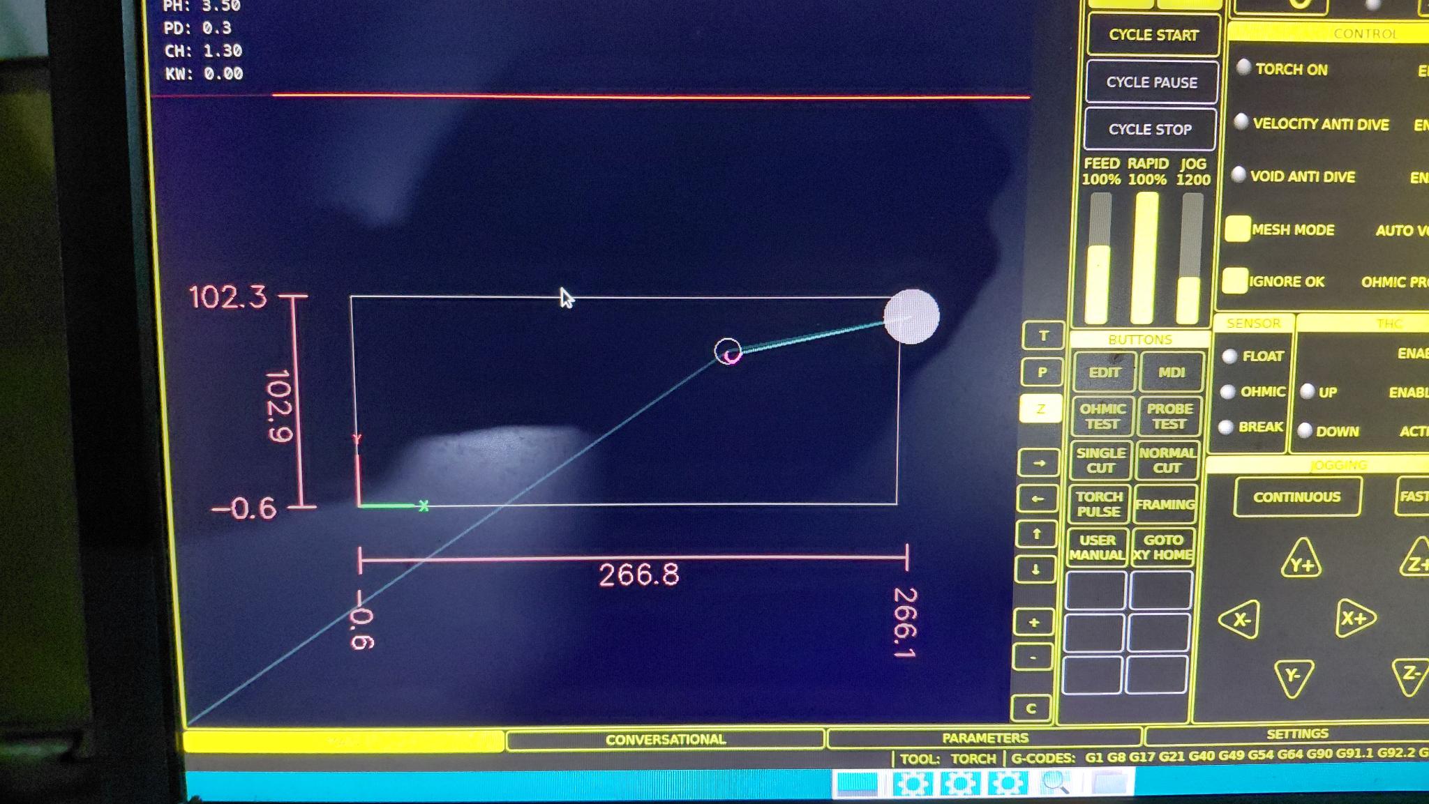

Hi guys,
I'm using QTPlasma 2.9-237.307 Powerd by QtVCP
since a long time, maybe now, it will became a job...
(Let's see)
I'm doing some parts to fix the roof of "my shop", a plate with some holes, and PlasmaC does not want to make one hole... It just start the arc inside the hole and when it touch the real circumference it stops and it jumps to the next shape of the plate... others holes are ok.
Is my code good? It was generated by SheetCam-TNG. I tried to recur (ignore arcok.. mesh.. always the same wrong path)
Any ideas? Thanks!
In the photo you see one hole only, just to test I modified the file, but it shows the same mistaken path as the complete code here:

Sorry, I see now there are other posts about this error... I had some lags in the forum and I could not read them... I'm going to read them now.. I apologize for this thread, in case I don't find a solution I will go back here

I was able to run the GCode above without issue, so I dont think its your GCode

Thanks FabLabRacing,
I upgraded to last version (reinstalled all from new downloaded iso) and, after copying the old config directory, it's now working without that
Thanks, have a nice day,
