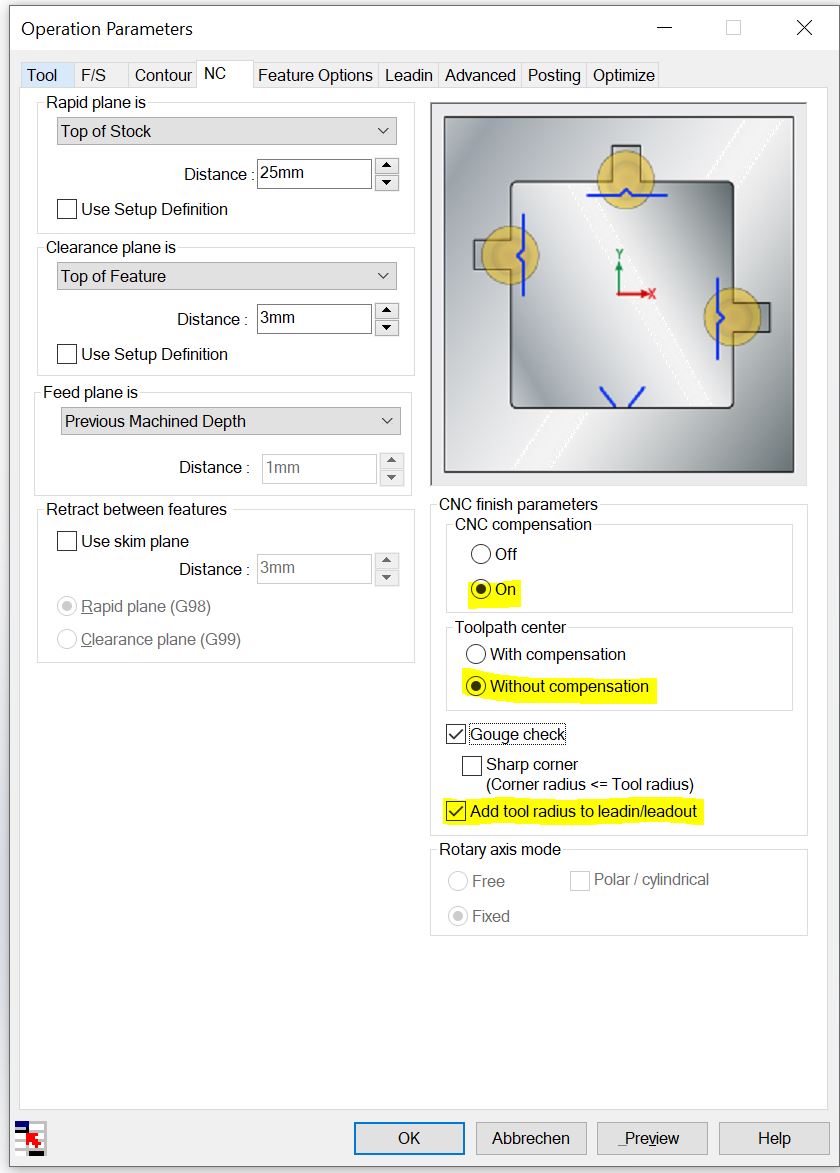

I updated my PP with several smaller bits. The most important is the working compensation part (G41/G42). The old post added a 20 to the pocket number. This didnt work with my tooltable, where T=P number. I removed the addition of 20. To make compensation usable in CAM, make sure to check the following boxes:

I cant troubleshoot a lot because i'm no expert and i abandoned SW again, so just my experience: I often got a error with too small entry moves. I used G41/G42 only on final cuts and sometimes the checkbox "add tool radius to leadin" disengaged even when using my preset.
Are you aware if the checkbox is enabled, and in addition to your regular leadin move, is small enough to fit in your small pocket?
You can also play around with leadin-move-styles: parallel, arc, none. Maybe disengage the checkbox and calculate your leadin fully in its tab as small as possible but as big as needed?

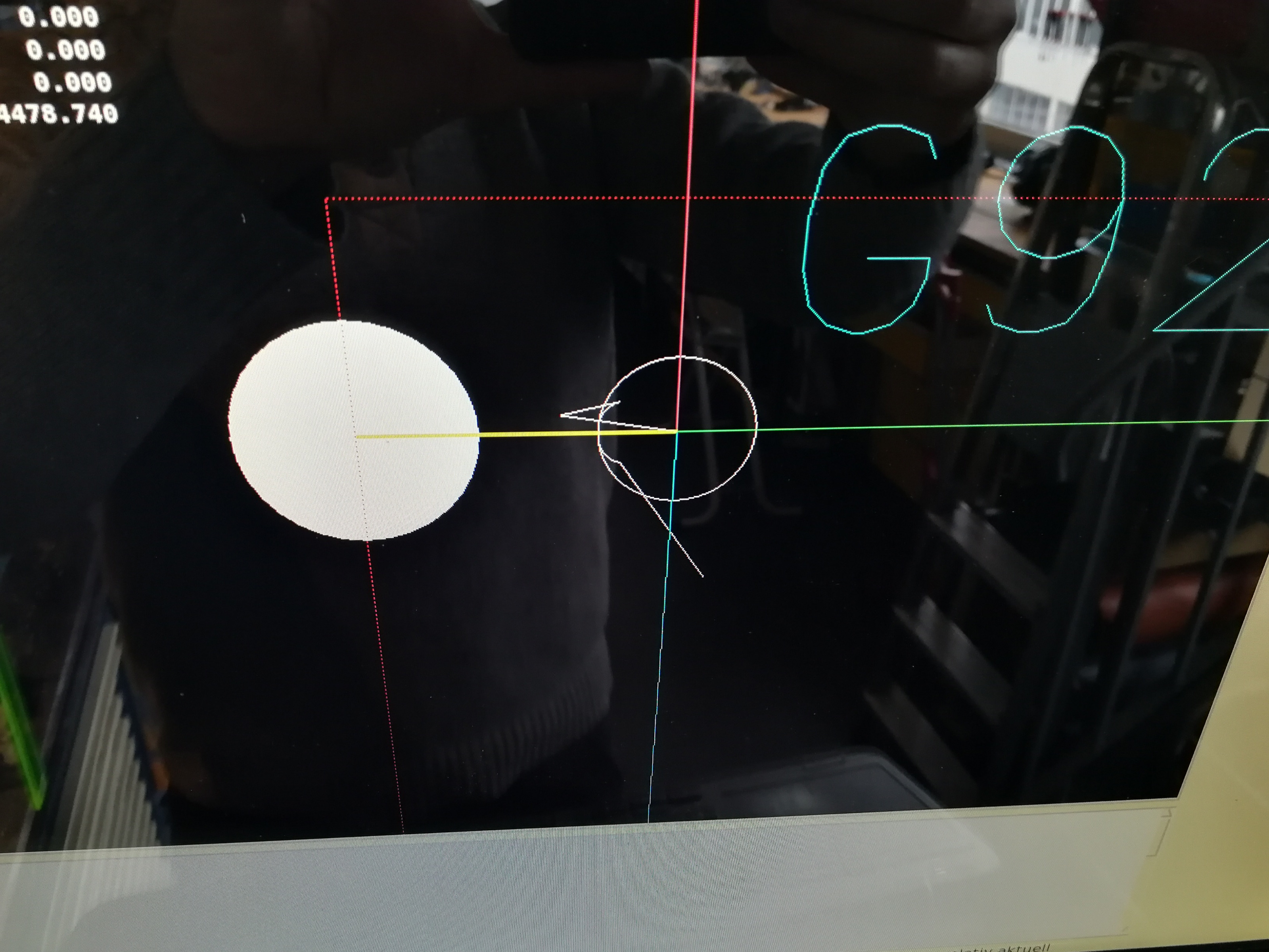

I made some screenshots to better explain the situation:
with all the NC settings set according to Ralfh's post above.
The G-Code looks like this:
( PART NAME=Grundplatte_FS4MG_Test_G41 )
( X 346.00 Y 260.00 Z 15.00 )
G21 G17 G40 G49 G54 G80 G90
G64 P0.2 Q0.01
G53 G1 Z165 F1300 M5
T42 M6 (6mm VHM 4S - Enpro EPC449060)
S3200 M3
M8
G90 G54 G0 X0 Y0
G1 F1300  Z3.
Z-3. F300.
G41 D42 X.907 Y4.487 F225.
X-2.132 Y3.777
G3 X-4.979 Y.599 I.846 J-3.623
X-5.015 Y0 I4.979 J-.599 F300.
I5.015 J0
X-4.979 Y-.599 I5.015 J0
X-2.132 Y-3.777 I3.693 J.444
G40 G1 X.907 Y-4.487
G0 Z3.
Z25.
M9
M30
(0 MIN.  23 SEC. )
What I get in LinuxCNC looks like this:

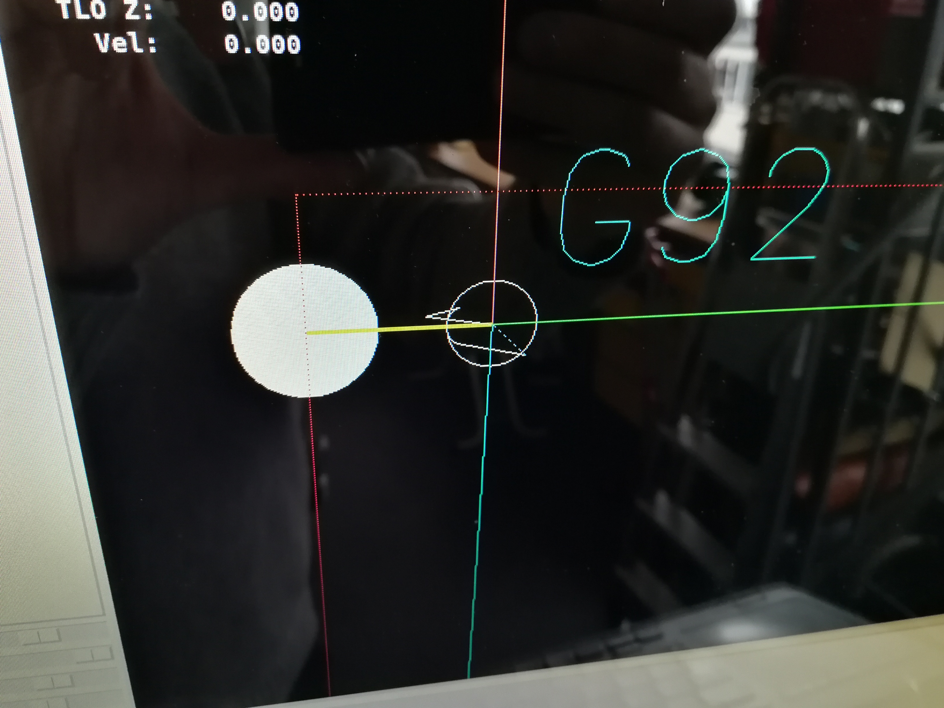

By trying to understand the G-Code I thought the G40 command is too early and should be after the last move with a leadout going back to X0Y0.
Then I get the following:
I tried moving around the G41 command to get better results but it did not work. When reading the code I can't figure out what is not correct? I am very thankful to any hints and help.

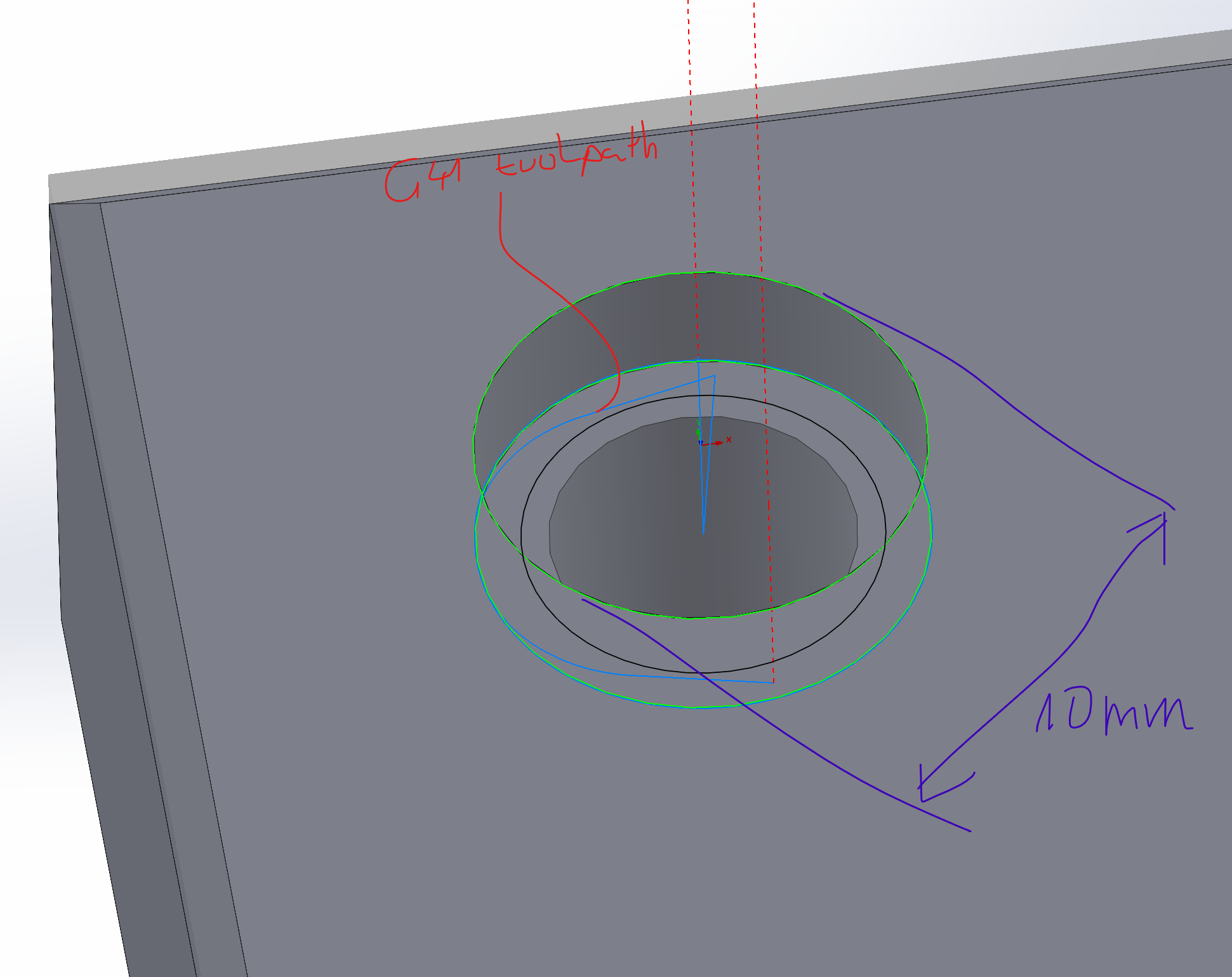

Ah, i see. Please try to cut the hole with a diameter at least half as big as the diameter of the hole.
See: linuxcnc.org/docs/2.6/html/gcode/tool_co...:cutter-compensation
Programming Entry Moves -> The minimum length is the cutter radius
When you want to start at X0Y0 and your entry cut is already >3mm and your endmill radius another 3mm you get a hole of at least 12mm? I don't know exactly
