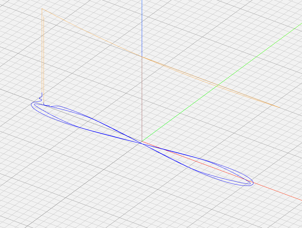

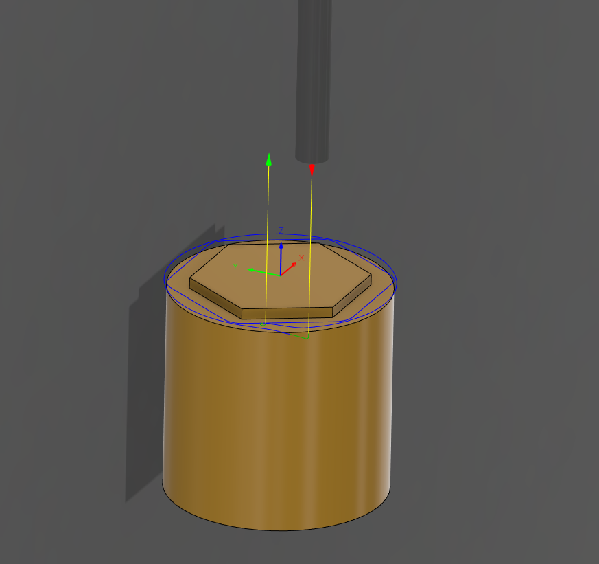

Hi guys
I have a Samsung post processor to use with c axis hexagon milling but can not get it to run properly
the post processor seems to work but when i plot the gcode i don't get the shapes that i want.
I also noticed, that the C-Values in the gcode seem to fluctuate between 10 and -10.
I would have thought that I would get values between 0 and 360?
Attached is my post processor And gcode

I suspect that the only problem is in the plotting / preview and that the actual cut will be fine.
