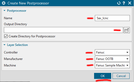

I couldn't find resources to download linuxcnc post and install it in NX CAM. Are there downloadable post available or if we need to build the post manually, are there resources available from official linuxcnc team somewhere?

None of posthub for lcnc, although some of the mach3 posts are still lingering there. Kinda strange.
If you're on post configurator then just create a new fanuc post (ootb). That'll get you 95% up to speed. Slight mods required in the threading/tapping cycles, some more if you use the lathe spindle D (max speed). Other than that it's ready to postprocess as-is.
Let us know if you're stuck, we'll see what we can do for you. gl

Hi sir, I have done it but is showing
" Near line 2 of //
Bad character '\357' used.
for a cavity milling operation.
I am using NX 11.0 and Linux CNC 2.8
" Near line 2 of //

Under the tab "NC Program Manager", select UTF-8 without BOM as your output encoding.
Hope this helps.
Replied by Mecanix on topic linuxcnc post processor for Siemens NX CAM
File -> Utilities -> Customer Defaults -> Manufacturing -> Simulation & VisualizationBad character '\357' used.
Hope this helps.
