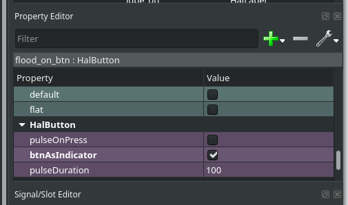

You may have misunderstood my question. What I needed was a way to convert a HalButton to be used as an indicator light reflecting the status of Hal Pins. The way in which the HalButton Widget is written ischecked is simply verified and the widget tries to create a new out pin for the button. So, if say I wanted to see whether the flood out bit is true visually vice True or False in a HalLabel Widget I would have to use a HalLED widget which does not comply with my UI design aesthetics.
So, to make this possible I have made some modifications to the HalButton Widget that allow the button to be used as either an output setter or as an indicator. Works good. I am still ensuring there are no side effects though. Shouldn't be as I have created if statements to allow for original code to work if the option is not set to be an indicator.
It is a tad complicated to wrap around but once you read the code it makes sense.

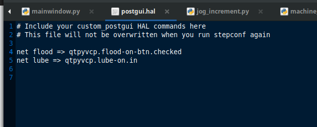

To begin with, you have to set the postgui.hal to net the appropriate signal like so. (Flood used as an example)
net flood => qtpyvcp.flood-on-btn.checked
Here if the flood pin is on it will set the checked value of the HalButton Widget to True else it will be False.
Next you to modify the HalButton Widget as follows: (Entire code is below to hopefully dissolve confusion)

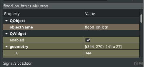

Close and ReOpen QtDesigner through command line>> editvcp your_vcp as normal.
You will see the new property available in the HalButton Property section once the HalButton is inserted into your vcp. Checking the btnAsIndicator will allow for the button to work as an indicator without creating a new Hal Pin.
Set your checked or unchecked styling for the button on an individual basis. Not in the qss file.
Name the HalButton the same as the postgui.hal file noted above.
Save the vcp and postgui.hal file.
Launch your LCNC VCP and check to ensure the indicator works as planned. It should. If not, double check your code and/or button name.
If you launch and LCNC crashes with a hal pin error such as code 4 (pin already exists or something like that) you have not coded correctly as per my instructions and you need to start over verifying each step. Typically, the hal pin in the postgui.hal was set to .out vs .checked. That is important regardless of whether it is a button or indicator. If using it as a normal HalButton you choose .out, .enabled, or .checked. But the result will be different. If as an indicator, .checked is really the best and only option since it will not do anything but light up if the output is on.
Hope that simplifies the solution enough for all. Pics below...

Added btnAsIndicator Setup for HalButton to act as an indicator vs button
You will need to set a stylesheet property for how the indicator will appear when checked for
each HalButton Instance used.

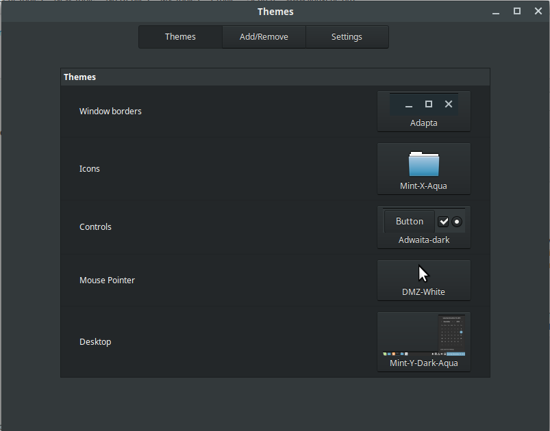

BTW: what Qt theme are you using? Youre UIs look really nice and clean...
Are you planing to share your VCP? What you have done so far is extremely impressive.

Kurt San,
Thanks for the compliment. I am not using a theme per-say. The UI is composed of individual frames styled to appear as individual panels. I will work out a theme file later on. There is supposed to be a shadow effect for each panel but there is an issue where you use stacked panels stacked in a stacked panel messing up the hierarchy with setGraphicEffect. I will work that out soon. Most likely will have to forego the stacked on stacked concept to prevent the setGraphicEffect from throwing an exception as it has no idea which frame to use. Although, I kinda like a flat theme so I may just blow that concept and do it for my next VCP. I have this running on Mint 19.2 using the theme settings shown in the pic attacked.
What I do for a living is develop custom automation solutions for industrial settings where CNC equipment is involved as well as service existing CNC equipment. Although the concept of Qt and using Python is very new to me, the concept of UI development and logic based operations is not. I always work front to back as the UI in the end decides whether a particular apparatus will be utilized to the potential you intend. KISS. Right. But make it easy on the eyes.
I had thought to use the label as you said but felt converting a label to a visual element was bit confusing. My logic made sense at the time. Lol. Regardless either method achieves the desired result and I will consider you idea.
I will be sharing the VCP soon once I have the code DRY'd a bit and know I all the bugs worked out or set up to have exceptions where needed and created the theme via qss. Python tends to force verbose code in some cases but in the end I find it much easier to read than Lua, C, and C++.
So you know my end game, this VCP is a boiler plate for a larger concept that incorporates standard CNC technologies as well as custom GCODES for specialized canned cycles, advanced 3d probing, for kinematics for 3+2 machines and 4+1 machines, high capacity magazines, and a host of others. It will incorporate a OPC-UA client and have modules for ERP(SQL) integration for automating reporting for paperless manufacturing using Lean Manufacturing. I have done this with Fanuc and Siemens with great success and hope to build an solution for those who do not have a spare million to buy a machine with all my options attached breaking the barrier to entry that consumes the lower markets. I suppose it is a humanitarian thing.
Again Thanks for the compliment.
Regards,
Don San
