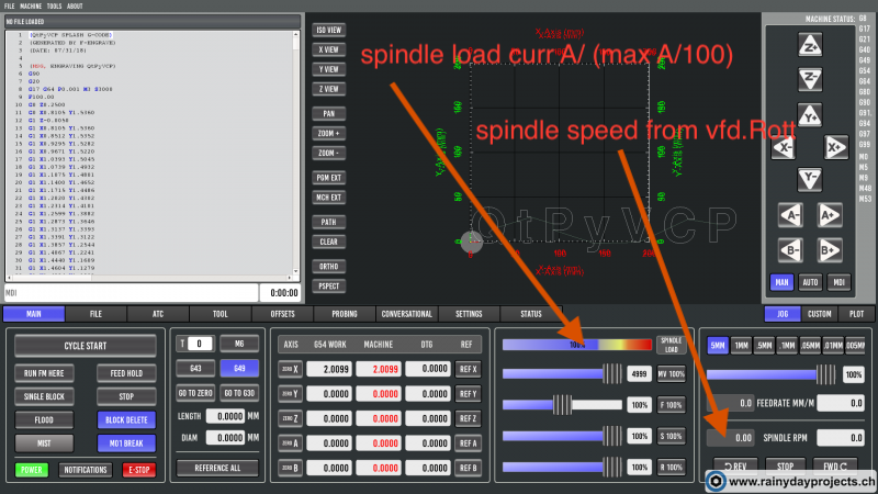

I have my work still in progress to migrate from Mach3 to LinuxCNC. I use the probe__basic VCP. If i set the spindle to a selected speed with M3 S6000 i see in the scree the 6000 in booth fields, te input box and at the left in the commanded speed. I want to set the hal to show me the commanded speed in the readonly input box and the real speed, reported from the VFD in the left. Same with spindle load. Where i can defene the 100% (eg. 8.5A) and the feedback from the VFD?
vfd.Rott is the reported real RPM from the spindle
vfd.rated-motor-current is the AMPS that the spindle currently consume.
How i can check the halui variables where i can use? The spindle load i completely missed.
My clue to do that, don't work:.
I am so lame
Still can't get the concept behind the Hardware Pins (input, output) from the modules (that i got, hm2_7i76e is a module with pins), and the HAL. How it works and where i need to screw when i want something. As example i want to negate a digital output so it is on at the start of LinuxCNC. Its an enable the should be on to disable a leadshine driver and if i want to enable it i need to open the output. Its hairpulling for me to be so helpless.
This won't work also:
Is there a presentation or a video out there where i can try to follow the design and concept of LinuxCNC?
Thanks a million for any clue.

Ok, then you need to make sure the feedbacks for those items are connected to your GUI. I am not familiar with QtPyVCP. or the Probe Basic GUI. Configuring the spindle speed feedback should be as simple as connecting the correct hal pins. (Not sure what they might be, try looking them up with Halshow.
I don't know if there is any provision for displaying spindle amps. You may have to customize the GUI to add that feature. But you could look at the value with Halmeter or Halshow. (I think the hal pin might be vfd.OutA)

I searched and searched and searched. Halshow, the Internet and i did not find any clue. It looks like the Spindle Load Widget is not wired to any hal.pin ;(
It is true?

The SpindleLoad widget in ProbeBasic does not create any HAL pins. It needs to be updated with the new HAL enabled bar indicator widget. We will try to get it updated before the next release of ProbeBasic.
