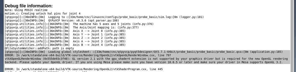

17 Sep 2020 19:36 - 17 Sep 2020 19:37 #182565
by Mara2000
Replied by Mara2000 on topic Probe basic setting new machine
after clean install Linux CNC 2.8 and Probe basic, when i start Probe basic sim then this error appear:

File "/home/cnc/qtpyvcp/pyqt5designer/Qt5.7.1-64bit/probe_basic/widgets/atc_widget/atc.py", line 47, in __init__
self.pocket_slots = int(INIFILE.find("ATC", "POCKETS")) or 12
TypeError: int() argument must be a string or a number, not 'NoneType'
Thank you for help!
Thank you for help!
Last edit: 17 Sep 2020 19:37 by Mara2000.

oops thats a bug
if you want to workarround it while i fix
add
to your ini
add
[ATC]
POCKETS=12Please Log in or Create an account to join the conversation.

try
pip install --upgrade vtkPlease Log in or Create an account to join the conversation.

just updated with:
...added to INI:
[ATC]
POCKETS=12
.... and still error apeared:

File "/usr/lib/python2.7/dist-packages/PyQt5/uic/uiparser.py", line 503, in createLayout
self.traverseWidgetTree(elem)
File "/usr/lib/python2.7/dist-packages/PyQt5/uic/uiparser.py", line 806, in traverseWidgetTree
handler(self, child)
File "/usr/lib/python2.7/dist-packages/PyQt5/uic/uiparser.py", line 546, in handleItem
File "/usr/lib/python2.7/dist-packages/PyQt5/uic/uiparser.py", line 273, in createWidget
File "/usr/lib/python2.7/dist-packages/PyQt5/uic/uiparser.py", line 264, in createWidget
self.stack.push(self.setupObject(widget_class, parent, elem))
File "/usr/lib/python2.7/dist-packages/PyQt5/uic/uiparser.py", line 228, in setupObject
obj = self.factory.createQObject(clsname, name, args, is_attribute)
File "/usr/lib/python2.7/dist-packages/PyQt5/uic/objcreator.py", line 100, in createQObject
factory = self.findQObjectType(classname)
File "/usr/lib/python2.7/dist-packages/PyQt5/uic/objcreator.py", line 125, in findQObjectType
w = module.search(classname)
File "/usr/lib/python2.7/dist-packages/PyQt5/uic/Loader/qobjectcreator.py", line 113, in search
module = __import__(mname, {}, {}, (cls,))
ImportError: No module named dro_label
Thank you
- TurBoss
- Posts: 134
- Thank you received: 81
26 Sep 2020 19:35 #183873
by TurBoss
Replied by TurBoss on topic Probe basic setting new machine
Hello,
did you ran the script located at "pyqt5designer/Qt5.7.1-64bit"
github.com/kcjengr/qtpyvcp/tree/master/p...signer/Qt5.7.1-64bit
Installing Designer Libs
These libraries have been tested to work in Debian 9 (stretch) Mint 19.1 and Ubuntu 18.04. They will likely work on other systems as well.
To install simply run:
sudo ./install.sh
sudo ./install.sh
The following user(s) said Thank You: Mara2000
