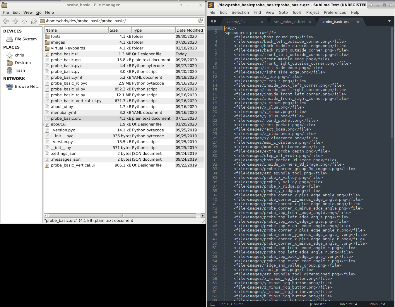

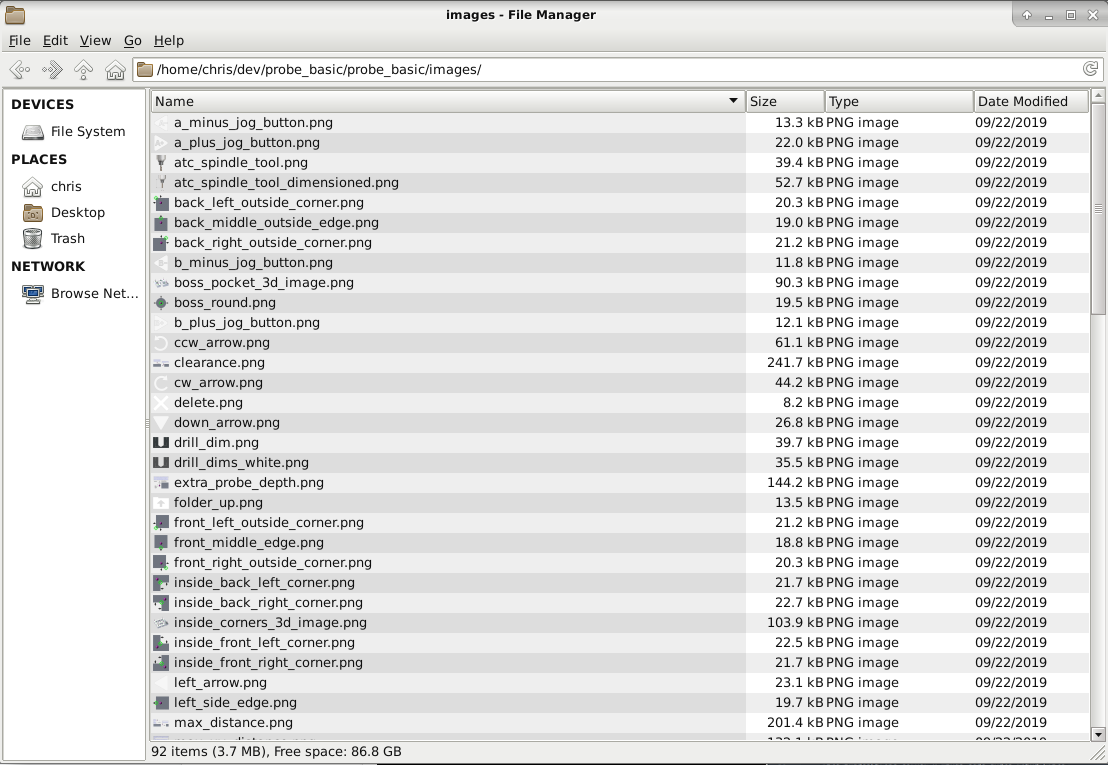

adding graphics requires the graphics to be in a directory specified for images with the correct path, you also need to add the image file path to the .qrc file, then you need to compile.

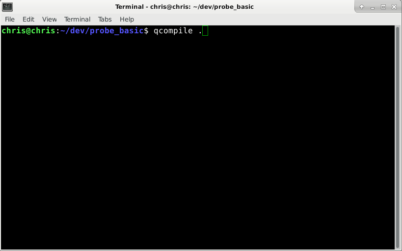

02 Feb 2021 20:53 #197519 by Lcvette
you need to place the label where you want it, then select it and in the property editor under QLabel/test/pixmap there is a drop down manu, select "choose resource" then in the new window that opens click on images, then select your image and click OK should be there, then you shouod run . qcompile and check your ui it should be there!
