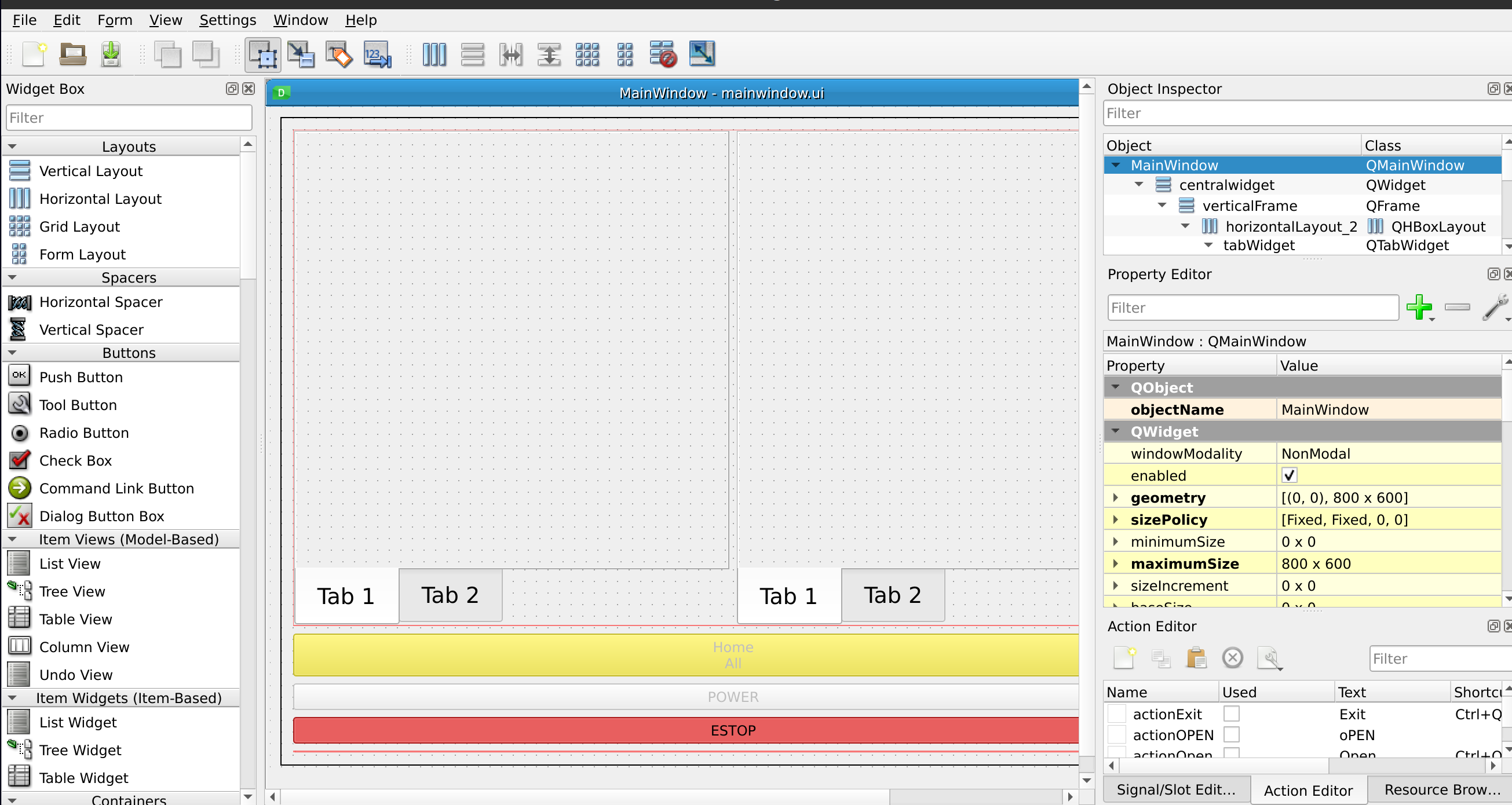

editvcp probe basic - Error was created by Donb9261
don@don-Debian:~$ editvcp probe_basic
Loading YAML config file: /home/don/probe_basic/probe_basic/probe_basic.yml
Loading UI file: /home/don/probe_basic/probe_basic/probe_basic.ui
Loading QSS file: /home/don/probe_basic/probe_basic/probe_basic.qss
Starting QtDesigner ...
ERROR: It appears QtDesigner is trying to load the QtPyVCP widgets
using a python version greater than 2.7, this is not supported.
Make sure that you have the correct version of the libpyqt5.so
file in /usr/lib/x86_64-linux-gnu/qt5/plugins/designer/, see the
Installation Trouble Shooting section of the QtPyVCP Documents for more info.
Also, I am having issues simply starting the Probe Basic config in LCNC. Getting an error:
Debug file information:
Note: Using POSIX realtime

- Donb9261
- Posts: 169
- Thank you received: 103
05 Jan 2022 20:51 #230924
by Donb9261
Replied by Donb9261 on topic editvcp probe basic - Error
I do believe this is the issue. But not positive.
Happens when installing the compiled files for probe basic.
Installing collected packages: qtpyvcp, probe-basic
Attempting uninstall: qtpyvcp
Found existing installation: qtpyvcp python3-master-144.g82f25ff8
Uninstalling qtpyvcp-python3-master-144.g82f25ff8:
Successfully uninstalled qtpyvcp-python3-master-144.g82f25ff8
Running setup.py develop for probe-basic
Successfully installed probe-basic qtpyvcp-0.3.19
Because now none my VCP's will load and get the same error when launching LCNC. NameError: name 'basestring' is not defined

05 Jan 2022 21:30 #230925
by Donb9261
Yep...
That is the issue.... Probe Basic uses 0.3.19 and not master.
ERROR: pip's dependency resolver does not currently take into account all the packages that are installed. This behaviour is the source of the following dependency conflicts.
probe-basic 0.4.0+7.g5813f91 requires qtpyvcp>=0.3.9, but you have qtpyvcp python3-master-146.g1ff9e4e9 which is incompatible.
