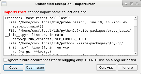

On a fresh install (2.8.2.11) from the updated Debian 10 Buster PREEMPT-RT ISO installation of the Probe Basic v0.x.x packaged failes with the error cannot import name collections_abc.
The failure is the same from version v0.3.4 until 0.4.0,
Find attached a screenshot and the relevant report files.
Any ideas?
Any ideas?

The issue is solved - at least for my installation:
Even the version did not change, after the installation ProbeBasic is working again (testet with v0.4.0)
- pip show six
Version: 1.16.0
Summary: Python 2 and 3 compatibility utilities
Home-page: https://github.com/benjaminp/six
Author: Benjamin Peterson
Author-email: benjamin@python.org
License: MIT
Location: /home/cnc/.local/lib/python3.7/site-packages
Requires:
Required-by: pyudev- pip install -U six
Collecting six
Downloading https://files.pythonhosted.org/packages/d9/5a/e7c31adbe875f2abbb91bd84cf2dc52d792b5a01506781dbcf25c91daf11/six-1.16.0-py2.py3-none-any.whl
Installing collected packages: six
Successfully installed six-1.16.0Even the version did not change, after the installation ProbeBasic is working again (testet with v0.4.0)

try to follow these steps:
- open a shell window or do it directly on the console (thats what windows calls a "command prompt")
- just type pip -V
- you should get a reply like "pip 18.1 from /usr/lib/python2.7/dist-packages/pip (python 2.7"
That shows you , the pip command is available - type pip show six - the output should be like I mentioned in my 2nd post
- type pip install -U six - this should be install/reinstall the missing/wrong libraries
- start linuxcnc again

That did it, everything works now!.
