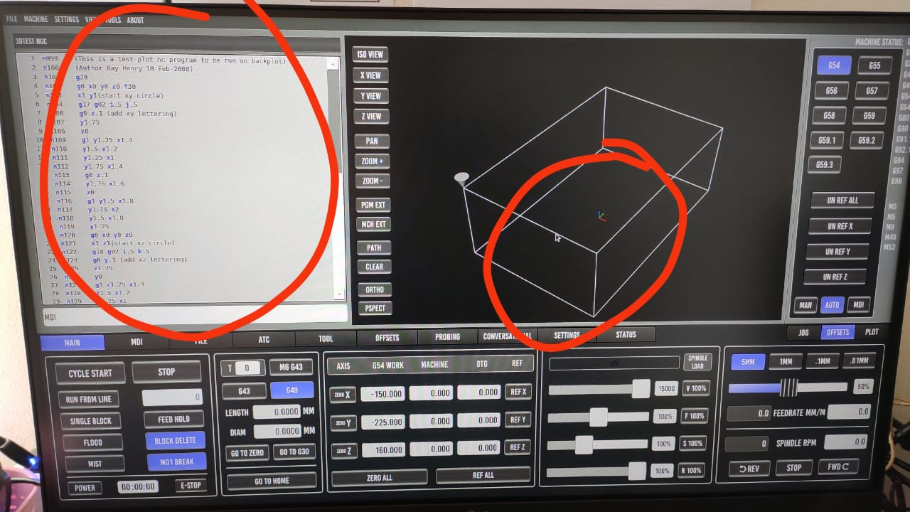

Help i have 2 machine with Probe basic, both using Mesa 7i96, i have problem with 2nd machine, i m using Buster 2.8.2, the problem is "Program Screen" not showing when i load g code. anyone can help where is problem?

Hi.
Have you tried a simple gcode for testing ?
e.g.
G1 X10 F500
G1 Y10
G1 X0 Y0
M2
Do you have any logfile?
Best regards,
Thomas

this is currently a known issue and is partially tied to the status bug in linuxcnc which is being looked into. some pc's can interpret the backplotter fine and others do not, i have 4 test pc's and one of them has the same issue, the others are fine so it is quite difficult to troubleshoot.
