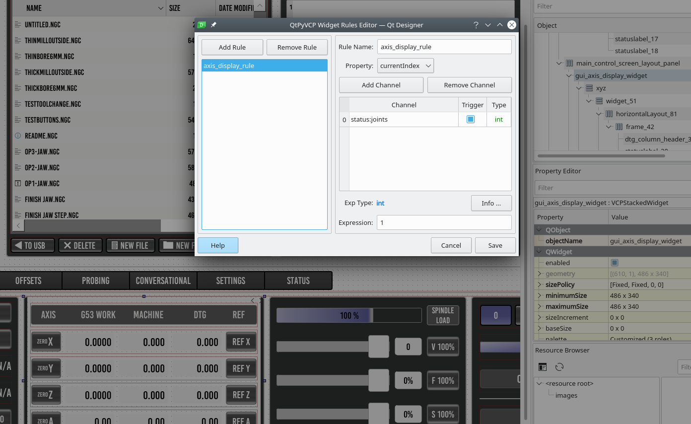

- brandon0112
- Posts: 6
26 Oct 2022 06:00 #255081
by brandon0112
Replied by brandon0112 on topic Probe Basic Configuration
Hi All,
This thread was the only one I could find that addressed this A axis DRO issue in PB. I just recently did a fresh install of lcnc 2.9_pre0 and PB using joco's script. I also installed this on the linked Bullseye iso from that script.
Has anyone else run into this problem again since the original post in August? I am still experiencing this issue even after trying the fix that charleyann found. Additionally, when I changed the axis display rule from axes to joints to try the fix, I was not allowed to change it back to axes.
Any help would be greatly appreciated!

- charleyann
- Posts: 30
- Thank you received: 10
10 Nov 2022 14:48 #256357
by charleyann
Replied by charleyann on topic Probe Basic Configuration
The following user(s) said Thank You: spumco, brandon0112
- brandon0112
- Posts: 6
05 Jan 2023 07:52 #260983
by brandon0112
Big thanks, charleyann! Changing the expression brought the A axis DRO out for me!
