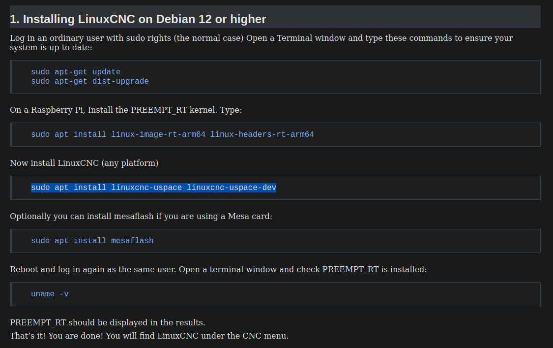

I did installed Debian 12 from scratch. But it seems it doesnt have a RT Kernel. My Probe GUI is working, but my MAX Jitter is more than 1000x higher usually it was 9000 ns - now it's 12,000,000 ns [12 milion ns] ( Is this acceptable?)
If not acceptable, how should I perform probe instalation on the original ISO provided by linuxcnc? (With Debian10 + 2.8 linuxcnc)

I thought the rt kernel was a dependency, did you reboot after installation?

There is an Installer for Debian 12 (still a work in progress) here
forum.linuxcnc.org/9-installing-linuxcnc...or-linuxcnc-x86-only
This includes all of the repositories for QTPYVCP and Ethercat already set up so its easy to install them if you want to go that way.
Once I finish with the pi imager (which is as good as done), I will go back and tidy it up.
Replied by rodw on topic Why so difficult?
Yes, it is on AMD64 but for some reason on the Pi you need to install the RT kernel manually. Otherwise the install process is the same on x86 and the pi.I thought the rt kernel was a dependency, did you reboot after installation?
