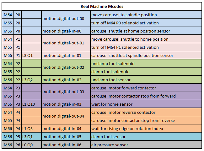

- Lcvette
- Posts: 1682
- Thank you received: 784
28 Dec 2023 08:57 #289251
by Lcvette
Replied by Lcvette on topic M64 Connection to hal
The M66 P# you are using is a motion.digital pin and should be assigned to the net carousel-home-sensor-input (or whatever you named it) and appropriate mesa physical pin input. This is what tells the macro the hone switch has been detected and shuts off the carousel motor rotation with a M65 P# and allows the homing macro to continue to the next step. Seems somewhere your connections are not passing.
You should nake a little spreadsheet that defines all of your macro IO's so you can make sure the hal is properly connected and the macros make sense.
Mine is below for reference only and my system does not uae carousel comp, vut i would imagine its the same or similar.
