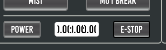

New install of PB and have a couple problems with the program timer.
First, I get an error on startup when I connect qtpyvcp.timerseconds.in (or minutes/hours) to the time.comp pins.
According to the LCNC docs (and halshow), time.comp creates u32 pins, but the qtpyvcp pins are floats:
Second, the clock/timer display is distorted. Stylesheet in pb.ui shows it's supposed to be 17pt font, but this seems to be too large.
I seem to recall something quite some time ago about why this is happening, but searcing the qtpyvcp page and everywhere else hasn't turned up anything.
Anybody remember why it's distorted?

Something appears to be hosed up in my PB or QtPyVCP installation.
I found the file which creates the timer hal pins - probe_basic_ui.py - and that file is supposed to create u32 pins, not floats.
And same-same for timerminutes & timerseconds. But... when I start either my config or the sim configs QtPyVCP creates float pins.
My PB sim timer on a Windows VM is working, but not the live machine. And the VM sim's timer is displayed correctly.
I made a couple minor edits to the probe_basic.ui file, but that was just changing the ATC button M-code numbers. Certainly didn't touch the py file or anything but the ui file. And switching back to the 'stock' ui file results in the same behavior for both my config and the sim.
I don't think I did something dumb and install PB twice and my config is looking in an odd place with an edited ui.py file. Probe_basic_ui.py has the same modified date as all the rest of the files in /lib/python3/dist-packages/probe_basic/
What would cause LCNC to ignore the QtPyVCP/Probe Basic python instruction?
self.timerhours.setProperty("pinType", HalLabel.u32)And same-same for timerminutes & timerseconds. But... when I start either my config or the sim configs QtPyVCP creates float pins.

Well, Linux backstage nonsense strikes again.
It appears that flippantly ignoring a GPG key thingie error during installation caused LCNC not to update/install properly. LCNC was starting and running, so why worry?
sudo apt update revealed a GPG error.
Once I fixed that by editing the repository to buildbot2, adding the GPG key file, and doing another update/upgrade, both the timer hal pins and the display were magically fixed.
