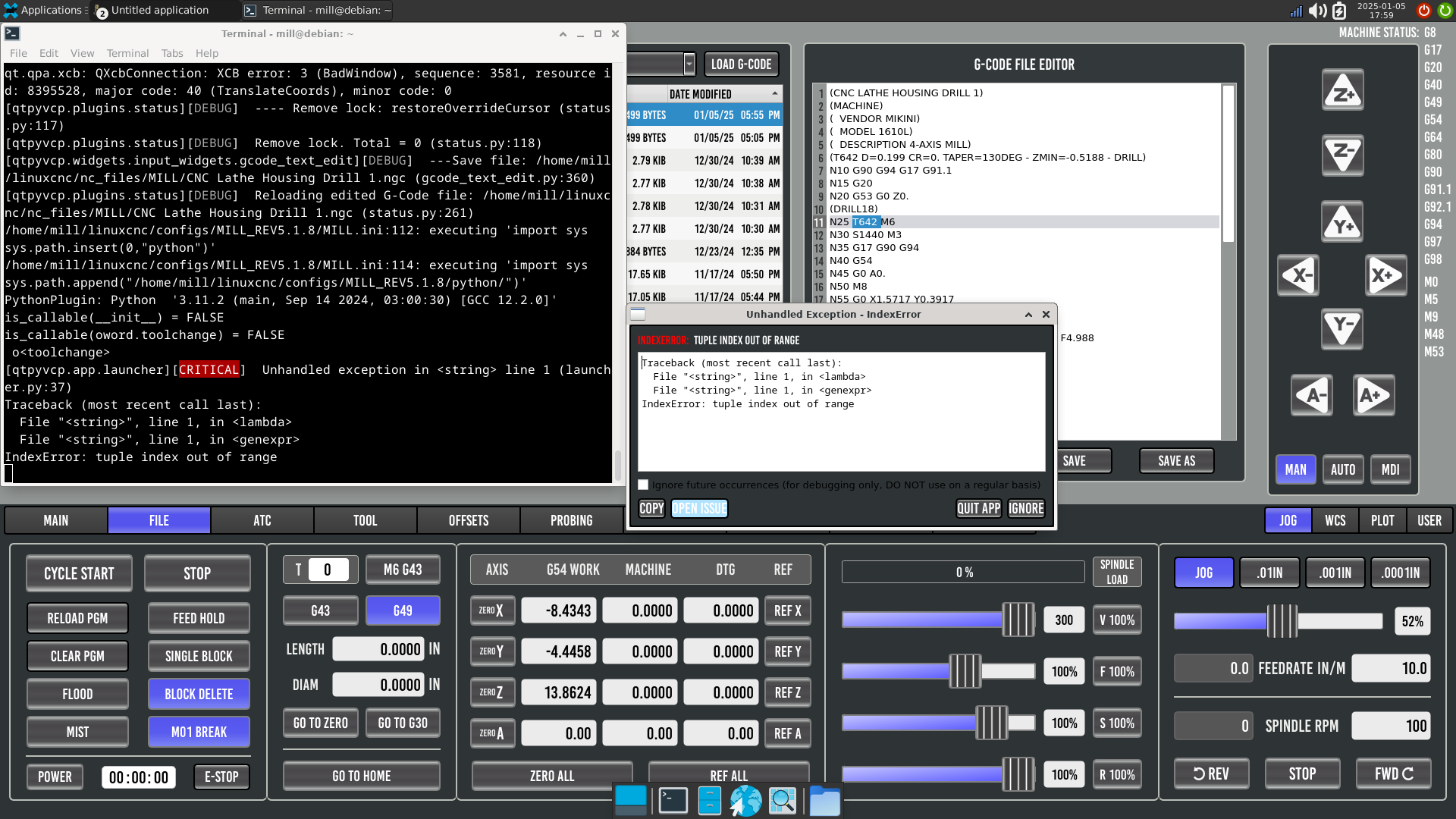

05 Jan 2025 23:08 #318178
by spumco
Replied by spumco on topic probe basic - toolpath/file preview loading error
Ive circled back to this after getting annoyed with renumbering my tools for every program.
I've updated to 2.10 since the last time. (LINUXCNC - 2.10.0-pre0-3745-g8102217123)
I renamed interpret.py and grabbed the latest version from GH (with the 'fix') and put it in the same folder.
Unfortunately, I'm still getting the same error. Same thing - any tool number >199 causes the error. Changing the tool(s) to a lower number makes the error go away.
Is there something else I should do to patch, or maybe the patch isn't working?

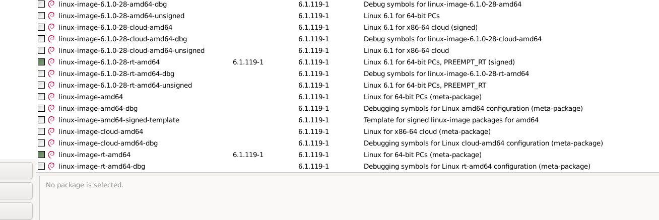

07 Jan 2025 15:26 #318303
by Lcvette
Replied by Lcvette on topic probe basic - toolpath/file preview loading error
i just did an install yesterday on one of my machines, my method of choice is how i listed it in the docs here:
kcjengr.github.io/probe_basic/development_quick_start_apt.html
thing of note, i had to go into the synaptic package manager after install and manually change to the preempt rt kernel as shown below, just search for linux-image in synaptic to bring up the different kernels. i also like to remove any unused or older kernels on my machine pc's once i have fully tested updated kernels.
