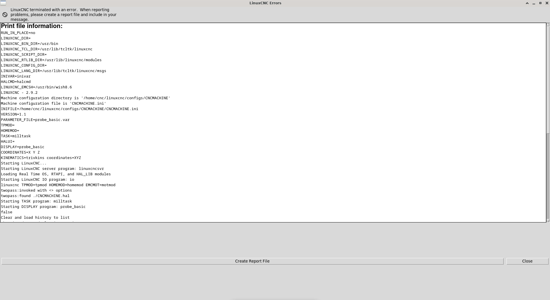

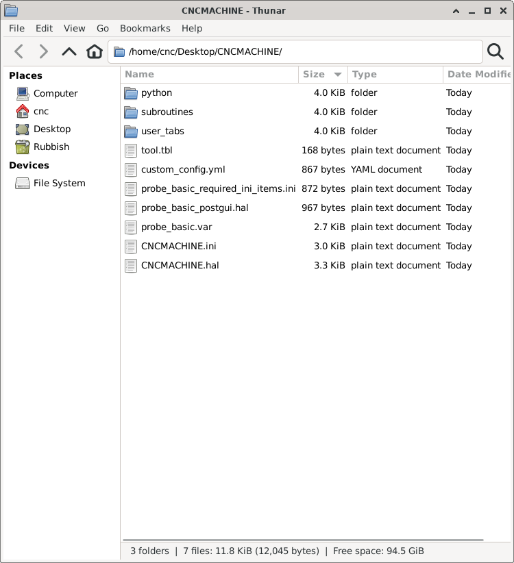

Ok, So followed the guide from square one, installed Probe_basic and QTPyVCP from scratch and have the sims working fine, Created a new config using Step Config in Axis and had that working fine...
Followed the guide on Github word for word (At least I think so) and am now getting errors, I haven't changed or added / subtracted anything. this is as it from following the guide. Included in my .ini .hal and the error report and a screen shot of my config folder to see what Files I have in there

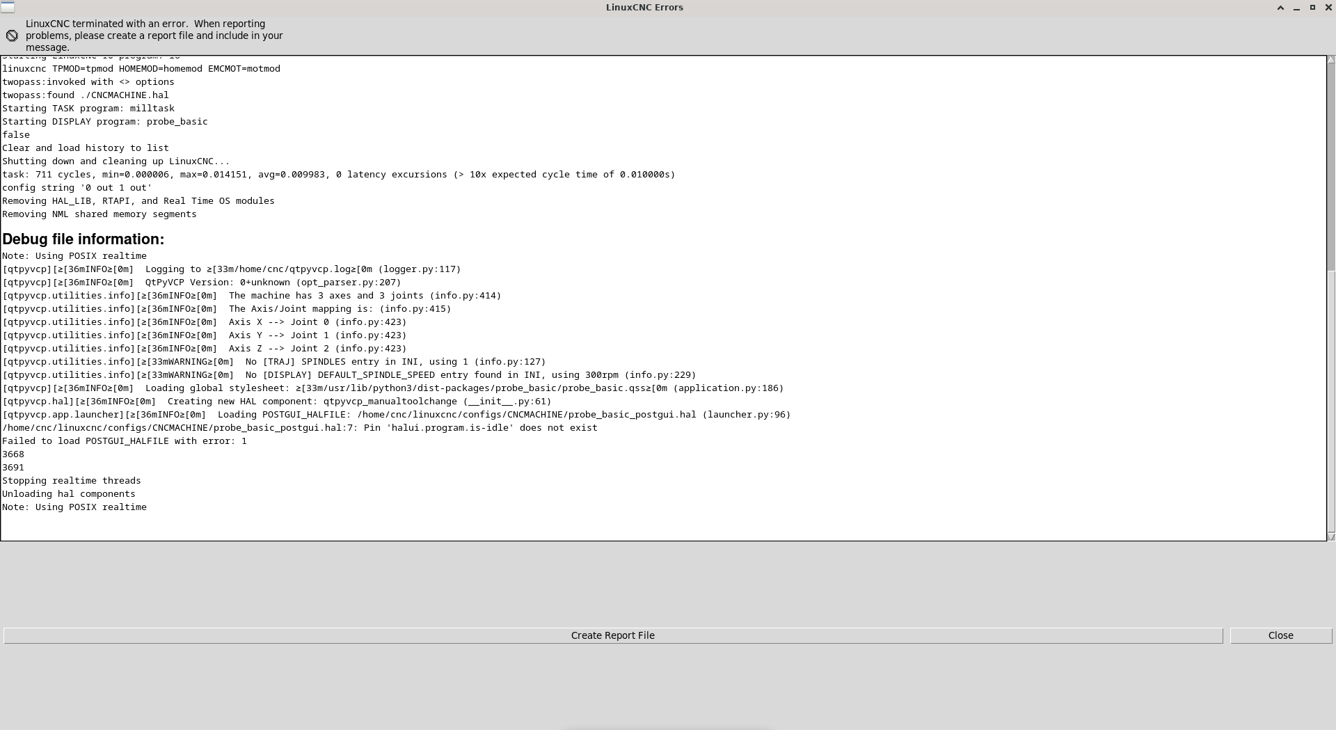

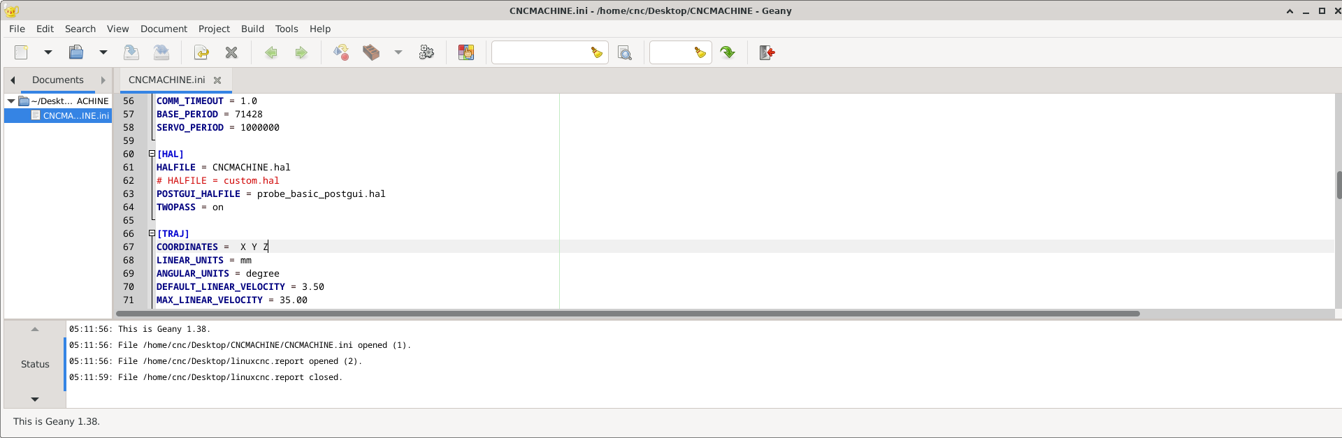

Reading through the error I saw (twopass:CANNOT FIND FILE FOR:custom.hal) line and saw that custom.hal is not in the example so I commented that out in my .ini and get this error log now

Missing pin in the probe.....postgui file.
Click on "create report" on the error screen, then upload that here, makes it easier to copy/paste exact lines.

From the error report:
/home/cnc/linuxcnc/configs/CNCMACHINE/probe_basic_postgui.hal:7: Pin 'halui.program.is-idle' does not existPlease Log in or Create an account to join the conversation.
