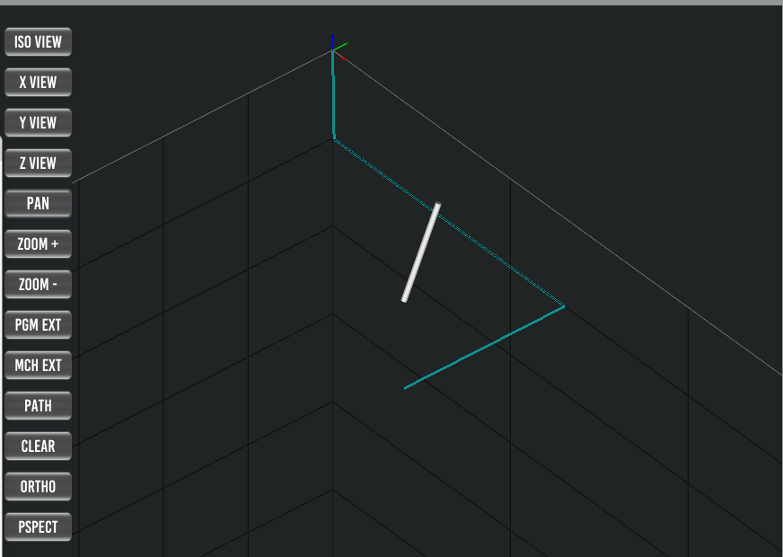

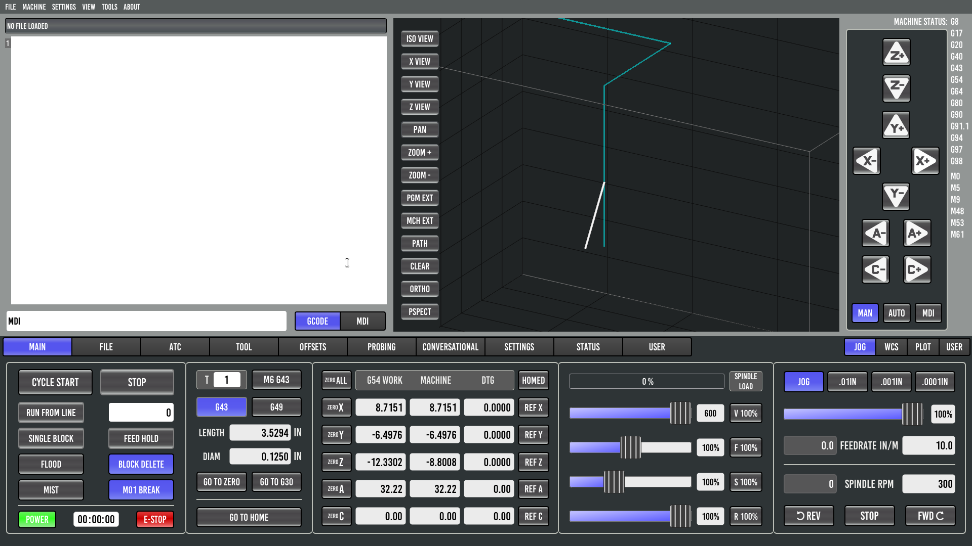

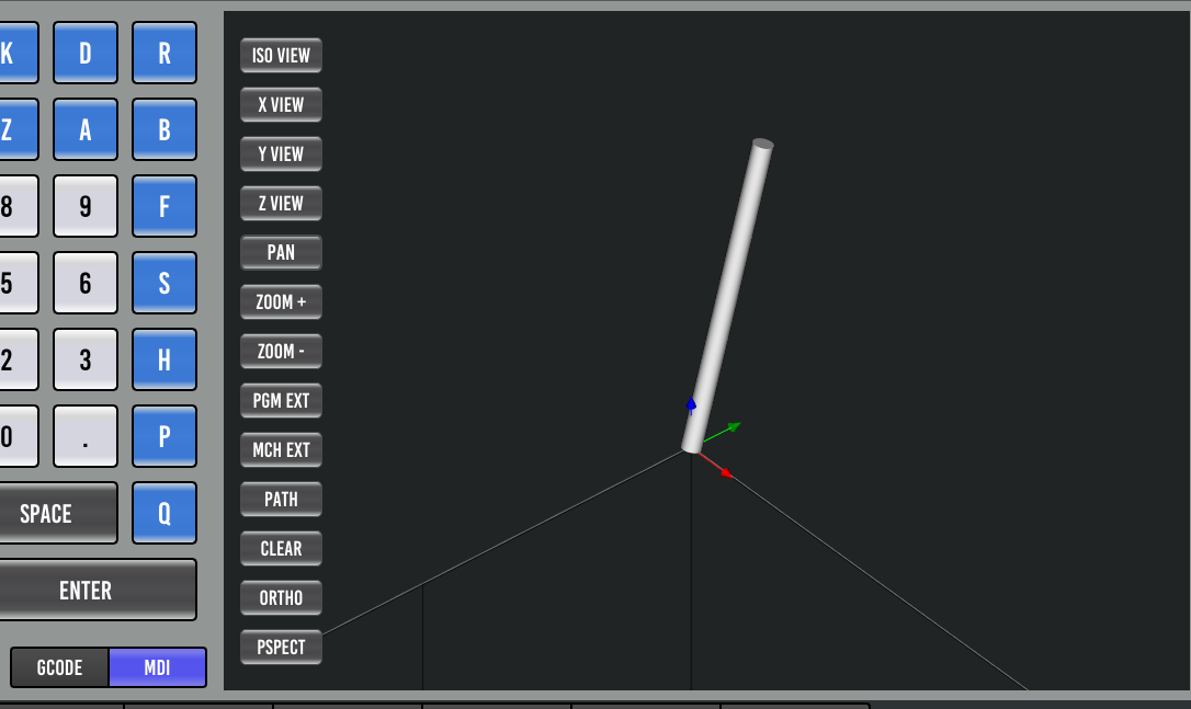

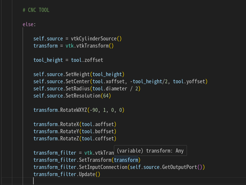

I found some code in tool_actor.py
I changed
transform.RotateWXYZ(90, 1, 0, 0) to transform.RotateWXYZ(-90, 1, 0, 0)
The tool module's origin will change to bottom
and tool will rotate in right point
but, if G43, the path will draw wrongimage missing /media/kunena/emoticons/sad.png
I have poor Engilsh, and just have a little coding, forgive meimage missing /media/kunena/emoticons/cheerful.png
Tim
I changed

1 year 11 months ago #314600
by Lcvette
Replied by Lcvette on topic probe basic tool direction
if you are on the develop branch, the latest update has fixed the 5 axis plotter now!

1 year 11 months ago #314653
by Tim Bee
Replied by Tim Bee on topic probe basic tool direction
@Lcvette
It's work! Thank you

1 year 11 months ago #314757
by Lcvette
The Thanks belong to @Turboss, he is the VTK dragon slayer! I muddled about in it for 2 days trying to find and resolve the issue and he came in and fixed in an hour...lol he also wrote it so knows it a bit better than anyone else!
glad its all working!
