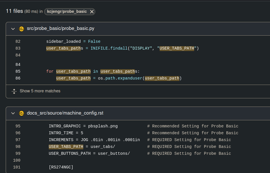

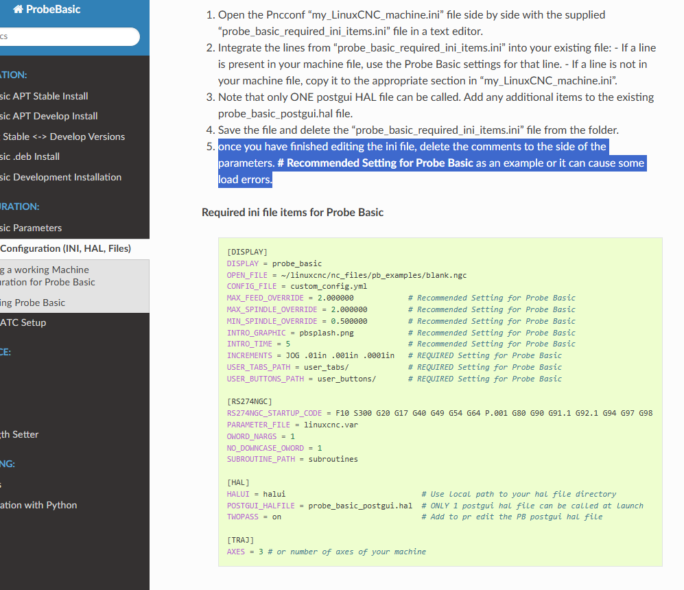

17 May 2025 20:33 #328656
by Doc_emmet
Replied by Doc_emmet on topic Install Probe Basic
Hello, I've finally found the error.
The problem is caused by importing entries from the "pb_required_ini_settings.ini" file.
This is the file:
[DISPLAY]
DISPLAY = probe_basic
OPEN_FILE = ~/linuxcnc/nc_files/pb_examples/blank.ngc
CONFIG_FILE = custom_config.yml
MAX_FEED_OVERRIDE = 2.000000 # Recommended Setting for Probe Basic
MAX_SPINDLE_OVERRIDE = 2.000000 # Recommended Setting for Probe Basic
MIN_SPINDLE_OVERRIDE = 0.500000 # Recommended Setting for Probe Basic
INCREMENTS = JOG .01in .001in .0001in # REQUIRED Setting for Probe Basic
USER_TABS_PATH = user_tabs/ # REQUIRED Setting for Probe Basic
USER_BUTTONS_PATH = user_buttons/ # REQUIRED Setting for Probe Basic
[RS274NGC]
RS274NGC_STARTUP_CODE = F10 S300 G20 G17 G40 G49 G54 G64 P0.001 G80 G90 G91.1 G92.1 G94 G97 G98
PARAMETER_FILE = probe_basic.var
OWORD_NARGS = 1
NO_DOWNCASE_OWORD = 1
SUBROUTINE_PATH = subroutines
[HAL]
POSTGUI_HALFILE = probe_basic_postgui.hal
TWOPASS = on
And here's the error: USER_TABS_PATH = user_tabs/ # REQUIRED Setting for Probe Basic
There must be no comments after USER_TABS_PATH = user_tabs/, no "#" because that causes the error!!!
This is the file:
[DISPLAY]
[RS274NGC]
OWORD_NARGS = 1
[HAL]
TWOPASS = on
