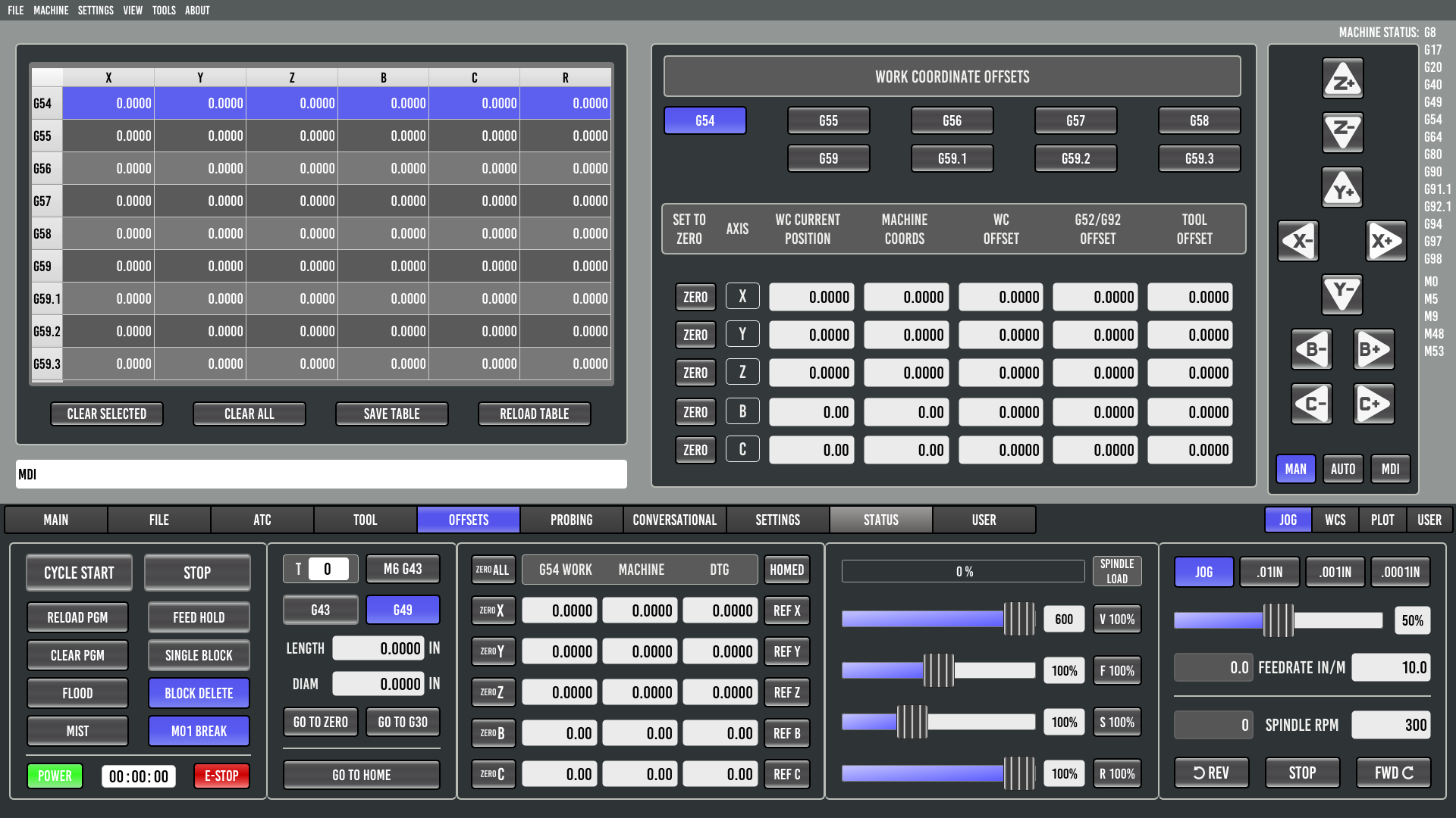

- Lcvette
- Posts: 1634
- Thank you received: 763
21 May 2025 20:55 #328876
by Lcvette
Replied by Lcvette on topic Activate B-axis in Porbe Basic
almost forgot about the job buttons, those are now also dynamically set to display the new options for xyzbc as well as the offsets page ui bits as can be seen in the image below.
just waiting on a tester and need to update the docs once everything tests out and I will push the update out to the apt develop version of PB for install and updating.
