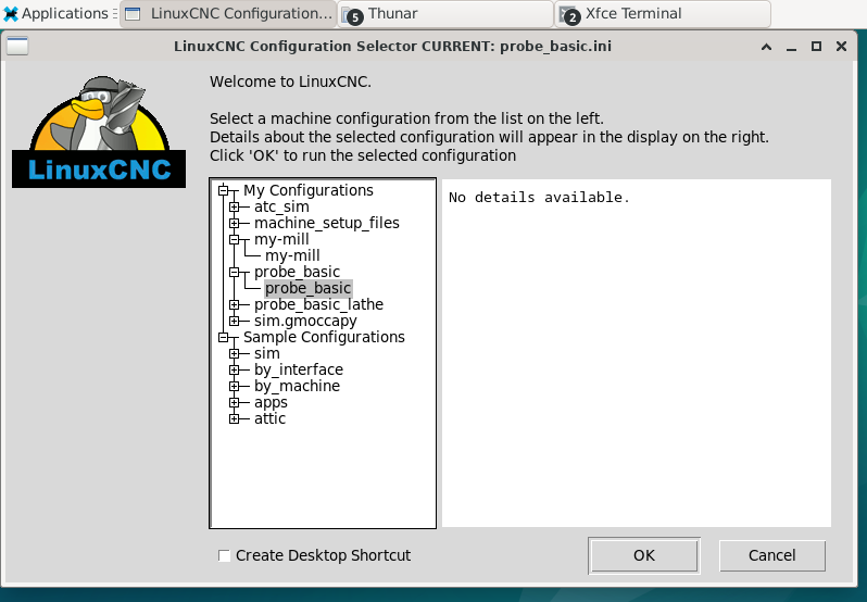

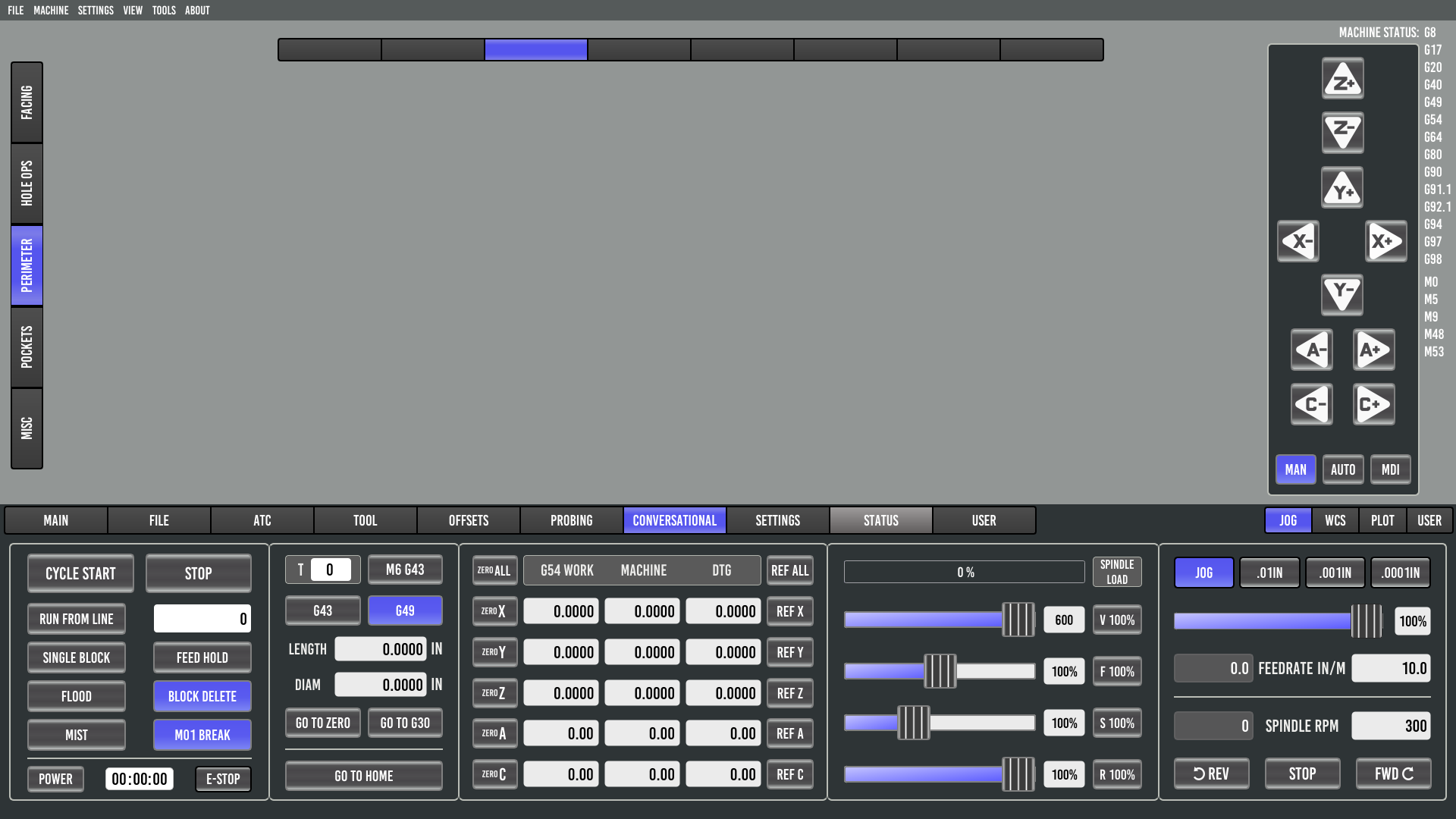

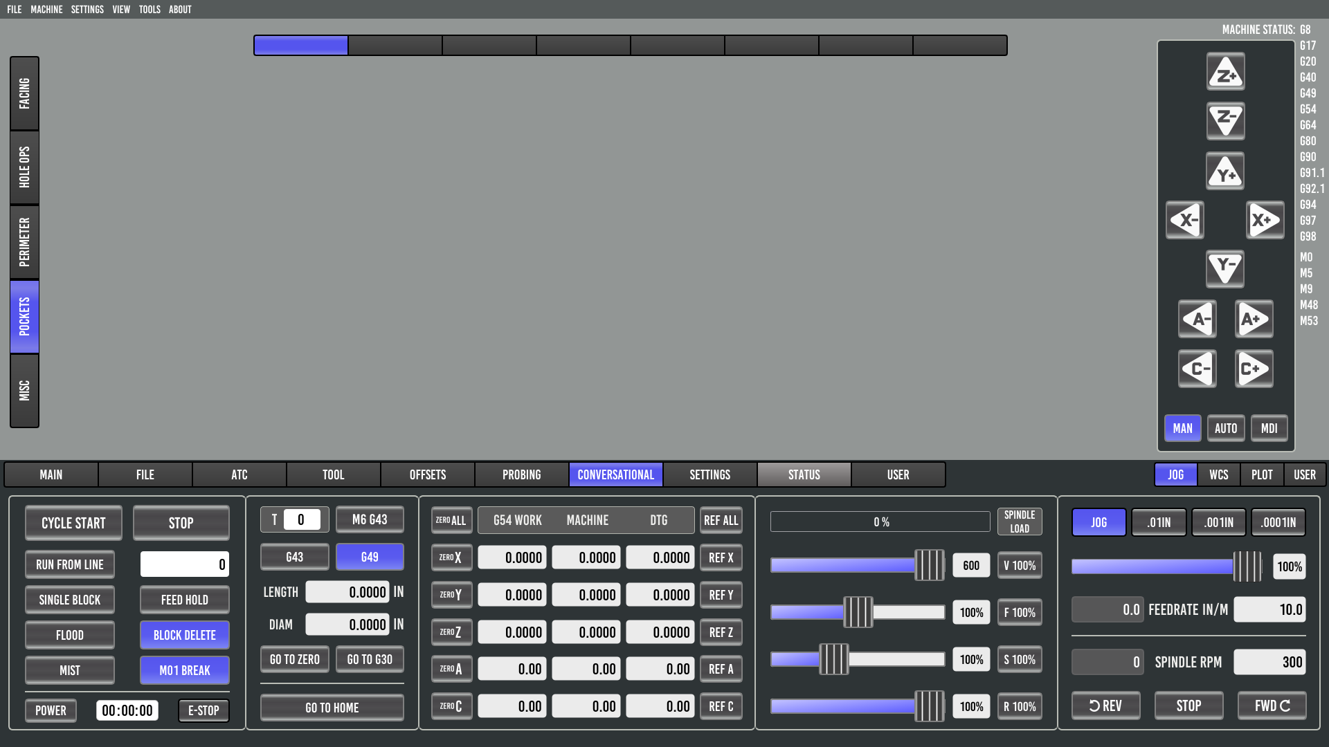

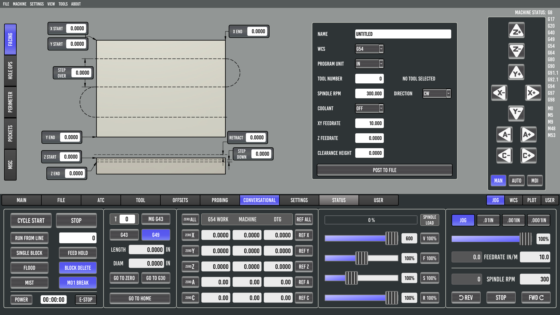

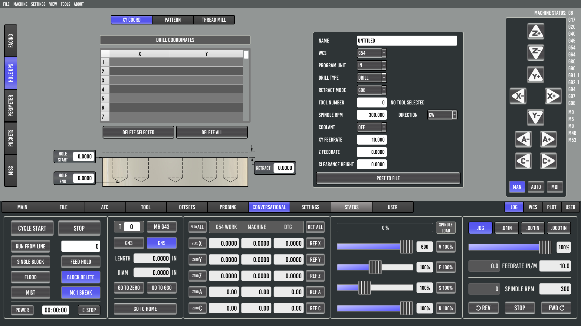

Hi all,I noticed that SOME conversational macros ( pocketing, Frame etc.) are currently missing from my install from last night? What key detail am I missing? I was under the impression they were part of the build? Im new to this and testing the software on my PC.
See pics
other than that, looks great!
Followed this install link kcjengr.github.io/probe_basic/quick_start.html
See pics
- Lcvette
- Posts: 1653
- Thank you received: 775
25 Jun 2025 14:00 #330862
by Lcvette
Replied by Lcvette on topic probe basic conversational macros missing?
they haven't been completed.
