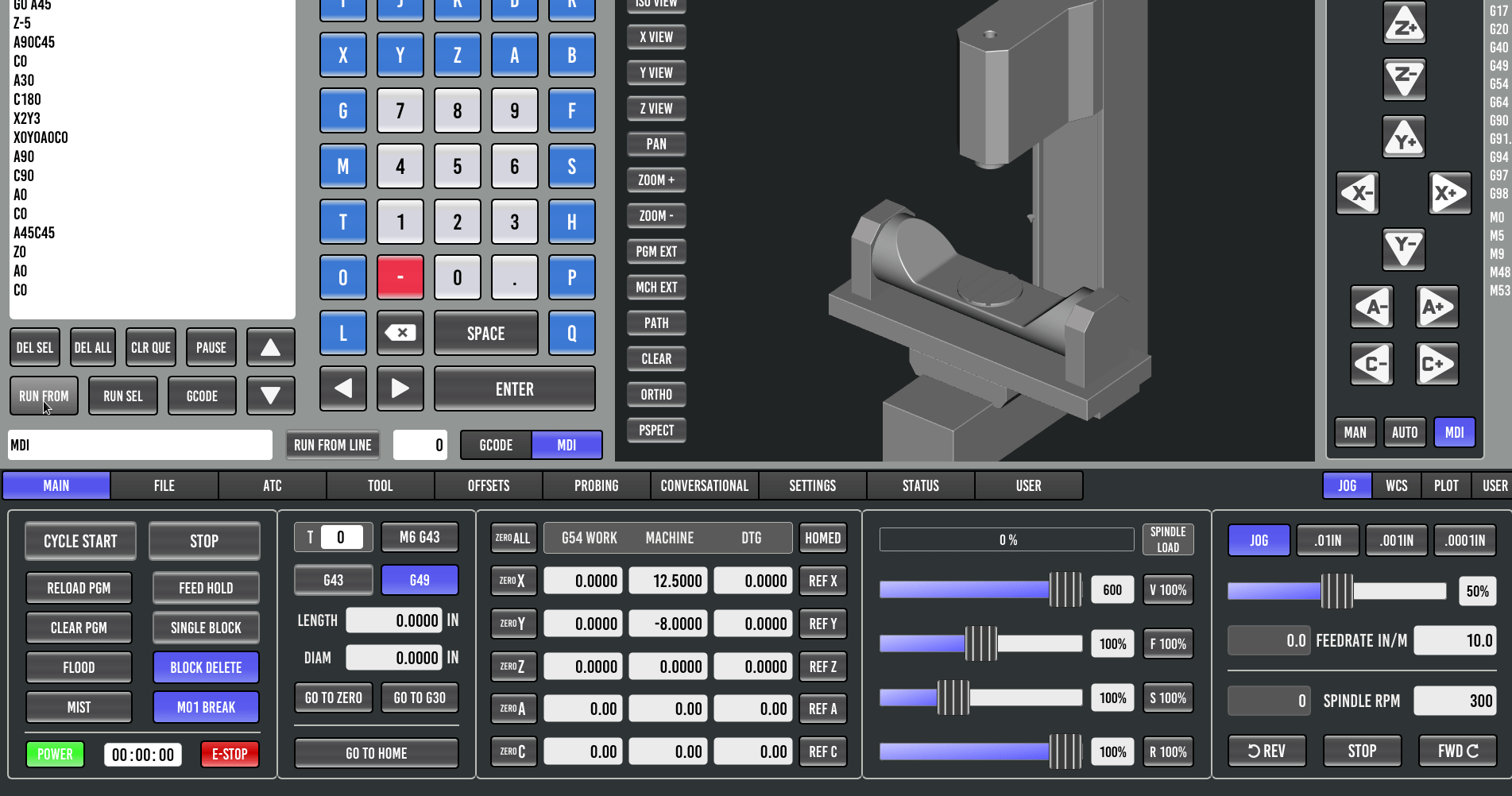

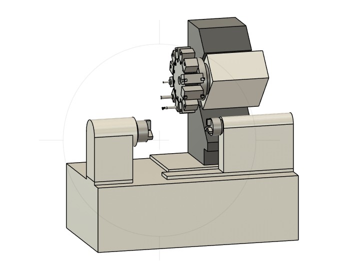

I found my self in a situation where i could end up getting sucked into the lathe department at work and had an idea to build some kind of test simulation for testing macro programs and testing of programs in general. So i thought it would be neat if i could create some kind of virtual machine for this. i have never tried anything like this in the past so who knows how far i can push the limits with what is able to be done with the tools we have here to work with? Being a mill guy for the most part and looking at lathes with a main and sub spindle with XYZ with a 4th linear axis on the sub spindle for part transfers and phase snyc on both spindles with some of these lathes having a second turret on top of this kinds makes you take a step or two back to get your ducks in a row when your in a situation where there is no one to ask questions because the last guy that knew these machines ends up retiring. So that's basically how this project came to light
what i have managed to do so far is get all 3 of these programs to play nice together open up and render my model and create a 3D orbital view with a zoom feature with a custom viewer so far. i almost gave up on this project quite a few times but got things working this past weekend. i am not just getting into the custom UI with designer which i am just now starting to understand a little bit.
added a screen shot of the model to give you and idea of what is being worked on this is by no means final or even close to being done. i had no idea what i was getting myself into when i started this and thought it would not be to much trouble until i started and that went out the window pretty quickly once i dove into it

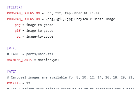

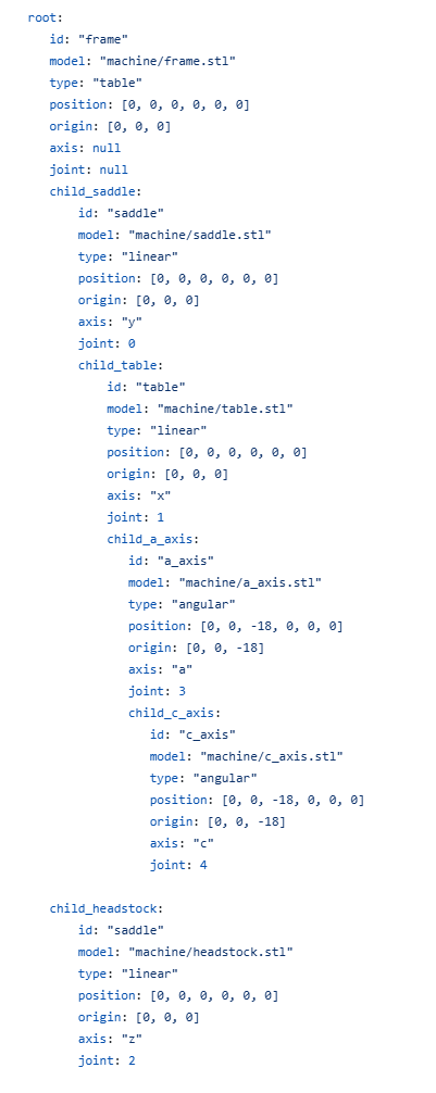

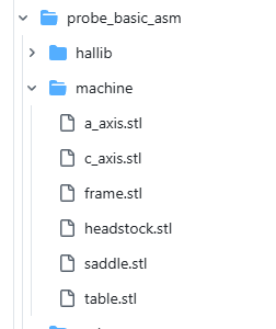

14 Aug 2025 15:00 #333418
by Lcvette
Replied by Lcvette on topic QTPYVCP+VISMACH+LINUXCNC ROLLED INTO ONE?
this has already been implemented in qtpyvcp and does not require vismach. the model can be setup to be shown and run in main vtk ui backplotter natively and respond to gcode and subroutines etc. and is quite easy to setup.
some examples below of things already done. to setup once you have your stl/step file components, to do this follow the below steps:
step 1: add new folder to your machine config directory, name is "machine"
step 2: add your stl or step files to the "machine" folder
step 3: create a yaml file, can use the below example as a template, to set the base component and orient and configure each component relation in space, and assign an axis for motion.
step 4: add a setting in the ini file for [VTK] to activate simulation by loading the new yaml file on startup.
Have fun!
Chris
Have fun!
Chris

14 Aug 2025 16:13 #333427
by machinedude
Replied by machinedude on topic QTPYVCP+VISMACH+LINUXCNC ROLLED INTO ONE?
i have options for sim at work with different cam packages but one of the things i noticed right out of the gate once i started looking at the lathe controllers is lack of memory on the controllers since these lathes are maybe 15 years old with the exception one he new one that was just bought. the problem with cam if your trying to do something with live tooling without the Y axis the program size just gets way to big pretty fast. so macro programs seem like a good solution to keep the program sizes in check. Gibs cam might have something for macro's but i don't use it very much. i'm mostly interested in something to test lean programs with and maybe add some quick code for small run jobs for protype work we seem to get a good bit of that with the production work.
