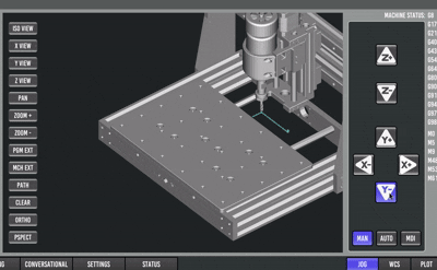

- amanker
- Posts: 119
27 Feb 2026 14:31 #343598
by amanker
As per your instructions I have made vismach file for my small cnc.But CNC movement if GUI is correct. But Tool movement in Y direction is wrong.My yaml file.
Replied by amanker on topic QTPYVCP+VISMACH+LINUXCNC ROLLED INTO ONE?
- Lcvette
- Posts: 1679
- Thank you received: 782
27 Feb 2026 14:59 #343600
by Lcvette
Replied by Lcvette on topic QTPYVCP+VISMACH+LINUXCNC ROLLED INTO ONE?
its not wrong, which direction is the "TOOL" moving through the work?
- Posts: 4810
- Thank you received: 2163
27 Feb 2026 15:28 #343602
Replied by Aciera on topic QTPYVCP+VISMACH+LINUXCNC ROLLED INTO ONE?
The problem is that the backplot needs to move with the table.
- amanker
- Posts: 119
27 Feb 2026 15:34 #343603
by amanker
How can I resolve this?
- amanker
- Posts: 119
27 Feb 2026 15:38 #343604
by amanker
See GIF file I have uploaded. The tool marker from view port is moving in opposite direction. I want it should be below spindle tooltip. As it moves while jogging in X or Z direction. But Y jogging time, table is moving correctly. But tool marker is moving in opposite direction.
- Posts: 4810
27 Feb 2026 16:14 #343609
The tool path needs to be plotted relative to the work piece. (tool -> world -> work)
The problem is that your tool position is plotted in World coordinates (tool -> world) which works if only the tool moves because the Work coordinate system remains identical to the World coordinates.
However on a machine like yours where the tool AND the work move in space the plotter needs to track both the tool tip as well as the work piece.
This is why the 'vismach' tool needs the capture() function for the tooltip as well as for work.
Not sure but maybe the backplot in ProbeBasic only plots tool position in world coordinates instead of plotting tool position in Work coordinates?
