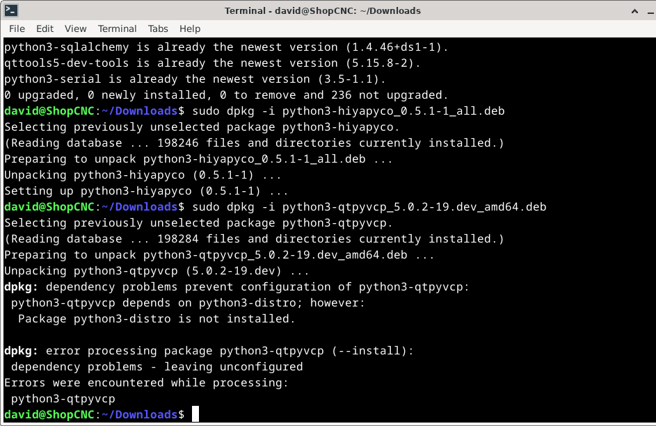

I get an error when I run the third command 'sudo dpkg -i python3-qtpyvcp_5.0.2-19.dev_amd64.deb'

Replied by tommylight on topic New Probe Basic install - error during install.
Try
Run install again.
Code:
sudo apt update
then
sudo apt install python3-distro

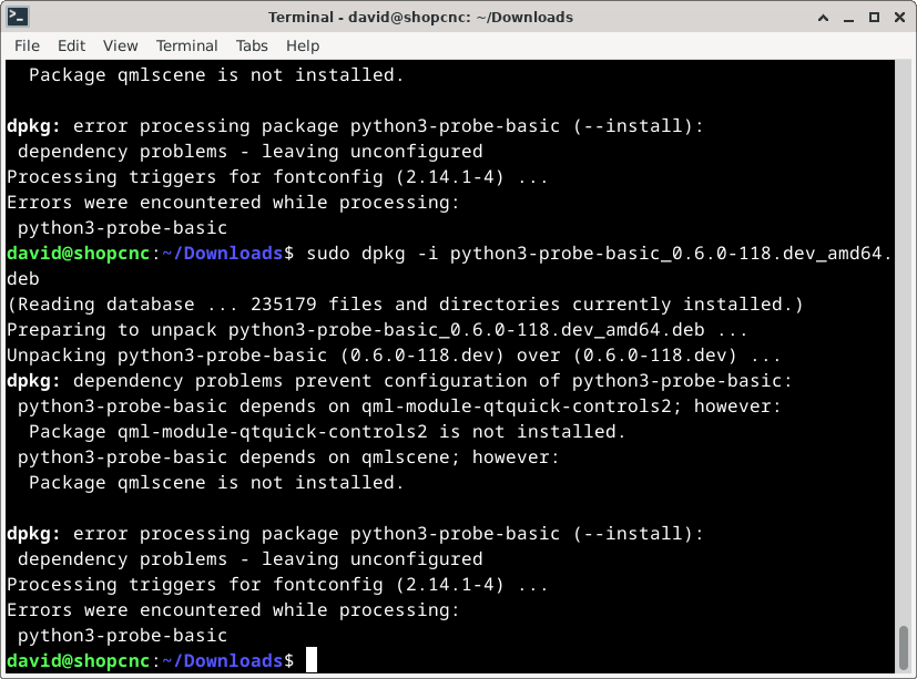

Well I tried again with a fresh LCNC install and I got almost all the way through the Probe Basic install.
Got this error on the last installation command: sudo dpkg -i python3-probe-basic_0.6.0-118.dev_amd64.deb

1 year 2 weeks ago - 1 year 2 weeks ago #336714
by Lcvette
Replied by Lcvette on topic New Probe Basic install - error during install.
When you see errors like the missing dependency shown in the top line of your screen shot, those are what stop the installation from proceeding. While installing, if you encounter those, you can auto install them by running:
sudo apt --fix-broken install
which will gather all of the missing dependencies on your system and install them.
