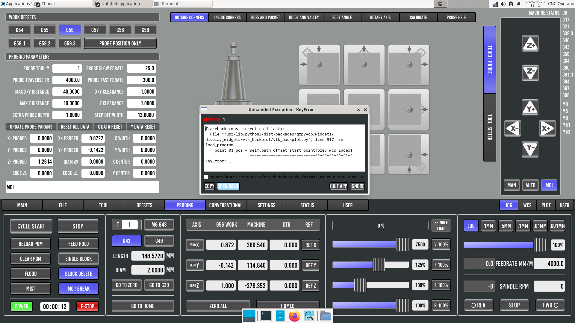

It's been a long time since I found any bugs in Probe Basic but this morning I came across a backplot error.
To trigger this bug I loaded the attached g-code file and probed 3 work offsets using the built in probing functionality (G54, G55, G56).
As soon as I probed the final offset G56 I got the first error below.
I pressed the ignore button but after that the GUI became partially unresponsive and for example the jog buttons would not work.
Pressing the stop button on the machine gave me the following error.
I did some further testing and discovered that if I do the probing first and then open the file I get the same error. However if I do the probing, close Probe Basic and then start it again and open the file I get no error but on the other hand this forces me to rehome the machine which is not optimal from an accuracy perspective.
Seems like the probing routine somehow causes the backplot to crash or leave a bade state somewhere. I tired poking around in the code myself but I'm too inexperienced to put my finger on the exact cause.
If you need any information don't hesitate to contact me here on the forums or via e-mail (This email address is being protected from spambots. You need JavaScript enabled to view it.).

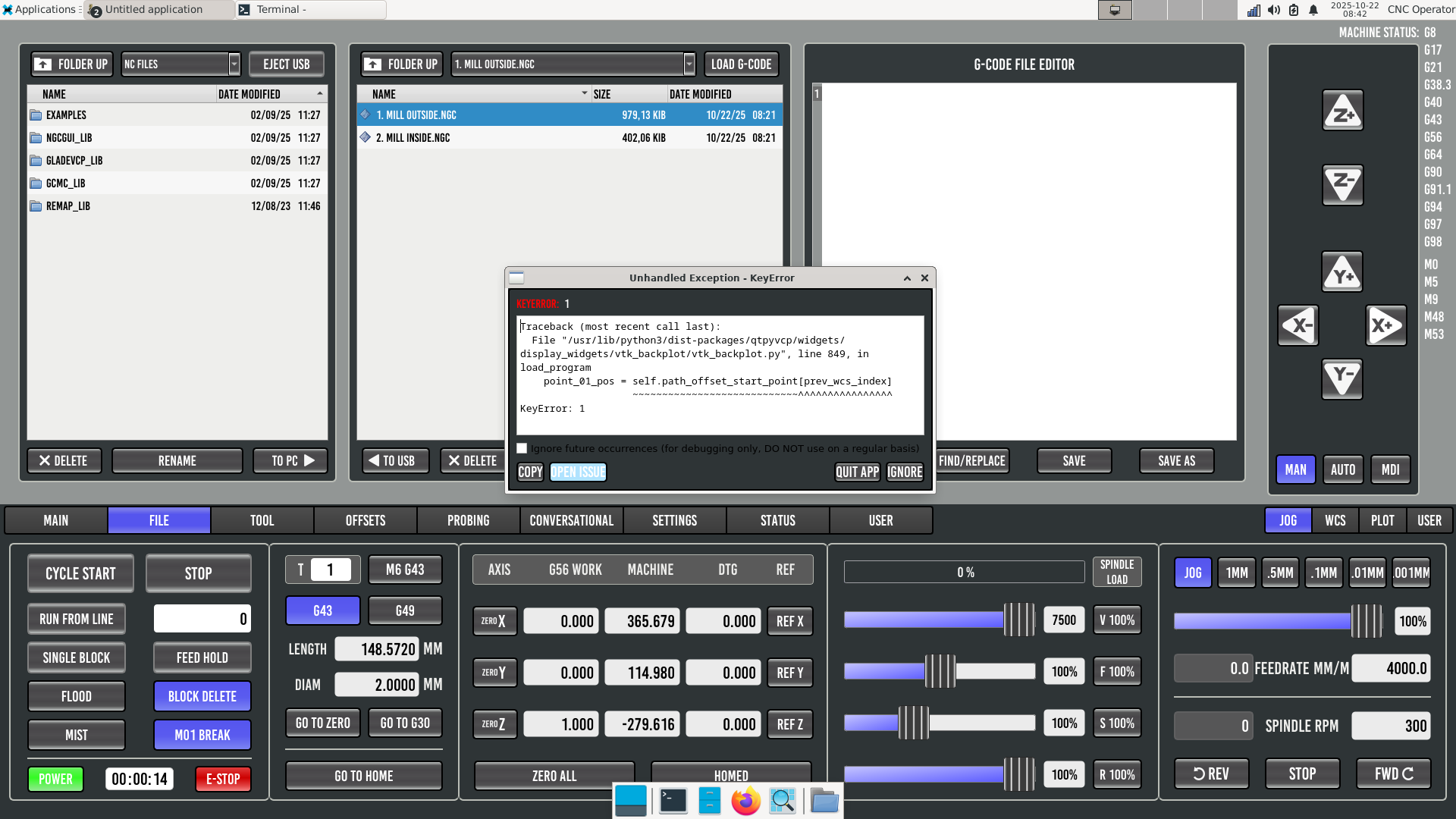

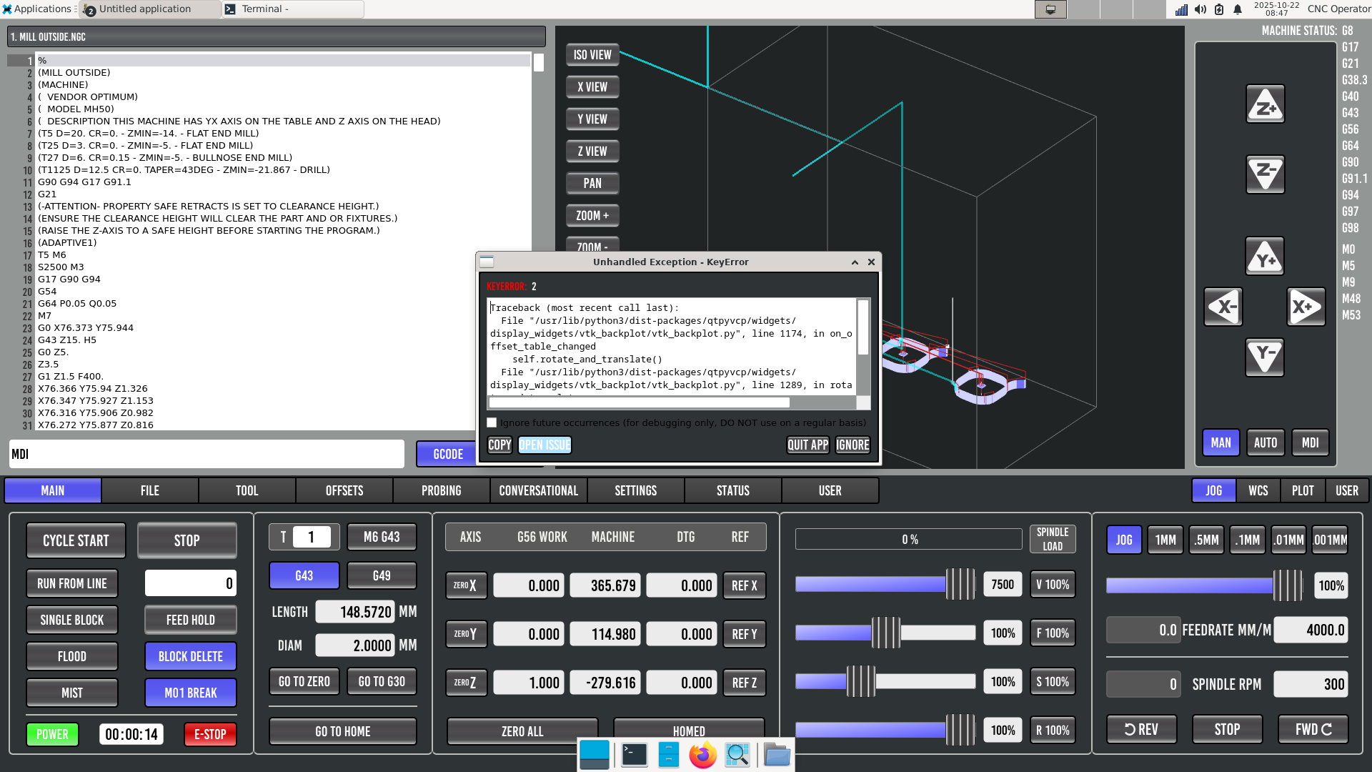

Noticed that the code tags in the editor completely mangled the stack traces, here they are in a more readable form.
Error 1:
[qtpyvcp.widgets.input_widgets.gcode_text_edit][INFO] File encoding: ascii (gcode_text_edit.py:538)
[qtpyvcp.widgets.display_widgets.vtk_backplot.vtk_backplot][INFO]
Draw time 1.4562861919403076 seconds --- (vtk_backplot.py:762)
[qtpyvcp.app.launcher][CRITICAL] Unhandled exception in vtk_backplot.py line 849 (launcher.py:37)
File "/usr/lib/python3/dist-packages/qtpyvcp/widgets/display_widgets/vtk_backplot/vtk_backplot.py", line 849, in load_program
point_01_pos = self.path_offset_start_point[prev_wcs_index]
KeyError: 1
Error 2:
qt.qpa.xcb: QXcbConnection: XCB error: 3 (BadWindow), sequence: 7081, resource id: 8480708, major code: 40 (TranslateCoords), minor code: 0
[qtpyvcp.app.launcher][CRITICAL] Unhandled exception in vtk_backplot.py line 1174 (launcher.py:37)
File "/usr/lib/python3/dist-packages/qtpyvcp/widgets/display_widgets/vtk_backplot/vtk_backplot.py", line 1174, in on_offset_table_changed
self.rotate_and_translate()
File "/usr/lib/python3/dist-packages/qtpyvcp/widgets/display_widgets/vtk_backplot/vtk_backplot.py", line 1289, in rotate_and_translate
self.offset_change_start_actor[wcs_index].SetUserTransform(actor_transform)
KeyError: 2

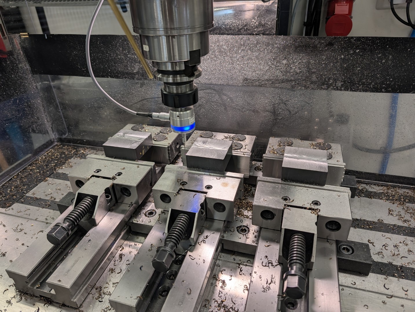

This is the setup I'm probing.
I've tried probing the parts in different order etc but as soon as G56 finishes probing the error pop up. Now in the development version pressing the stop button after the error has appeared doesn't do anything instead the GUI mostly frozen for any user input however it still updates if I use my physical button for e-stop etc.
Could there be a typo somewhere relating to G56?

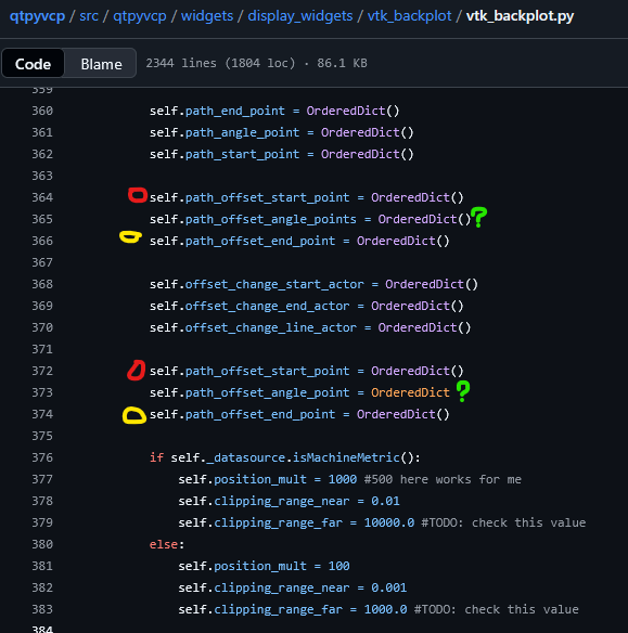

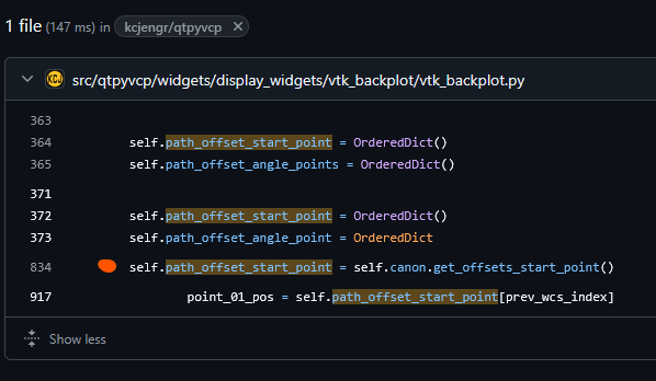

I started looking into to this and while I haven't been able to pinpoint the cause yet I found these lines of code in vtk_backplot.py
The lines highlighted red and yellow seem to be duplicates of each other and the ones marked green don't seem to be used anywhere.
Digging a bit further it seems that the path_offset_start_point dictionary where the KeyError comes from only gets written to in one location (marked orange below).
So I assume that the dictonary is supposed to be populated with values via the VTKCanon class.
