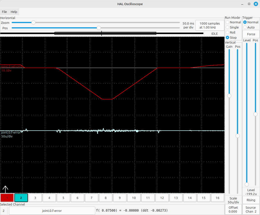

Are you dropping packets? that is, what is:
hm2_7i76e.0.packet-error-total
A dropped packet will result in a (bogus) following error spike,
as stale stepgen position (from the previous cycle) will be compared
with the commanded position. At a 2 ms servo thread period and 125 mm/sec
velocity, a .25 mm reported following error value is possible from a dropped
packet. Note the this does not mean that there is an actual path deviation
of this magnitude, this is bounded by the max_error PID pin to ~.0127 mm
per dropped packet.
I still think the physical error is most likely mechanical as it only shows up on Y.
To diagnose stepgen errors, the best thing is to plot the following error
with halscope like this:
Note that this is in inches, but the velocity and acceleration are about 4x and 6X your machines values
and the inherent stepgen error is less than 0.25 micron.
Another possibility if the system latency is really bad, is loss of DPLL sync, so you might try increasing
the DPLL time from -250 to -500 usec

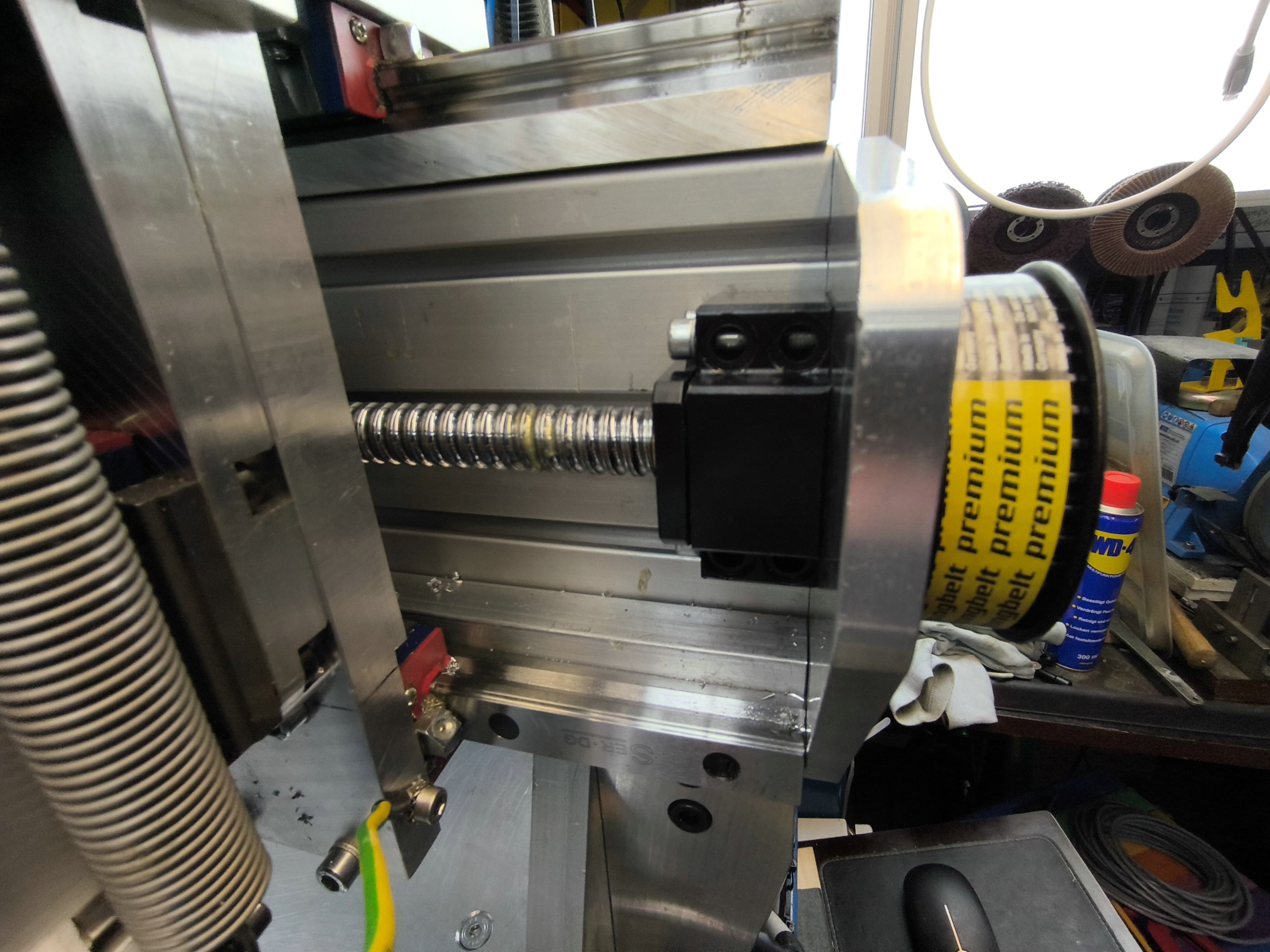

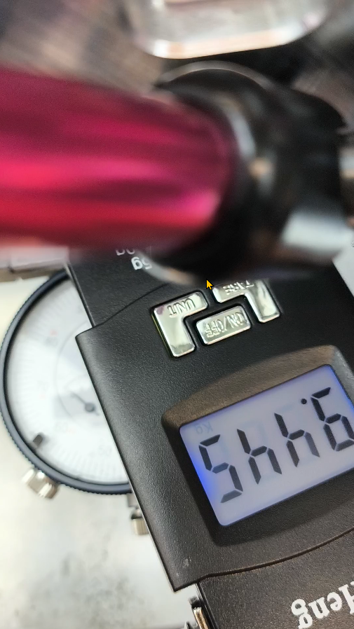

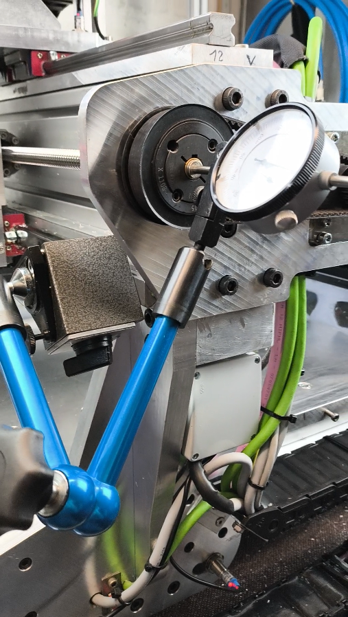

Maybe you remember, that I have had that latency problem posted somewhere this year and had it solved. But, I will follow your advice and go through this process agein, tomorrow. I did never do that diagnosis with HALscope but I will do this, too.
Yes, my thoughts up to yesterday was mechanical fault but the measurements today say no. These hundreds that I found are totally acceptable for me, but the tenths not. I really don't know where these deviations come from. Maybe I check the latency again, and take a look at Halscope, and got to all screws that fix the Z axis.
BTW _ I made measurements at the milling spindle head with a spring scale: I got 1/10 in Y direction at 10 kg, 2/10th in X direction at 10kg, so this is way under my deviations at the milled part.
I will report my findings, thanks for your hints again!

I'm sorry to say that I have to pause my efforts on this chapter with elliptical faults. As I tried yesterday to get new corrected lines in my Hal and INI to try out what helps (the day before yesterday, I tried to change the Y axis to stepgen.03 what did'nt work, I did'nt change wires but changed the plugs from stepgen.01 to stepgen.03) and I found that stepgen.01 was dead. I changed then stepgen.01 to stepgen.02 and motor-01 was working correctly.
So, I have to send my MESA card to a friend to repair the burned stepgen chip, this will last several days.
Meanwhile, I will consider if I could change to my free 7i96S, the problem there will be spindle settings and several other things to adapt.
