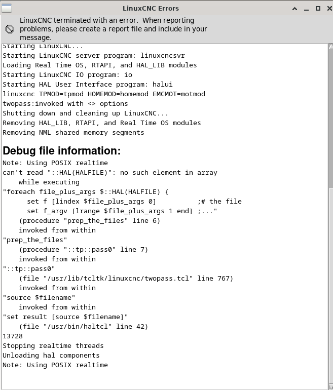

Maybe i almost got it. Now i have this error -> see picture

06 Feb 2026 20:05 #342565
by Lcvette
Replied by Lcvette on topic Probe Basic many error messages at first start -> Newbie
use bookworm per the docs

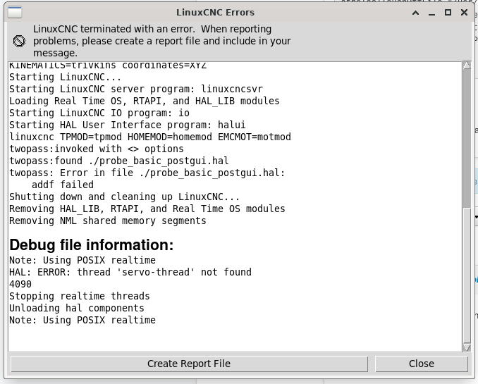

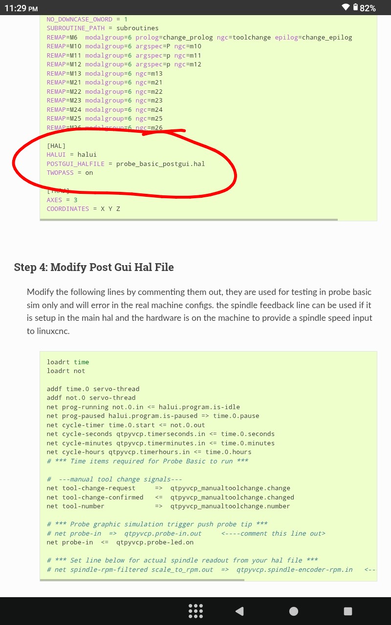

That makes sense... today i did a new clean install using Debian 12 Bookworm and Linuxcnc 2.9.0~pre1+git20230208.f1270d6ed7
Still get some errors -> attached picture
kcjengr.github.io/probe_basic/machine_config.html

09 Feb 2026 16:30 - 09 Feb 2026 16:39 #342718
by DerKlotz
Replied by DerKlotz on topic Probe Basic many error messages at first start -> Newbie
After days this is my system now Linux version 6.1.0-42-rt-amd64 (This email address is being protected from spambots. You need JavaScript enabled to view it.) (gcc-12 (Debian 12.2.0-14 deb12u1) 12.2.0, GNU ld (GNU Binutils for Debian) 2.40), Linuxcnc 2.9.8 and Python 3.11.2
The Probe_Basic GUI starts but i still have errors -> see attached files

11 Feb 2026 04:23 #342792
by Lcvette
Follow the docs exactly and you will have no errors..
This is telling you your error
"raise IOError('The specified POSTGUI_HALFILE does not exist: %s' %
OSError: The specified POSTGUI_HALFILE does not exist: /home/cnc/linuxcnc/configs/Fräse_Probe/custom_postgui.hal
1550"
Remove it from your ini hal section call. You can only have one post gui hal file and it must be the supplied probe basic postgui halfile
1550"

11 Feb 2026 04:34 - 11 Feb 2026 04:36 #342794
by Lcvette
Run the simulator to ensure your installation is good, if so, compare its configuration files to your machine config. You'll be able to find where your errors are coming from between that and the docs

11 Feb 2026 09:21 #342799
by DerKlotz
Yes that was my problem... thanks a lot!!!
