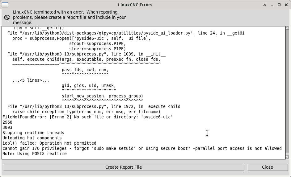

hello everyone:
I was installed the debian13+linuxcnc2.9.8 ISO image from linuxcnc.org. and installed qtpyvcp and probe basic used method below:
kcjengr.github.io/probe_basic/debian_13_...develop_install.html
but, it can't start
Thank you
Tim

I found this:
forum.linuxcnc.org/qtpyvcp/58735-probe-b...ing-no-tool-selected
and installed pyside-tools package, it's work! thanks.
Tim
