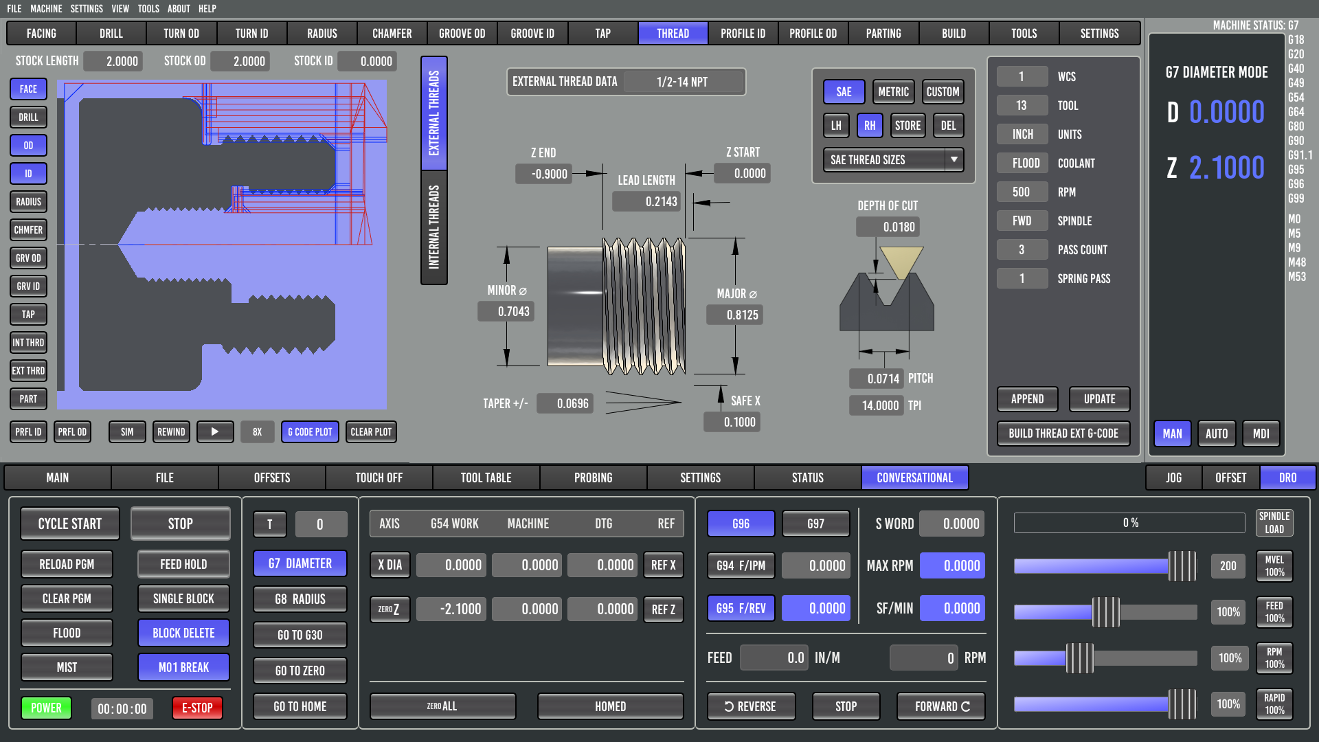

@spumco:
In order to have a parts counter as a standard offering, I would think everything would need to be wired up to something, adding something like this in one of the user tabs seems like it would be the best fit. maybe add them on the nice big blank sidebar user tab or along with the large DRO's on the side for X and Z. I am not sure if linuxcnc has some form of build in part counter logic somewhere or not as i have not run across it, but you could use a simple macro call from gcode to add a count to a widget in the usertab for each time the macro gets triggered, this would be super simple to do and would not be something that got overwritten during updates if done in user tabs.that was the entire point of having those. there is already lots of real estate under the large sidebar DRO's as seen in the picture:

- anfänger
- Posts: 648
- Thank you received: 270
11 Oct 2026 07:24 - 12 Oct 2026 08:34 #350193
by anfänger
Replied by anfänger on topic calling all probe basic lathe users!
I was gone for three years or so, cause I was moving house and shop.
I really fired um my lathe yesterday for the first time and updated to late latest version.
Great job guys and a big thank you to all who ware woking on the project, remembering how everything started this was smooth!
Just some things from my side to consider with the changes in the INI.
But it seems to run now and the conventional cycles are great now.
There are two thing I am missing.
One is, I would love to have a Hal pin for the jog increments to use fron the GUI. I have a user tab now for that, but I could use the space for some other stuff.
And a safety zone before the spindle. to not crash into the chuck, but to be able to also machine without one.
Kind of a tool table but for lathe chucks. then one also could set a limit to the RPM depending on the chuck.
At the moment I need to edit my ini for that.
But maybe there is already a solution for that. besides ignore limits.
I guess I'll give this lathe chuck extension a try, to get back in the LinuxCNC handling. I'll open a new topic for that.

- Muzzer
- Posts: 275
- Thank you received: 49
12 Oct 2026 13:12 #350212
by Muzzer
Replied by Muzzer on topic calling all probe basic lathe users!
On my lathe running PBL I have an adjustable (sliding) limit switch that I can reposition if I change the chuck and/or use a long tool. It doesn't set the soft limits but will stop the carriage and prevent a crash.
But yes, a configurable (soft) travel limit would be very helpful, so you could set it without having to edit the ini file.
- anfänger
- Posts: 648
12 Oct 2026 20:39 #350220
by anfänger
the limits wee already on the machine and fixed.
But I solved it in a custom tab if its for anyone of interest:
forum.linuxcnc.org/qtpyvcp/59312-lathe-chuck-table#350217
