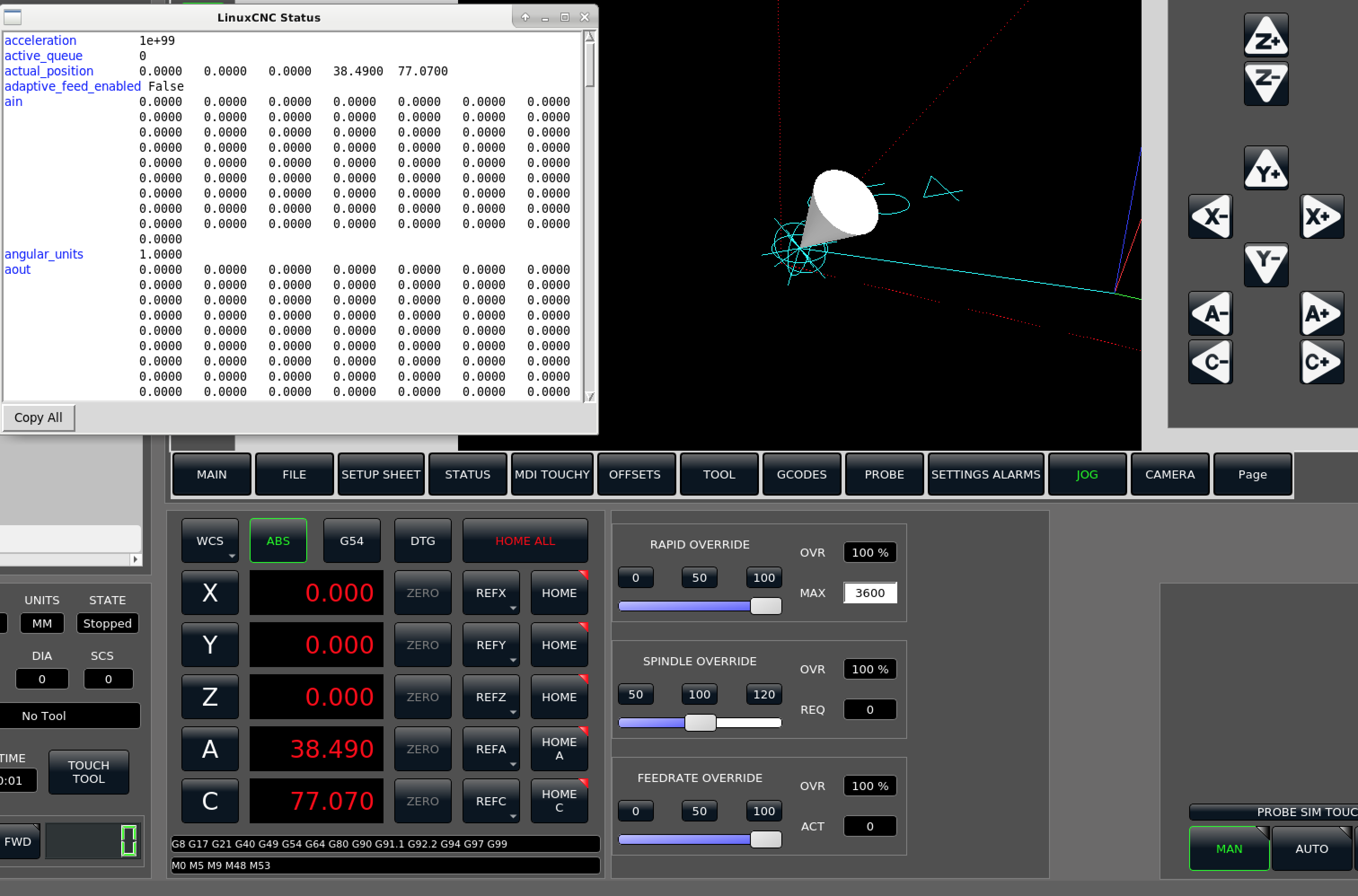

I am tinkering with the very nice Qtdragon QtVCP interface and added a 5th axis as C-axis.
That worked in principle, all good.
Then I ran into the following issue with the DRO for the C-axis only.
The C-axis is configured as JOINT_4.
If I home all axes by pressing HOME ALL, all axes are counting and homing and I can see the C-axis counting as well.
The counting is in red, as the C-axis is not homed yet.
As soon as it is homed, the C-axis DRO stops counting.
Jogging the C-axis after it is homed, does move the cone on the graphics and using LinuxCNC Status shows an actual C-axis position that changes every time the C-axis is jogged.
However, C-axis DRO stays at 0.
If I de-select ALL HOMED, so the DRO goes to red showing axes are not homed, and I jog the C-axis, the DRO is counting.
Is this a limitation in QtVCP? Looking through the code, it appears as if QtVCP is setup for 10 joints.
Added screenshot showing all axes homed and A jogged to 38.490 and C to 77.070 degrees. The cone is tilted and rotated accordingly.
DRO for C-axis shows 0 but LinuxCNC Status shows actual position.

21 Nov 2020 01:22 #189962
Replied by cmorley on topic DRO not counting for JOINT_4
This is indeed an error in qtvcp. The mapping of joints vrs axes is wrong when non consecutive axes are used.
I'll work on a fix
I'll work on a fix

21 Nov 2020 14:15 #190005
It's actually quite a difficult problem to solve satisfactory
One half work around (that works with no updates) is on the DRO widget for the C axis set Qjoint_number in designer to 5.
Then the display won't respond to unhomed jogging but will display after-homed position.
Chris
Chris

21 Nov 2020 18:25 #190016
I pushed some work on this for 2.8. (available on next update)
You still must use the axis index number for Qjoint_number in designer.
but now it converts it to a joint number for displaying when unhomed.
This isn't a perfect solution as an axis that has two joints will only have one displayed, but it works in most situations and is as about as good as I can do for a released 2.8.
If it's not adequate for a particular screen then the author would have to do a little python programming work in the handler file.
I'll have to think hard how to fix this better in master.
Chris

22 Nov 2020 20:42 #190093
by tommieh
Replied by tommieh on topic DRO not counting for JOINT_4
Thank you Chris. I changed the Qjoint_number to 5 and it works as suggested.
That it doesn't respond to unhomed joggging and doesn't display the counting whilst homing is ok for now.
Thanks for your help.
