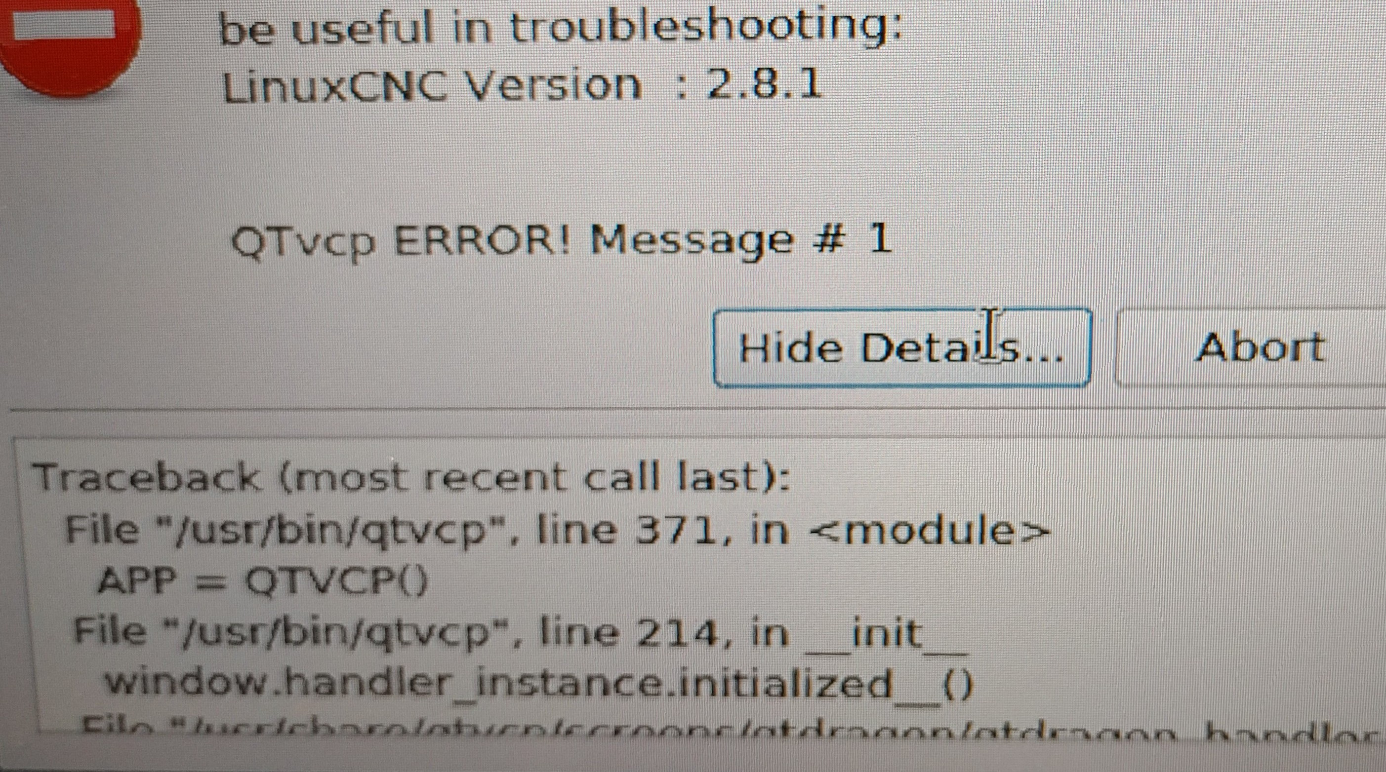

I am running QTDragon on a Debian 10 Buster RTAI load of LinuxCNC. I know that not many people are running this setup but it's been working great for me for a while and I need RTAI to get acceptable latency results on my machine.
I have been running 2.8 for about 6 months now and just recently decided to update to 2.8.1 to hopefully fix a couple issues I was having with QTDragon. After performing the update, QTDragon will no longer open (report log attached).
I have verified that the QTDragon sim works fine on the machine and I have made no changes to the system other than the update to 2.8.1. Looking at the report log, it appears that the issue may be with my lack of the resources.py file in the listed directory. I did confirm that the file does not exist anywhere that I can locate it and I am looking for some help in obtaining the correct file.

resources/py is a generated file when you run qtdragon.
Can you tell me more about your system?
Does an error dialog pop up?
can you run the system with:
DISPLAY = qtvcp -d qtdragon
and read the terminal for more clues?

An error dialog pop up does display when attempting to open. The details are copied below.
(Traceback (most recent call last):
File "/usr/bin/qtvcp", line 371, in <module>
APP = QTVCP()
File "/usr/bin/qtvcp", line 214, in __init__
window.handler_instance.initialized__()
File "/usr/share/qtvcp/screens/qtdragon/qtdragon_handler.py", line 114, in initialized__
self.init_widgets()
File "/usr/share/qtvcp/screens/qtdragon/qtdragon_handler.py", line 248, in init_widgets
self.w.lbl_tool_sensor_B2W.setText('INCH')
AttributeError: 'VCPWindow' object has no attribute 'lbl_tool_sensor_B2W')
I did try to run it with qtvcp -d qtdragon and got the below report from that. You will have to forgive my lack of experience with linux. Should i have the terminal open when doing this?
Also what system specifics would help?
Joe

When the pop up first comes up it may say that its the #2 or higher message.
we need to know the #1 error.
If the this is so press retry until you are on the #1 message hen quote the message there.

Sorry I failed to mention that. The popup dialog does state that this is error #1. Again, quoted here below.
APP = QTVCP()
self.init_widgets()

I see it now. You have a local qtdragon.ui file in your config folder that needs to be updated.
[QtDesigner.QTVCP.QT_PSTAT][[36mINFO[0m] Using LOCAL ui file from [33m/home/tacklem60/linuxcnc/configs/Dragon/qtdragon.ui[0m (qt_pstat.py:106)

You are a life saver!!! I have spent hours going down the wrong rabbit hole. I deleted my local copy of the .ui file and everything works flawlessly! Makes complete sense now too because the whole reason I wanted to do the update was to fix some usability issues with the interface. I will always be in debt to people like you in this community.
