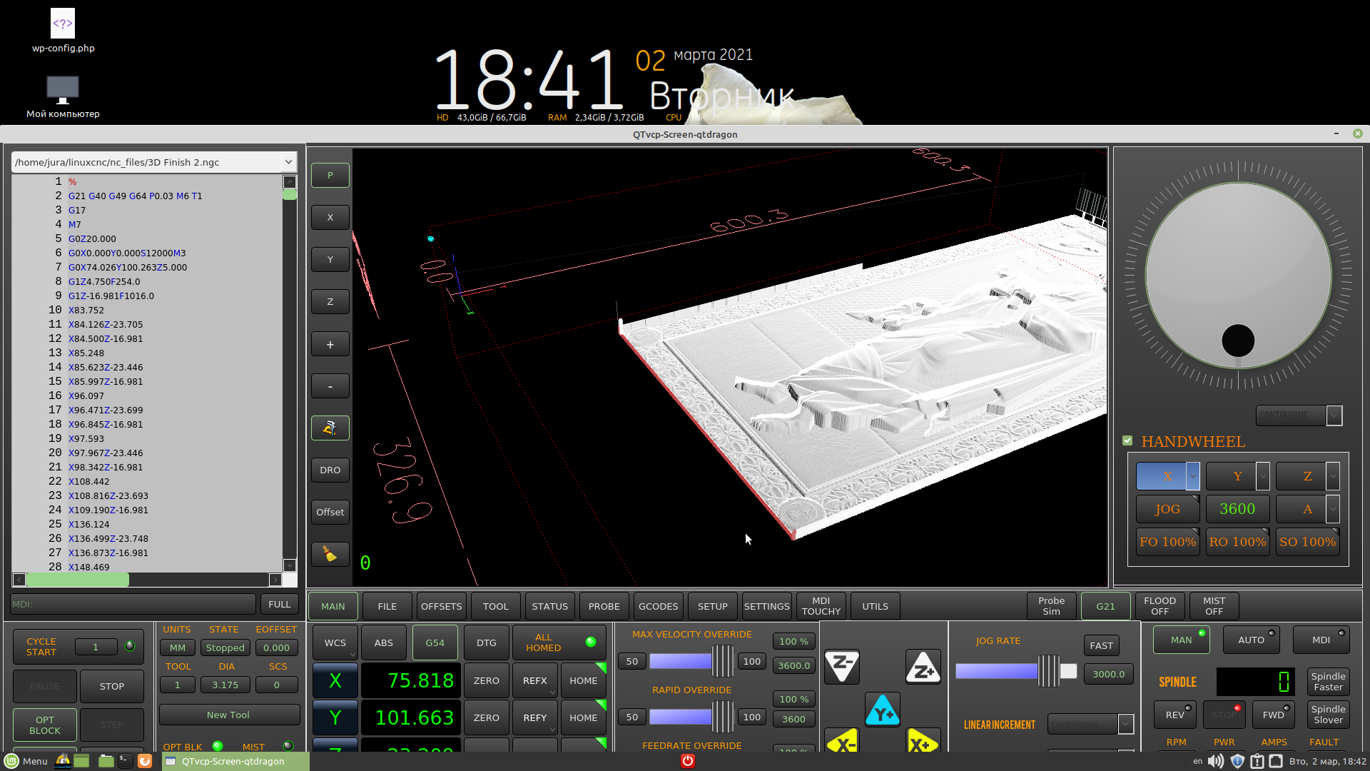

Seems like a buffer size limit on toolpath highlighting

What does a large file mean? Here is a 35Mb file, and if the buffer is not cleared, how much RAM do you need? Note how much is already taken.

Only 6000 lines on the file sent to Chris....

Did anyone ever find out how to increase buffer size?

Replied by cmorley on topic Seems like a buffer size limit on toolpath highlighting
I doubt this is a buffer size problem. The only difference between the colors is a color setting. If it was a too small memory buffer, I would expect the drawing to be corupt or disappear.
i would make a linuxcnc github bug report so it doesn't get forgotten.

Reviving my old thread.... I upgraded to latest master a few weeks ago and this problem is back. Well, at least I believe it was fixed before.... Any idea how to fix this?

I don't recall seeing any commit that sounded to be related to this, but there are dozens a week so might have forgotten or not noticed.

To my knowledge, this has been this way for ... ? I know it's the same way in pathpilot, which uses 2.8.
I think I see where this could be changed, but I need a big g-code file to play with to test.
Anyone have anything readily available?

forum.linuxcnc.org/38-general-linuxcnc-q...large-ngc-file-crash
Replied by tommylight on topic Seems like a buffer size limit on toolpath highlighting
First post, right click and choose save as:Anyone have anything readily available?[/i]
